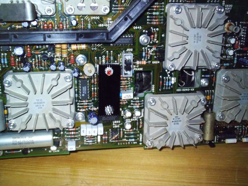

In my opinion?
2465B, the best general purposes analog Tek scope ever made.
Try to find one of these with the horizontal amplifier (155-0241-xx) made by Tek himself, the MTBF is much longer than those laterly made by Maxim.
You can also heatsink it, to keep temperature lower. Be careful to avoid short circuits, since the IC tab is not at ground potential...
If your "B" series has SMD capacitor in the control (A5) PCB, it should be better to change them, since they tend to leak an attack the board.

Ungrounded heatsink in high speed circuit, wouldn't it cause resonance ?
Not in my experience, the IC (part list 155-0241-XX) has a classical "TO220" tab but is not enought to tame temperature down.
I like "B" version, it is faster and has some nice things like automatic measures and autoset.
But among the 2400 series I have, there is even a "little" 2445 mascot: it is a nice scope too! In this case, with the "flat" series, the fan motor - the same for 465, for example - could be a little problem...
Another IC that sometimes fails, is the Channel switch (U400, or 155-0236-xx) but here I don't know hot to longer its life...
