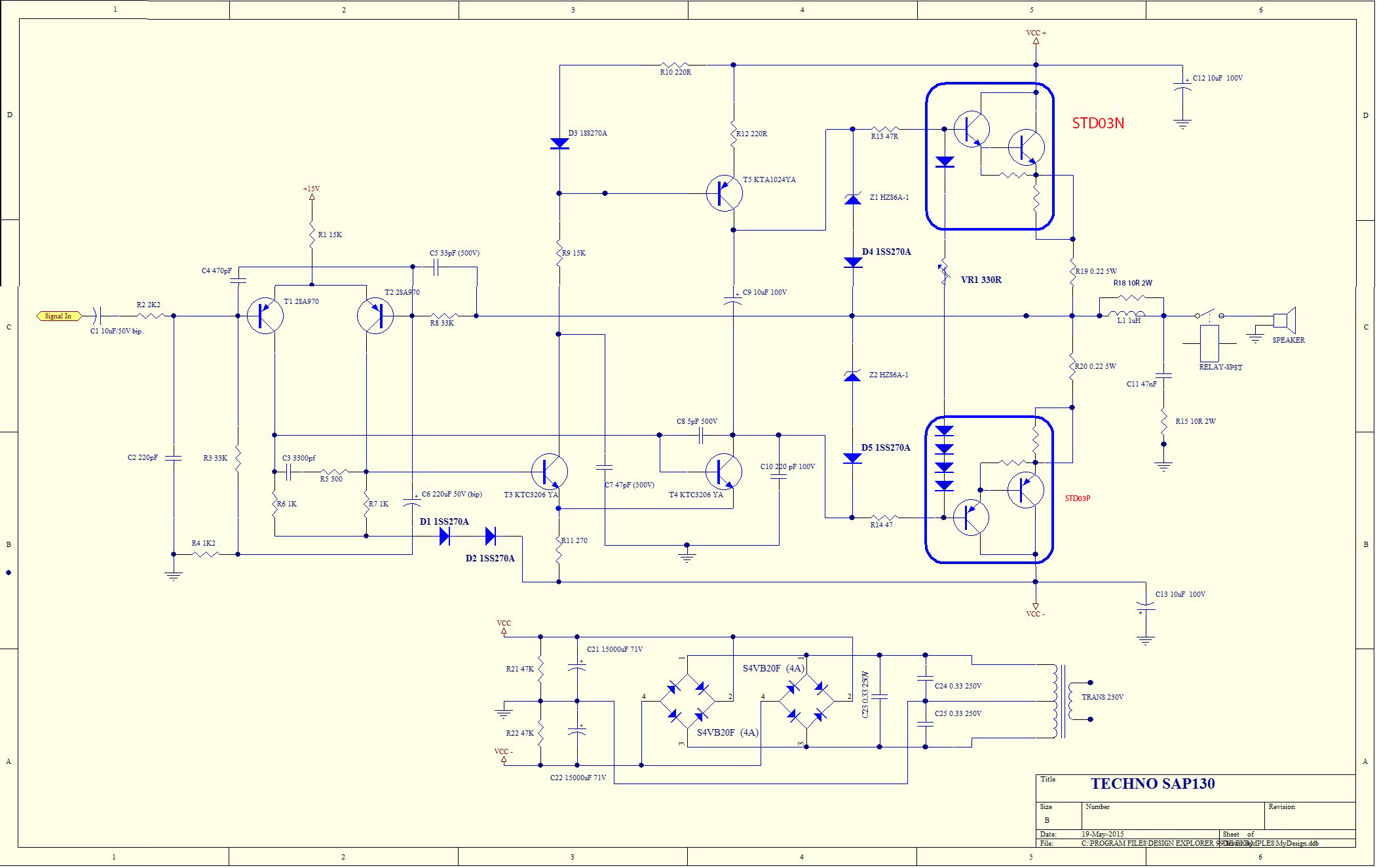

Techno SAP130 with STD03P STD03N SANKEN - Built-in temperature compensation diodes Complementary high power, high gain Darlington transistors..
130 Watt HiFI amplifier .
You can use all SANKEN - Built-in temperature compensation diodes Darlington transistors.
SAP08N Bipolar transistor Discontinued STD01N
SAP08P Bipolar transistor Discontinued STD01P
SAP09N Bipolar transistor Discontinued STD01N
SAP09P Bipolar transistor Discontinued STD01P
SAP10N Bipolar transistor Discontinued STD02N
SAP10P Bipolar transistor Discontinued STD02P
SAP15N Bipolar transistor Discontinued STD03N
SAP15P Bipolar transistor Discontinued STD03P
SAP16N Bipolar transistor Discontinued STD03N
SAP16P Bipolar transistor Discontinued STD03P
SAP17N Bipolar transistor Discontinued STD03N
SAP17P Bipolar transistor Discontinued STD03P
Have fun . 🙂
