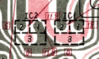

Hi, Im needing some help after a recap Ive recently completed on the Technics SL7. When I purchased it everything worked and functioned correctly.
After doing some research on this model it was common to have very leaky capacitors due to age.
So I had a peak at the pcb and it showed many capacitors with green corrosion on legs.
Work completed -
  • All electrolytic caps replaced with exact same MF though sometimes replaced with higher voltage rating
  • re flowed a few solder joints
  • De oxit all switches and plugs
I have gone back through all of the work I did and confirmed the correct polarity of caps and looked for potential solder bridges. (all looks good)
All connectors are plugged in properly
I noticed a cracked solder on the IC1 (voltage reference) after re flowing join still no power. Is it possible that this has caused damage somewhere else when powering up?
I tried plugging in the 12v outlet also and still no power
Any ideas on where to start with this issue?

Also go back over your work, and check each capacitor for proper polarity and good solder joints.
Check nearby areas on the pcb for solder splashes, etc.

Always do a few parts at a time, this way if something goes wrong you what area or parts caused it. If change out a bunch of parts this what happens, you don't where the issue is at.
Go over all the capacitors your replace with a magnifying glass to see if there is any cracked or open traces. also make sure all caps are in correct polarity.
