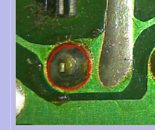

well you were right about lasting part... they are back 🙁

Lets be sure...

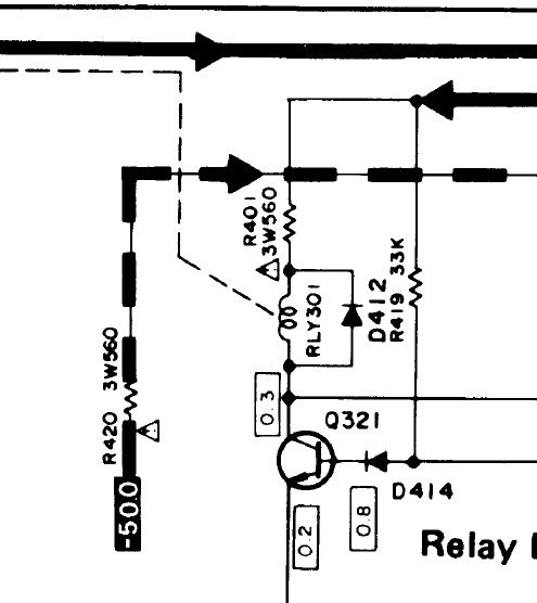

Monitor the DC voltage across D412 constantly and see what happens to it when the amp fails.
The joint highlighted is typical of one that could become a problem The solder is "crusty" around the component lead and looks to have formed an inner ring. Thats absolutely typical of a dry joint and you will almost certainly find these throughout the amp. R401 is a 3 watt resistor feeding the relay. Check the joints on it.
If the 24 volts relay drive voltage is present across D412 then you are going to have to "make" a new relay fit either by hardwiring or by drilling the PCB to accomodate a different pin spacing.

i already heated up some critical joints power transistors.. relay... inputs.. etc

You need your meter ACROSS D412. Nothing else will do 🙂
Don't measure from ground to the relay, the measurement has to be across it (which is D412)
