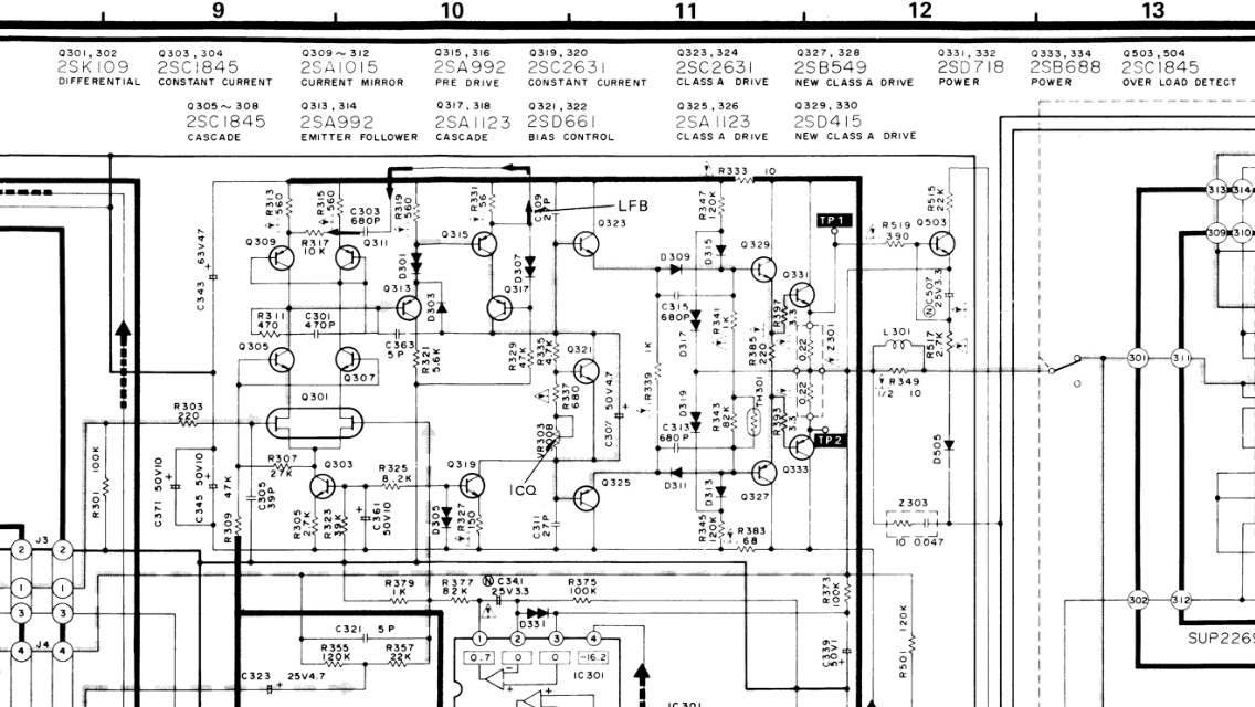

Technics SU-V3 negative voltage at output!!!
I got this amp from a friend which is already tried to repair by someone else and still have problem with one channel. Negative voltage is showing at the output stage in one channel and other channel is quite normal. I checked the output transistors and driver transistors, all shows good. When I removed the Q319(c2631) there is no negative voltage at the output. 2SC2631, 2SA1123,2SA992 and 2SK109 is not available here in local market. Only 2SA1015 and 2SC1845 is available here. Anyone know substitute for 2SC2631,2SA1123 and 2SA992? Please help !!!
