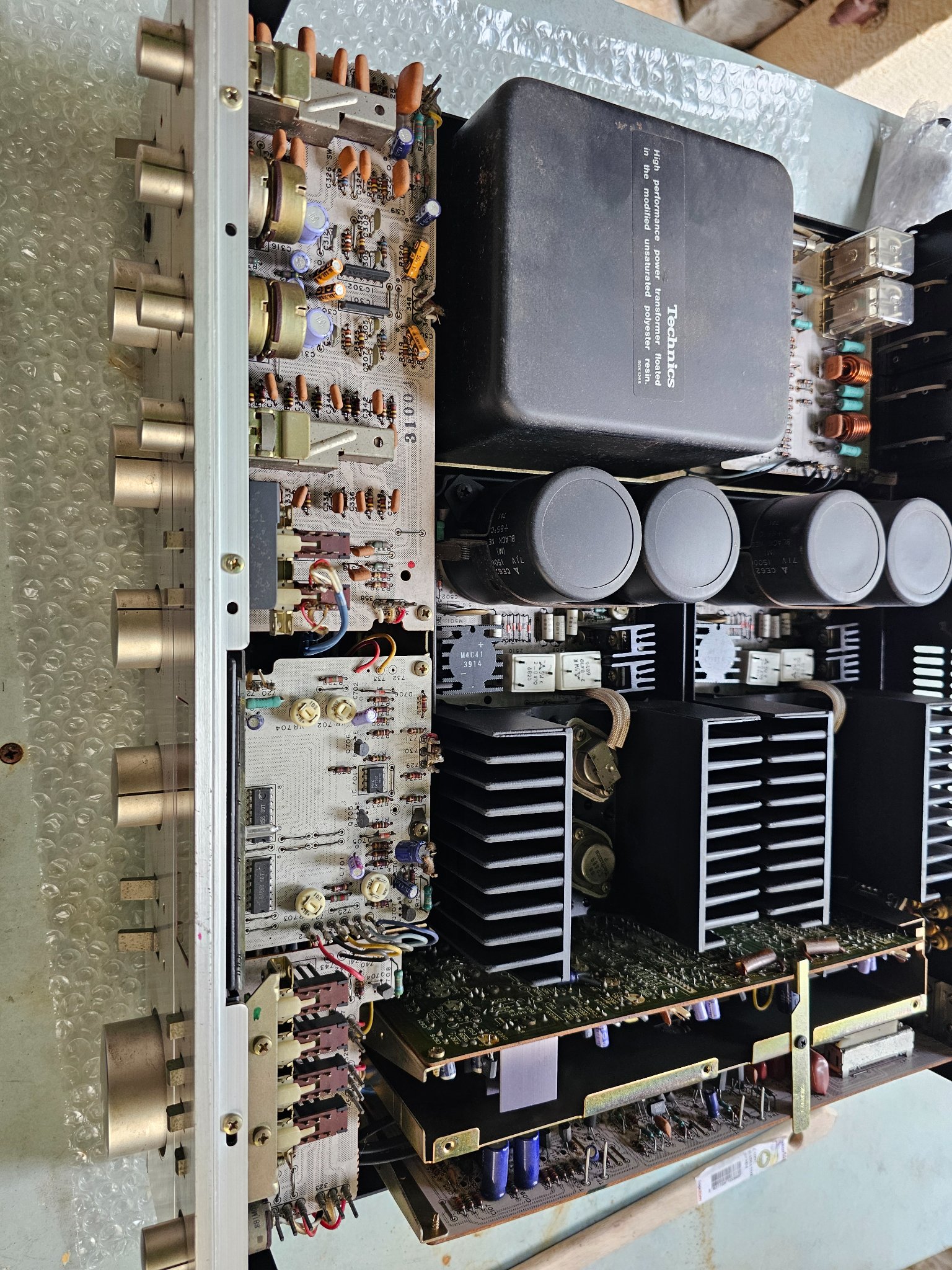

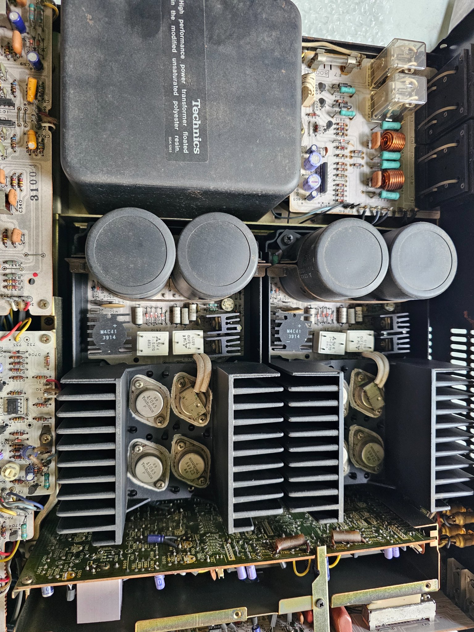

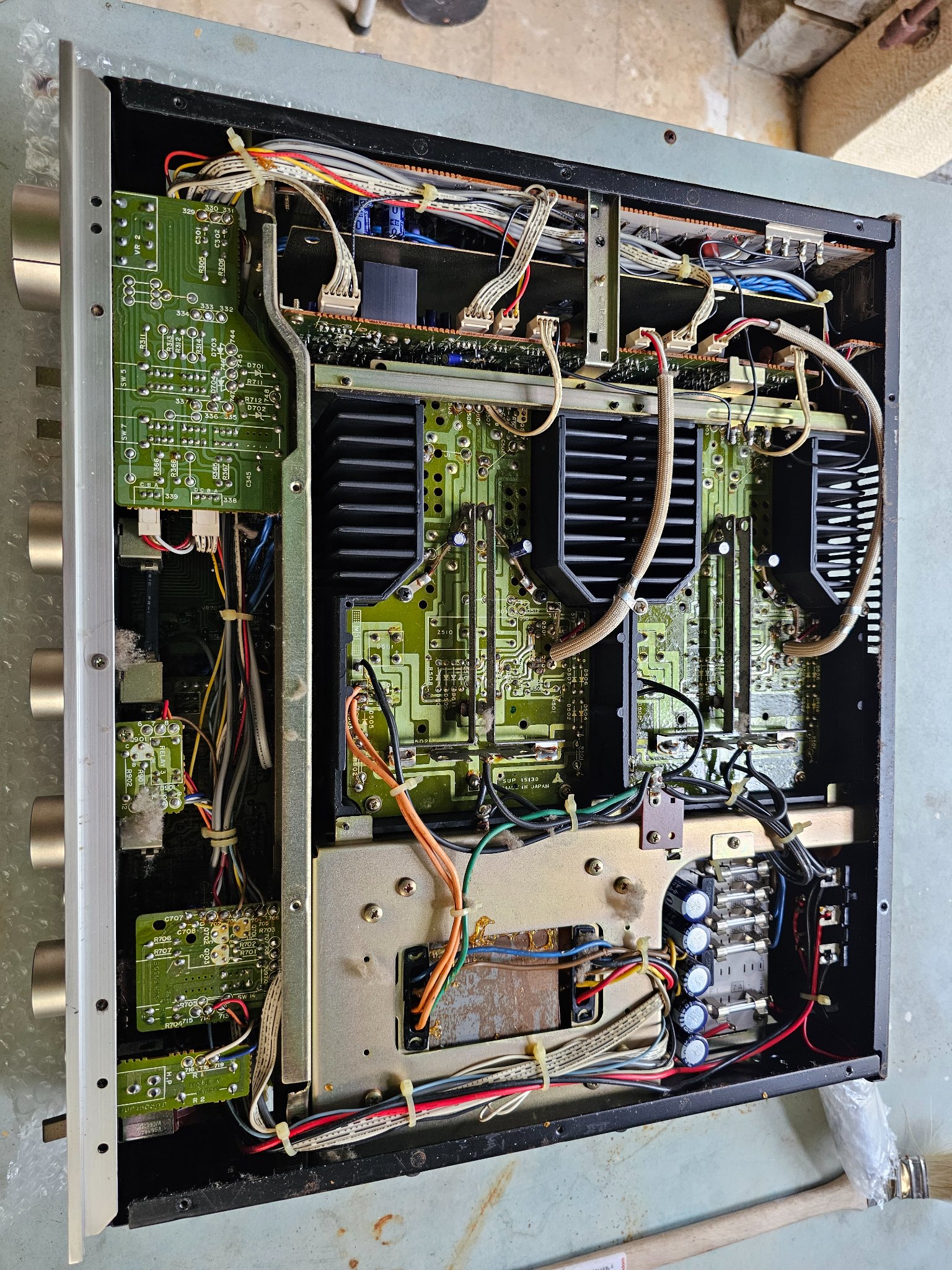

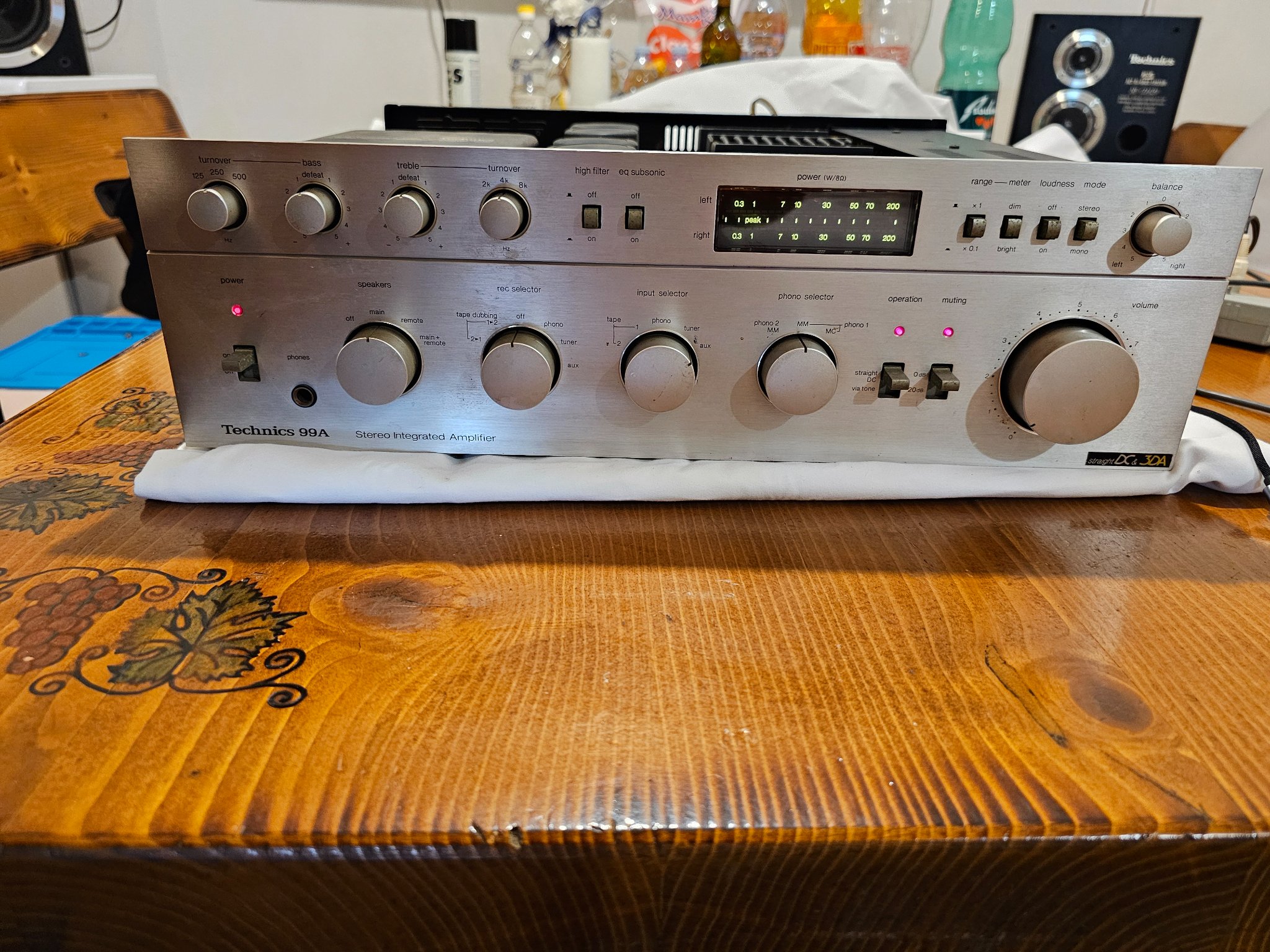

I received this prestigious amplifier from a Japanese auction.
technics A99 or SU-8099
it is still nicely preserved.
but it has a problem... It turns on but there is no sound...
no click of the relay can be heard... ? what to do
the fuses are all ok
I am attaching pictures.. it was very very very dusty. He had 5 kg of powder. crazy
after cleaning it looks like this.

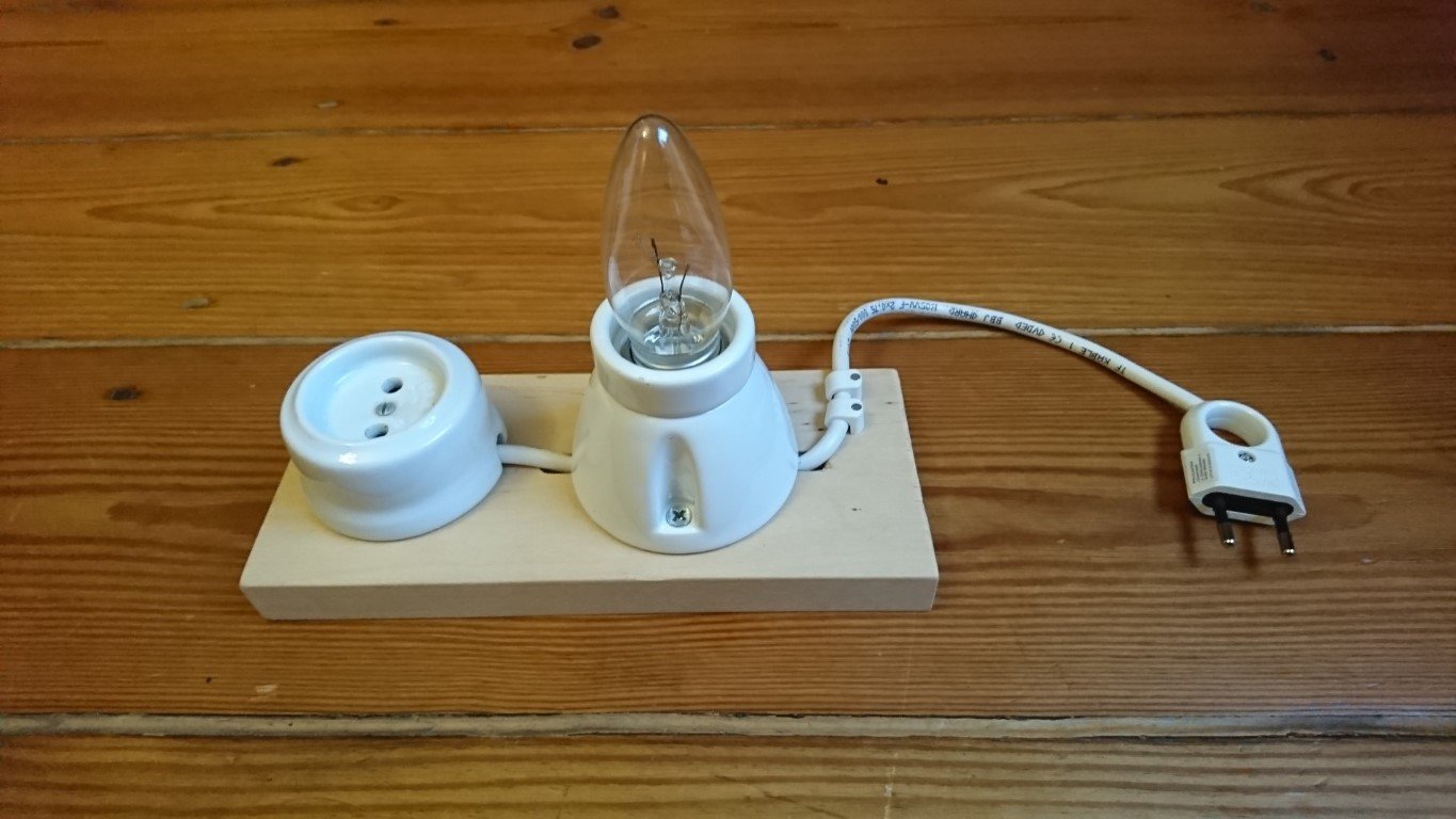

And have you got a DBT (dim bulb tester)?
Well, you can always build one - no spaceflight involved 🙂I don't have a dim bulb tester

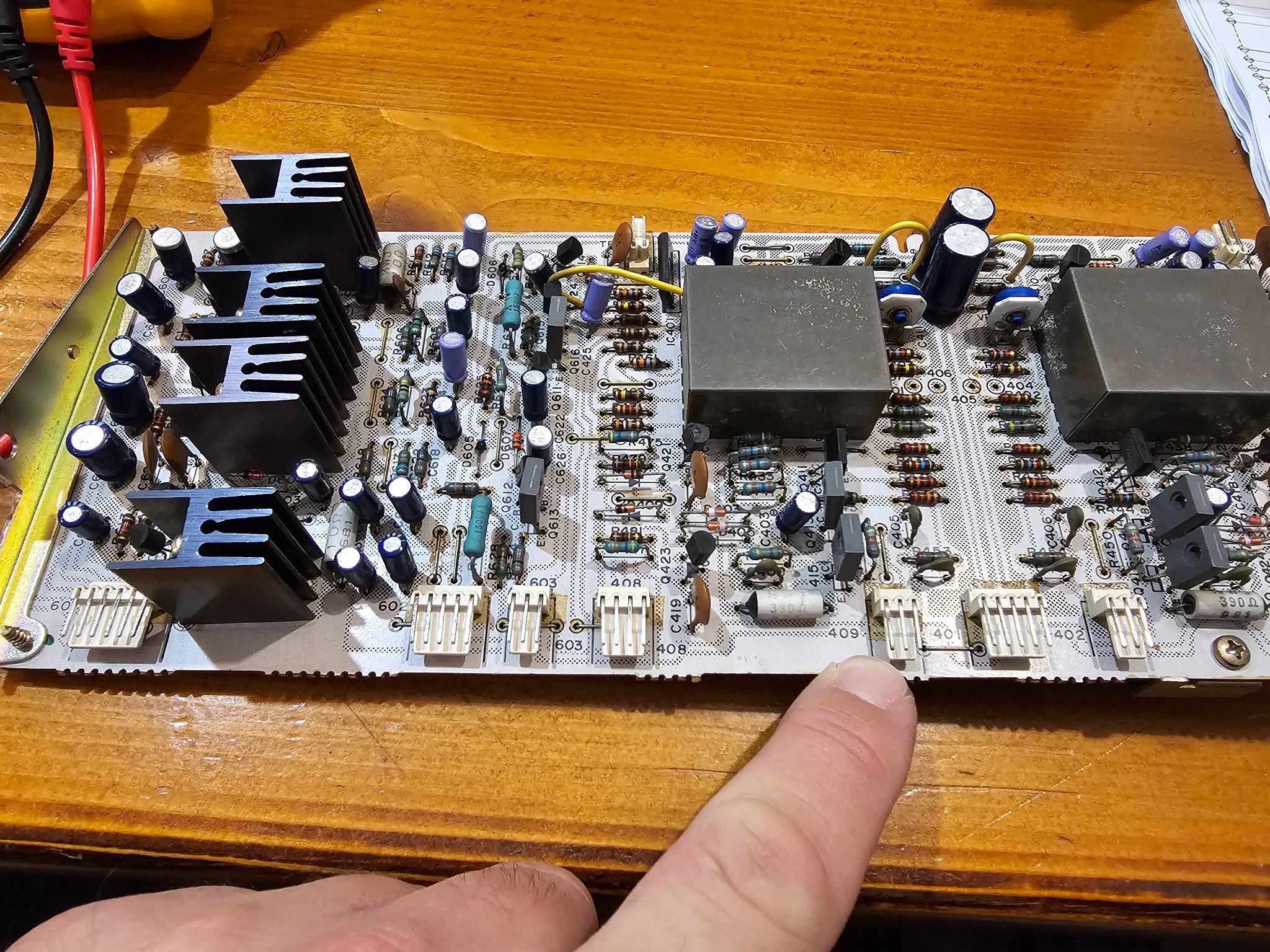

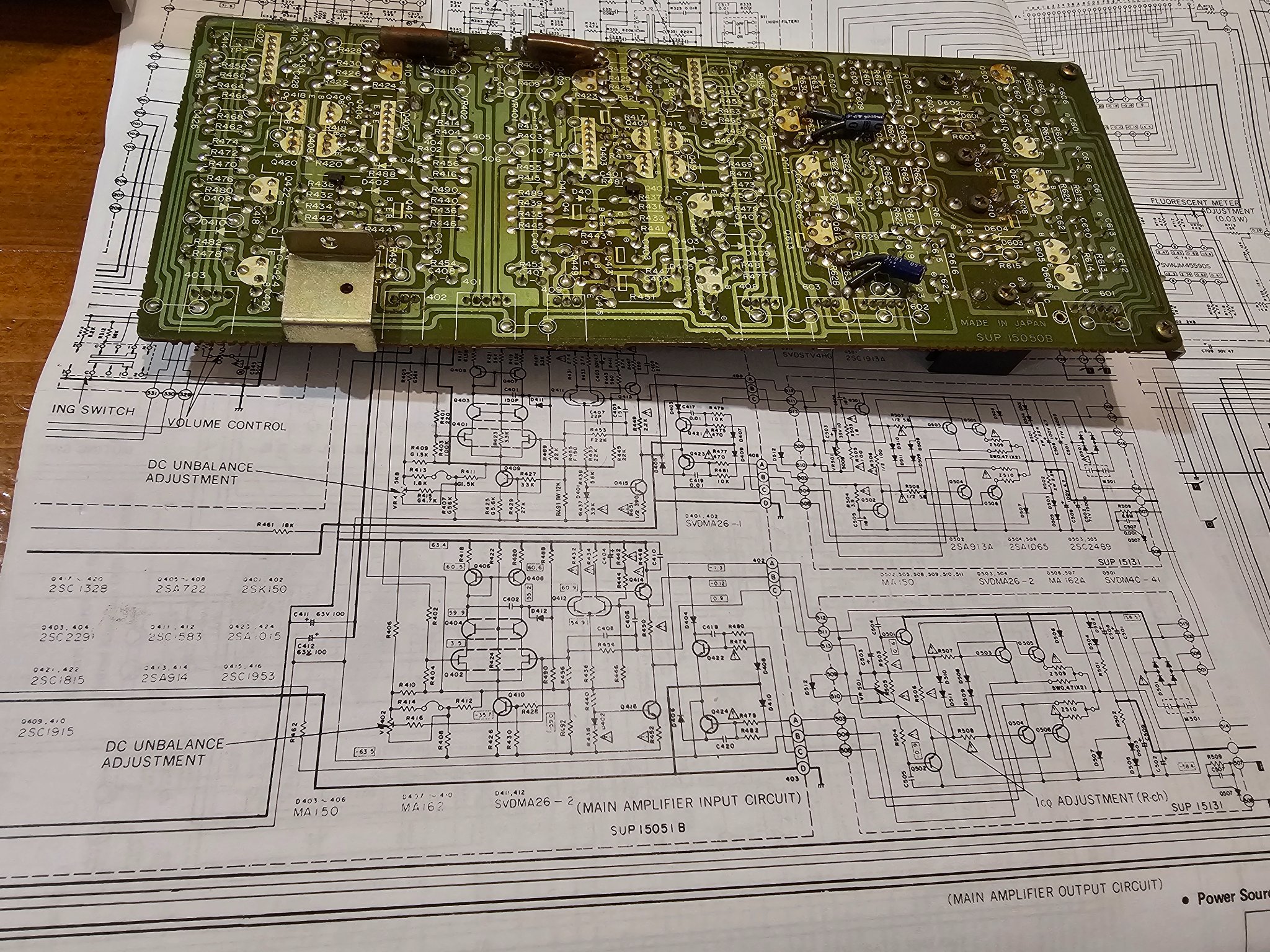

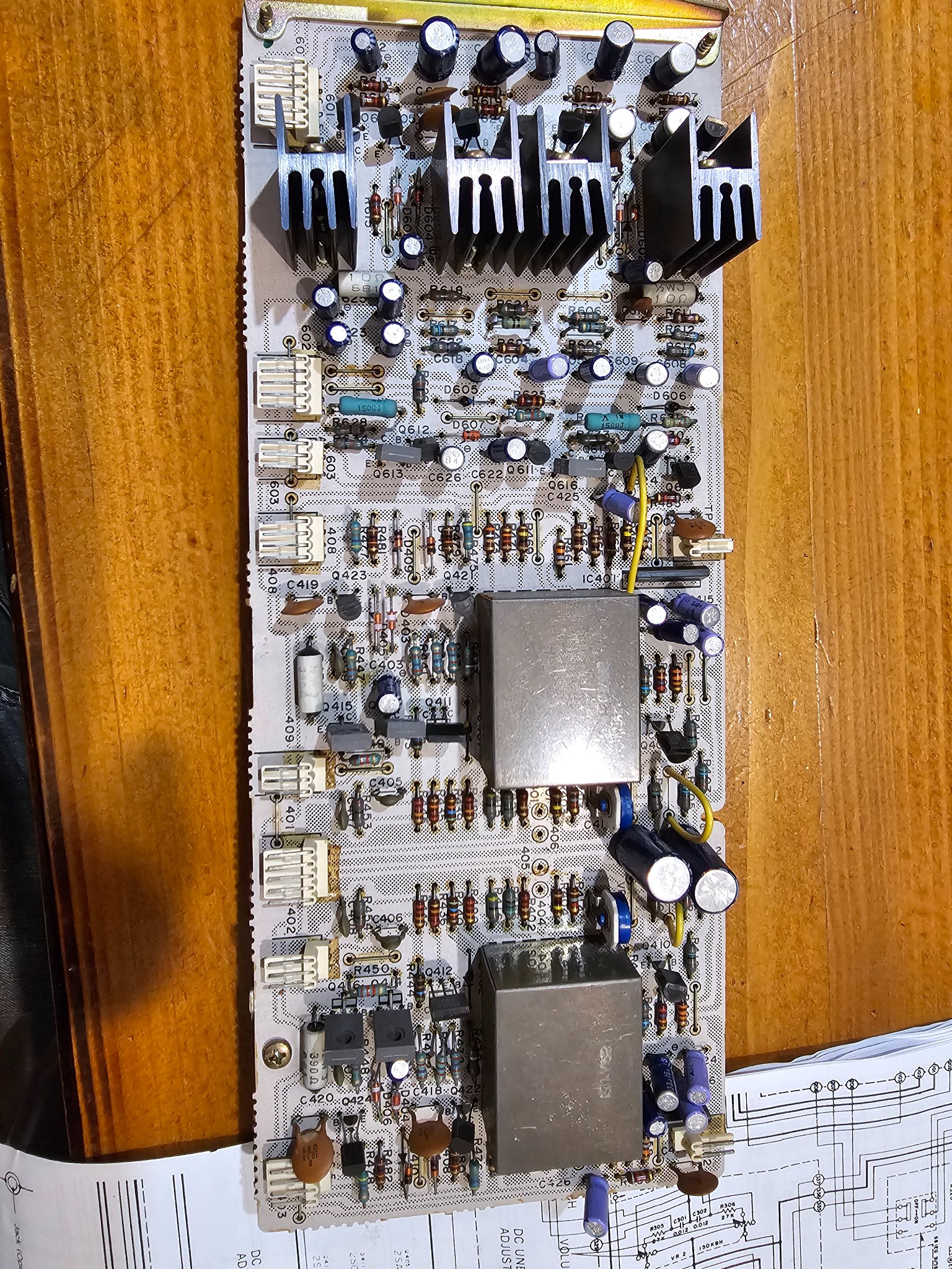

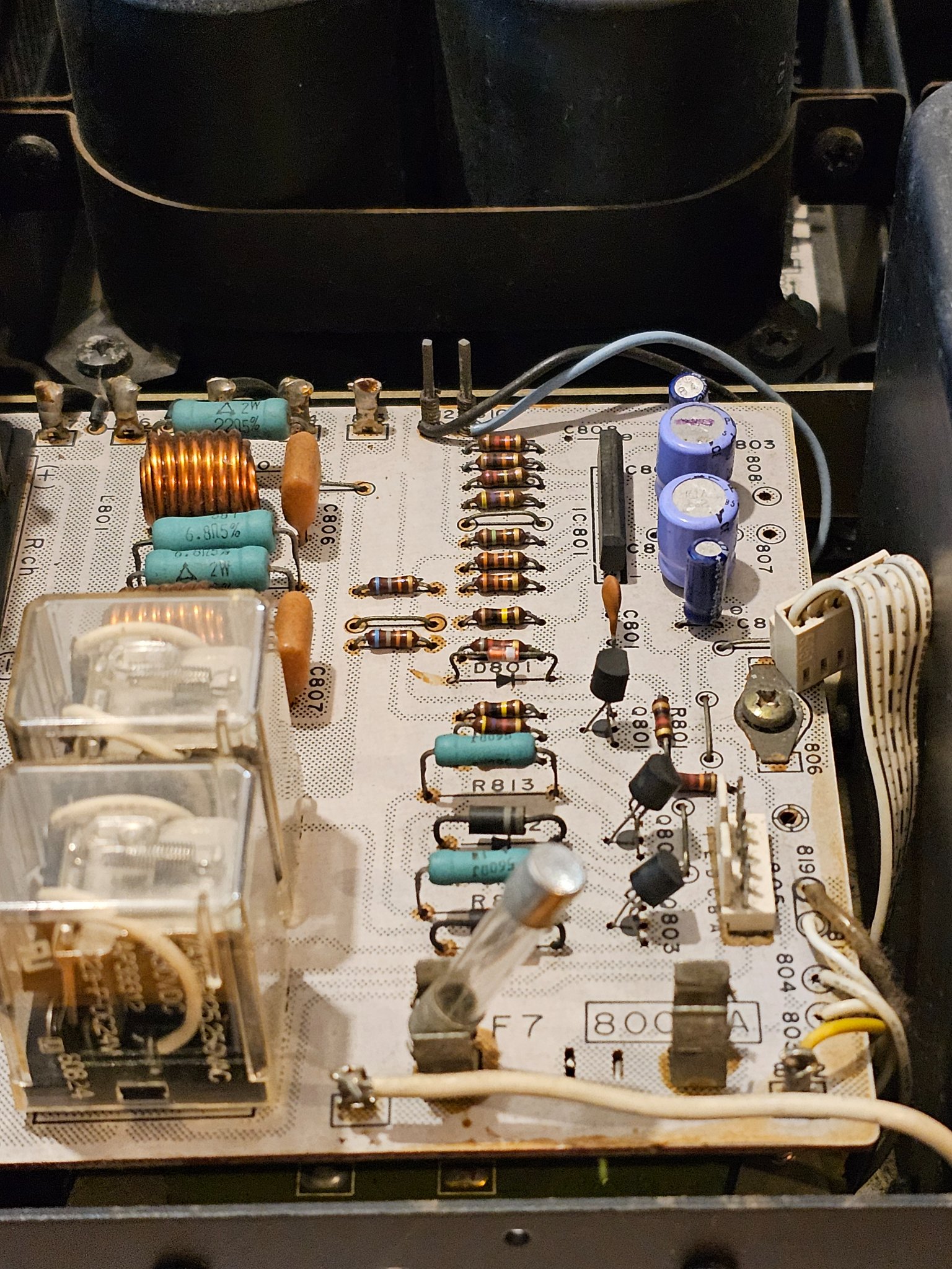

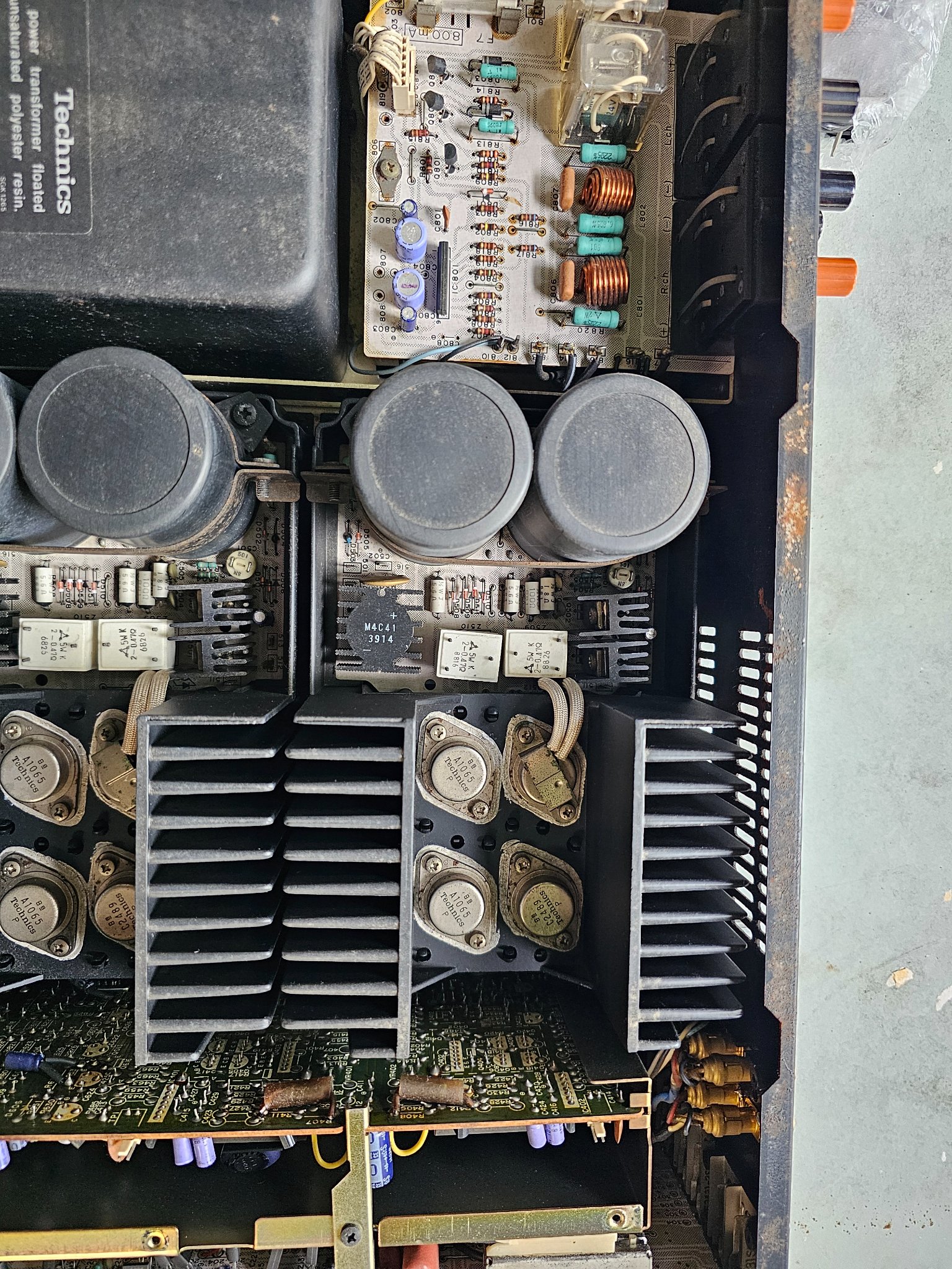

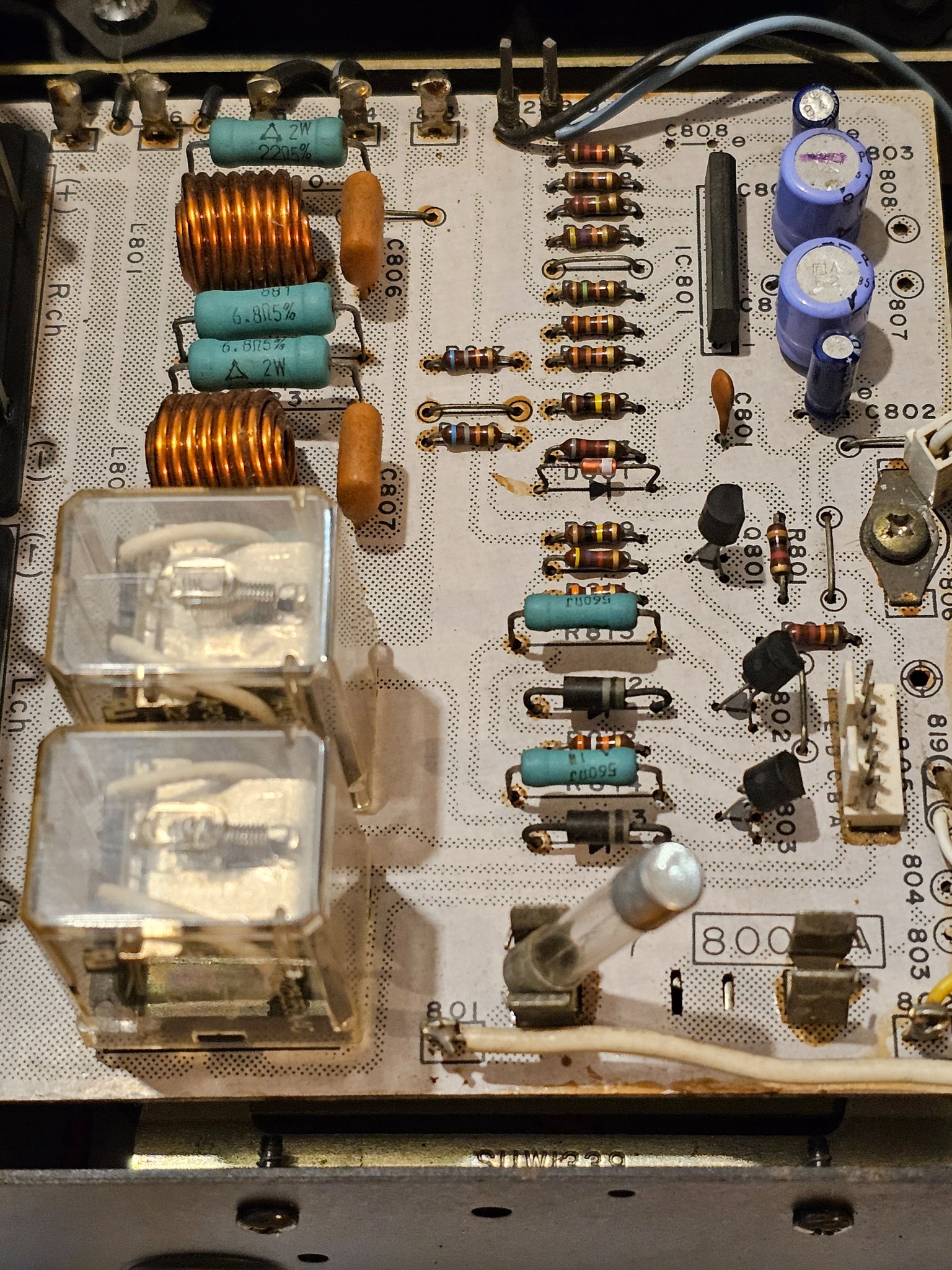

hello after 7 hours of torture checking etc... i came to the problem...
therefore.
the problem is in the board, which I don't know what it's called..
on connector 409 as shown in the picture. right side of the board
the ground gives me 54V which it shouldn't..
connector 409 right plus 402 left lead up to the board where the main transistors are. the left stage connector 402 works properly. the relays turn on and the sound reaches the speakers..
409 ge connector to the right side of the amplifier. (right signal)
therefore. somewhere, 54V is breaking through on pins A and B of connector 409..
I couldn't figure it out.
I suspect the Transistor 2SA772, there are 4 pieces in the faraday cage. and one is behaving strangely.
Look picture.
