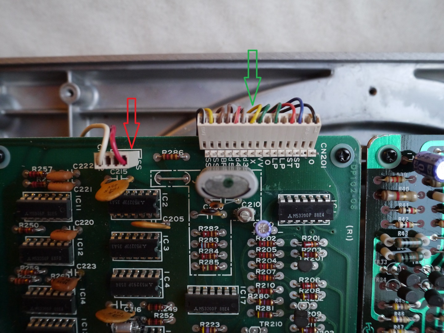

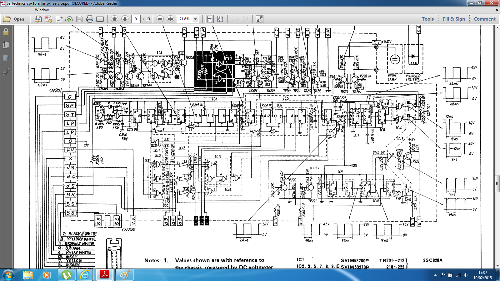

Looking to remove the computer type cable from my BBC technics sp10mkii p/l, now the table in bbc stock form is made up of three boxes, the psu, sh-10e the table the sp10mkii p/l, and also a control box the sh-10c. I want to do away with the control box and restore the start stop function on the deck itself.
The logic board is where this cable comes from, this comes in many different versions all very similar, the bbc versions have some of the functions of this board outsourced to different boxes. The version I have differs slightly from the original stock domestic sp10 mainly in the parts I have highlighted, other things of note is a redesigned clock circuit and a different layout in some areas but it all seems to correspond between the stock version and mine (the p/l version).

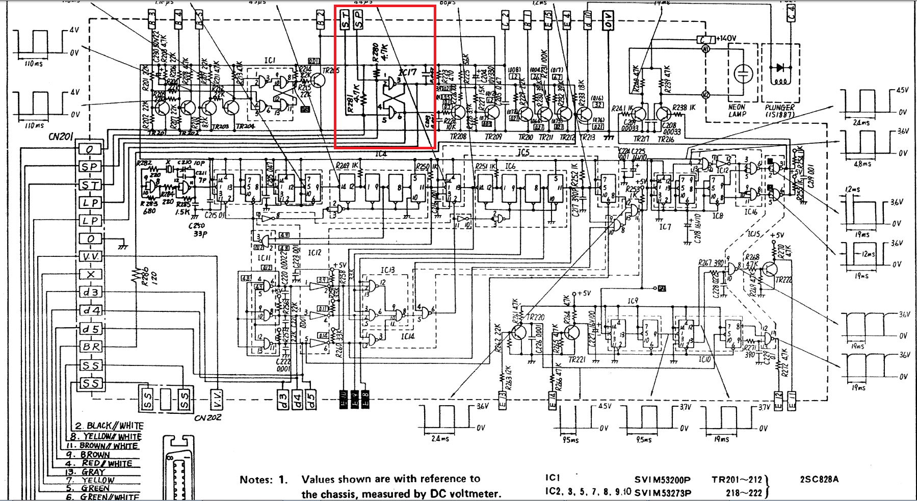

Now my question is if I change the highlighted section on the p/l to the same circuit as the stock sp10 would this restore the start stock functionality of the deck as it was originally intended?

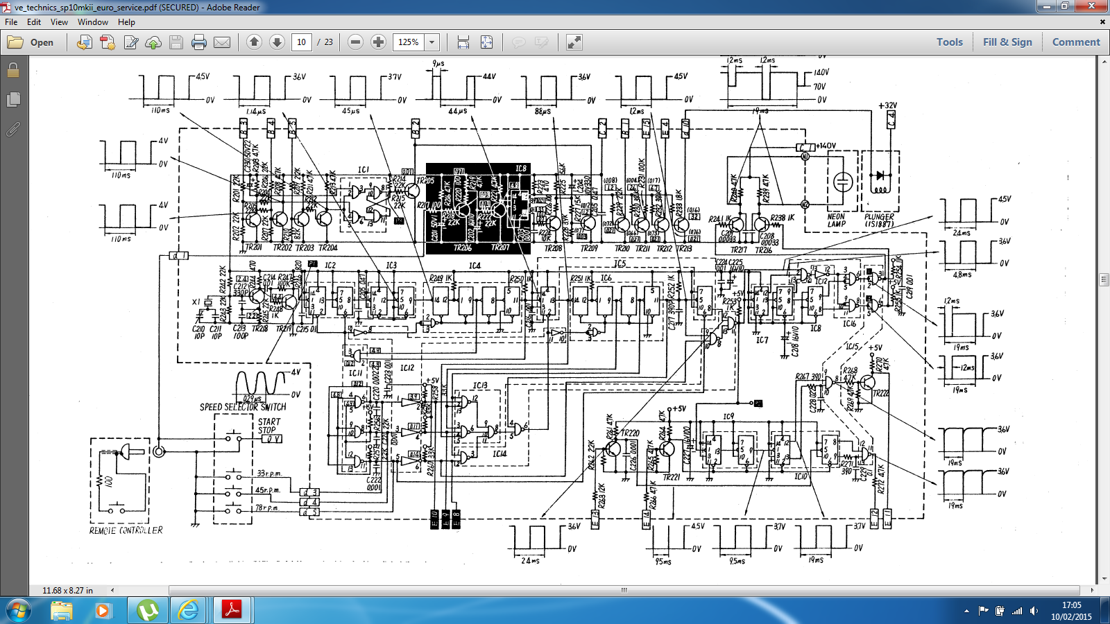

Please see attached schematics, first is the domestic sp10, second is the bbc broardcast p/l version.

Looking into it further IC7 which is highlighted also ties into the clock circuit, have technics used the ic instead of discrete circuits?
Hi Jim
I'm already in contact with Christopher and supplied him with the correct service manual. The last one I did was to dead bug a flip-flop onto the fixed connector board and use an R-C for a debounce, three components in all, but I have the test gear to work with.
Dave

Dave, one more question if I may before I submit to technically superior friend,

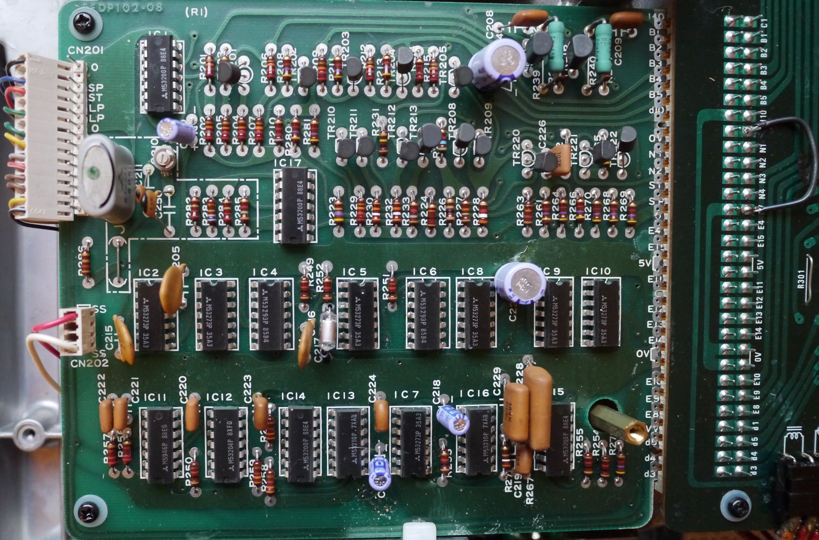

This is what the back of the logic control PCB looks like - two cut tracks and a wire bridge:
The upper side of the PCB also reveals that R221 and TR208 have been removed:
Do you think this is all that constitutes the "Start/Stop mod" and if I would just replace what's missing, bridge the tracks back and remove the wire bridge, would the original start/stop functionality be restored?
An observation that might be of interest;
SP10 service manual spec for the TR201-212 and TR218-222 is 2SC1328.
However, the PCB contains 2SC828 in all these positions and I have found references on the Net that seem to indicate that C828 is indeed the right transistor (?).
Since the 2SC828 is not available in .ZA, would it be safe to use the BC547 or BC548?

Well done on the PSU's !
Virtually any transistor is OK in those positions.
I would rebuild and check stage by stage with a scope the start/stop.
Dave
Dave
Dave! Thanks for the encouragement - I have great success to report! Start/Stop works like a charm. No double triggering, one click start, one click stop.
R221 = 4.7k
TR208 = BC546 with "legs crossed"
Tracks bridged,
wire bridge removed.

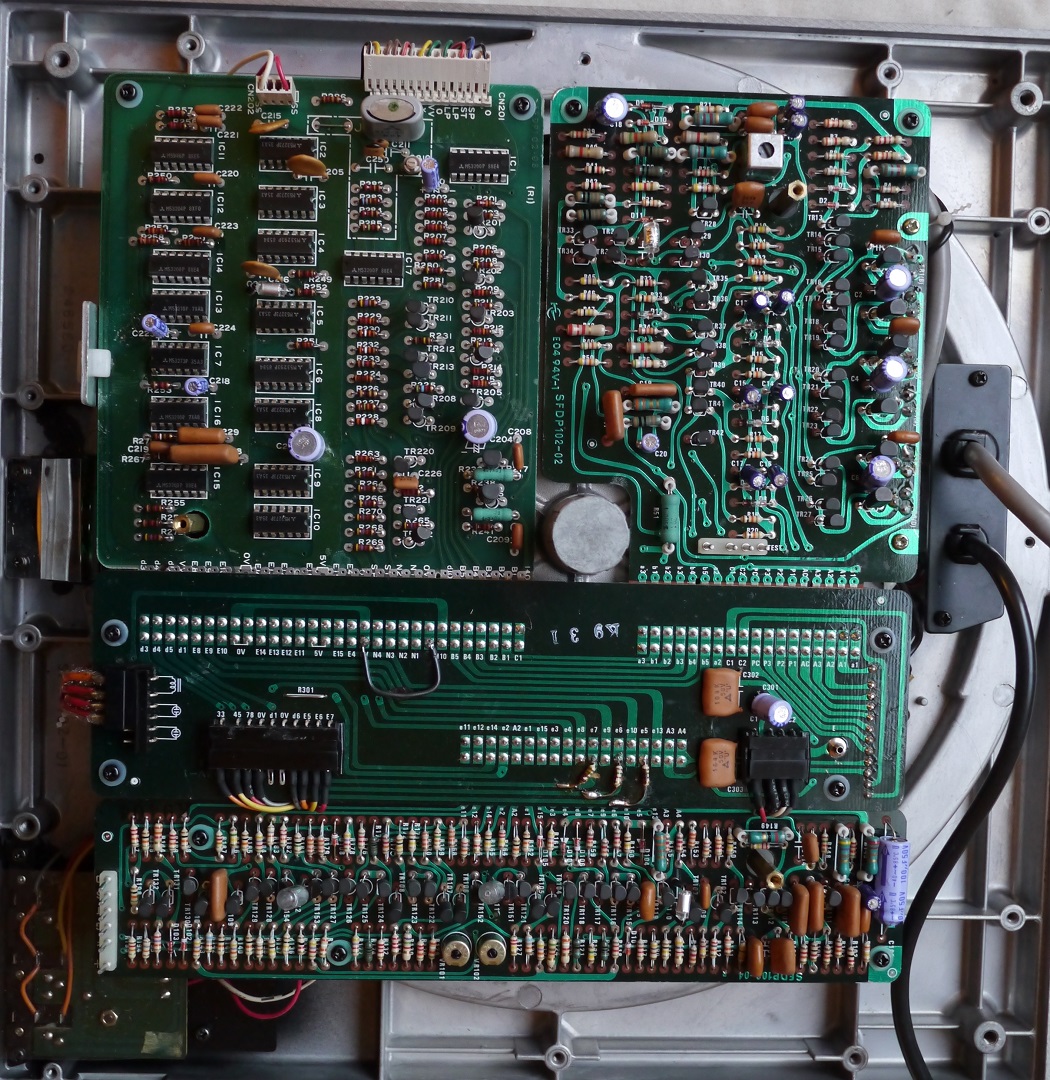

I uploaded some pictures of the circuitboads on my SP-10mk2P. The logic board differs a bit from the BBC models. Any help looking at them?
Thanks in advance.
Please help me restore functionality of the onboard Start/Stop switch on my SL-1000mk2P.

Trying to understand this, as IC-17 is working as a "flip flop" and is included on this logic board, should it not be sufficient to attach a switch to in turn connect "start" and "stop" to ground? Like the red and blue wire on the connector marked with a green arrow on picture no.5 i my first post.
I am referring to page 9 in the service manual for SP-10mk2 p/l found on VE.
This is fun!
This is fun!
Hi all,Here is page 9 in the servicemanual
