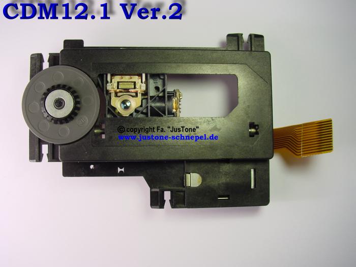

Laser is OK.
Try to clean lens with isopropanol and dust off spray ( compressed air).
What mechanism is inside? CDM 12.1?
A lot of old players with DC spindle motors have problem to mantain correct speed becouse motor brushes and comutator are not clean.
Motor must be opened and cleaned.

Hi Gasho,
Thanks for your reply. Are there any identifying characteristics for cdm 12.1? I know what CDM 2 and 4 look like but not 12. I've actually just taken a drastic step and cleaned the lens with optics cleaner and it's a whole lot better, although time will tell as to it's effectiveness. If you do have any info regarding the 12.1 re adjustment it'd be greatly appreciated for future reference.

Hi Gasho,
She's still playing perfectly! Ahh bless Windolene. My mechanism doesn't look like the cdm 12.1 as far as I can see. I taken a couple of pics but can't downsize them enough to post them. Could I email them to you?

Hi Mat,
That's a Technics mechanism.
You need to do the following. Release the slide rails and work on them one at a time. Watch you don't damage the carbon track that provides position information underneath.
Clean the rail with Alcohol or lacquer thinner. Use a touch of very fine "diamond oil" or some other very fine oil (single weight, no additives). Make the coating even and wipe it off lightly. Reinstall the rail and repeat for the other. You may want to clean out the bearings in the head.
The slide motor is a linear type. Very quick. I like them. If you don't have the proper oil, try to buy some from Technics. It isn't cheap, but it is critically important. This transport is far better than the Philips types.
