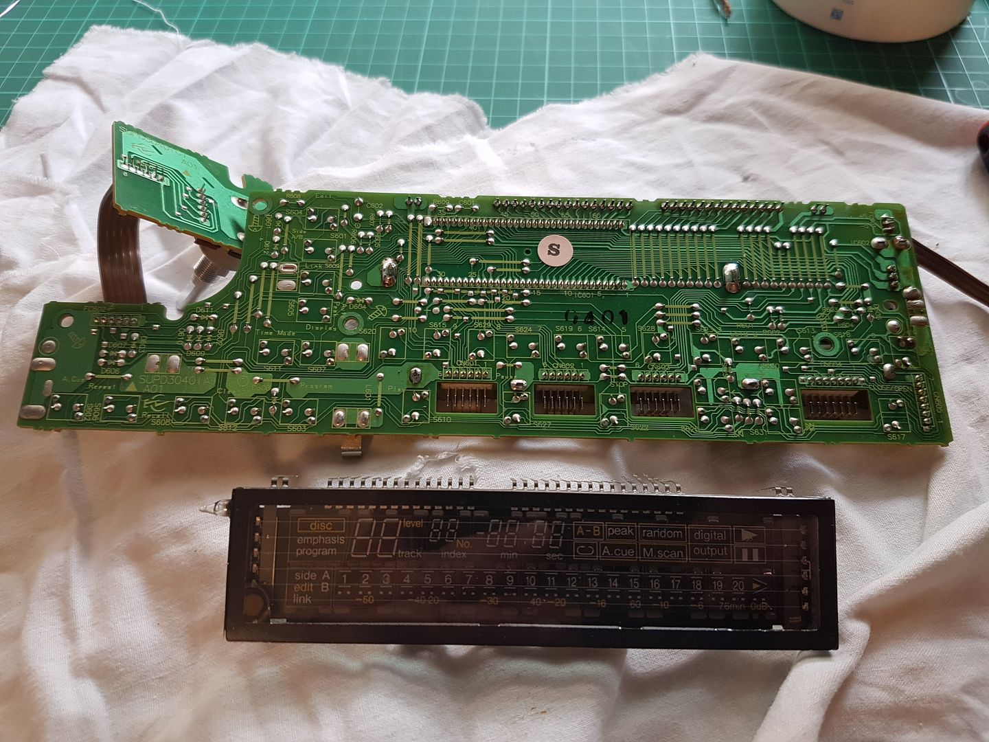

Advances in the project, with the change of the display and the replacement of different plastic parts of the front.
https://i304.photobucket.com/albums/nn165/Trident000/SL-5555/20190614_181928_zpsnuyr26qs.jpg
https://i304.photobucket.com/albums/nn165/Trident000/SL-5555/20190614_182138_zpskoyxuk7f.jpg
https://i304.photobucket.com/albums/nn165/Trident000/SL-5555/20190614_185149_zpsw6zeykc0.jpg
https://i304.photobucket.com/albums/nn165/Trident000/SL-5555/20190614_185204_zpsaaexm54r.jpg
