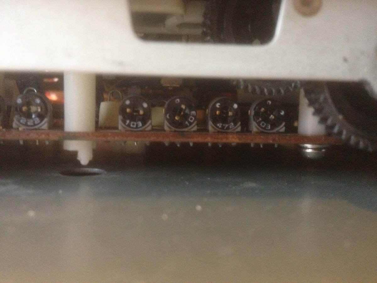

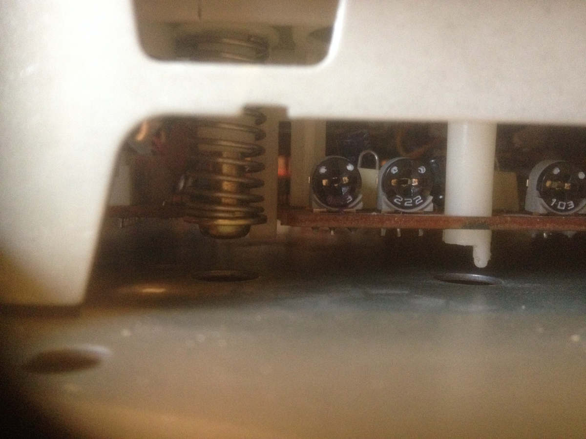

I could not get my photo off the iphone to my linux pc, but if that helps almost all the potmeters where in the mid position except the tracking gain adj. VR104.
that was set almost all the way to the left. and focus gain VR101 was a bit off left from the middle.

Thanks, i left it aside after repair the tray in switch that was broken and continued with other devices ande let my head cool off on that, but yes a picture of the potentiometers could be of help, thanks a lot!
Sorry for late replay, but I have worked on my scope.
That took me all day to take apart and clean all the switches and pushbuttons.
I just hopping it will work..... and I did not mess up anything.
here are the pictures, they shot before I setup the VR103 and VR106.

Okay, i've setted the pots as your picture then calibrated vr103 and 106, it did improve a lot but still doesn't reads
There's another pot on the mainboard that adjust disc speed, is already messed up too, and if that pot does not match with clock speed data is gonna be all scrambled, i guess i now need an OSC, but thanks for the original settings, now the machine is quieter and is one step closer to be working!

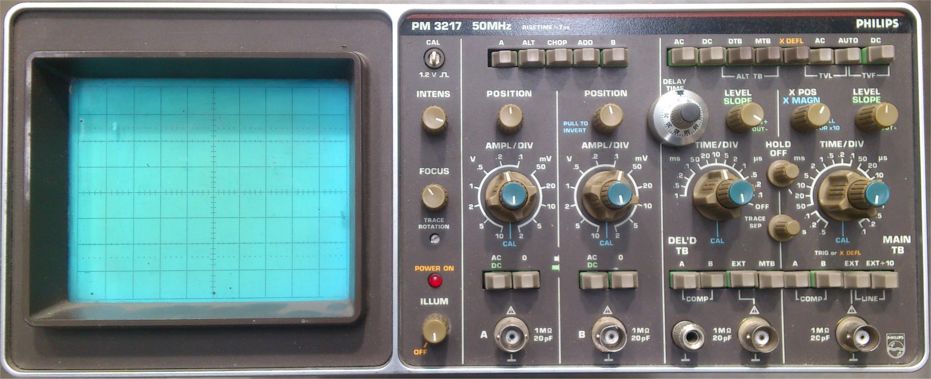

Yes you need a scope for that. get some old philips theye are very good,mine is still original except the power supply in which I had to change some capacitors. and clean all the knobs, switches for the best working.
That OSC looks nice, here is somewhat strange, a brand new 50mhz oscilloscope with LCD screed costs less than a 25 years old 40mhz banged up CRT one... is that something that makes old CRT ones particulary better than the newers with LCD or even USB ones?
Both are usefull maybe the USB ones are not that good, but I prefer vintage stuff in everything. Better parts and build quality. I got lucky with mine bought it less then a 100 euro, but its worth 300.
