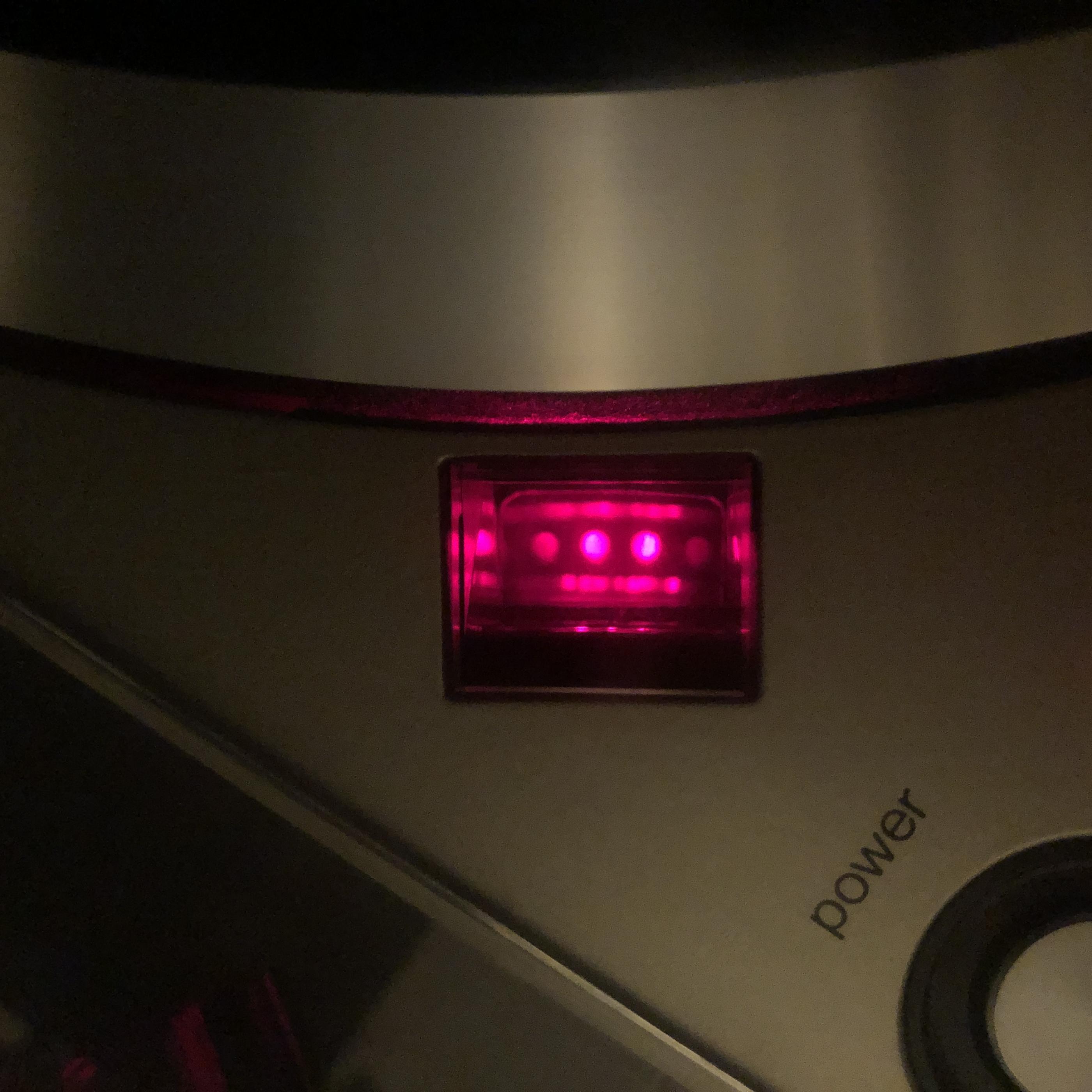

I recently purchased a Technics SL-1301 with a jammed 45 selector switch that I managed to fix. While testing the turntable for any other issues I discovered the reference strobe app on my smart phone wasn’t synching with the turntable’s strobe which is supposed to be locked at 33.3333. rpm. I adjusted my phone strobe speed to 33.666 and it synced with my turntable strobe light. As it turns out this turntable doesn’t have pitch control pots. For further reference I played the same song from vinyl and an online steaming source. The vinyl slowly out paced the streaming source. I’m trying to figure out if a +1% drift is common for quartz locked turntables. I’ve read that the reference crystal frequency may drift over time, and this turntable is over 40 years old. Otherwise, the turntable runs great and holds steady with a surprising amount of drag. Any help is appreciated. Worst case scenario is I’ll have a little more free time from my vinyl 😉.

I'd be inclined to print out a strobe disk and check the speed with a fluorescent or incandescent lamp. The apps available on smartphones are useful, but generally not accurate for speed.

Thanks for the help and insight. Those crystals are hard to find. Thinking c226 is out of spec, but the tolerance in the manual is 10%. Anyway, I’m wrong. I can’t explain why the phone app is also wrong by 1%. I just checked twice with the good ole stop watch (on my smart phone) and counted the number of rotations at 33rpm for 6 minutes: 200. If there is a +1% increase the count would be ~202. Ugh sorry for the false alarm - I think this is lesson to forget the technology and enjoy the magic of music 🙂)

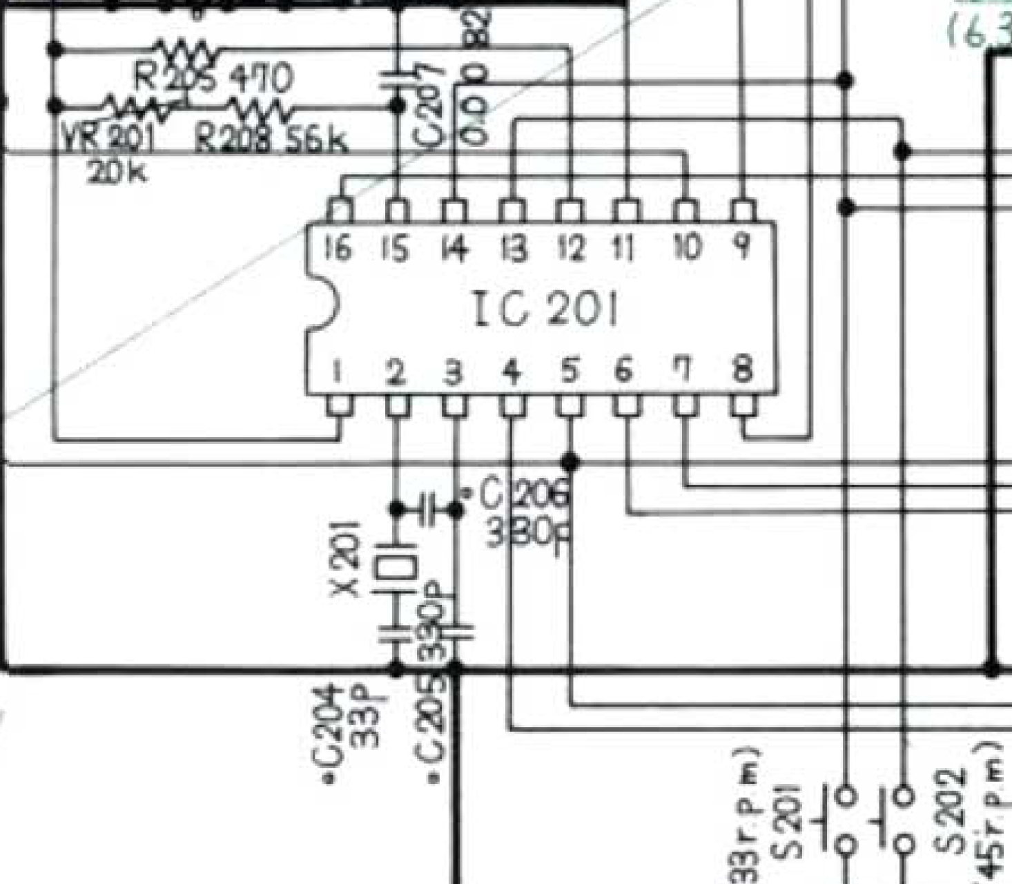

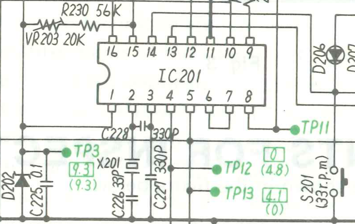

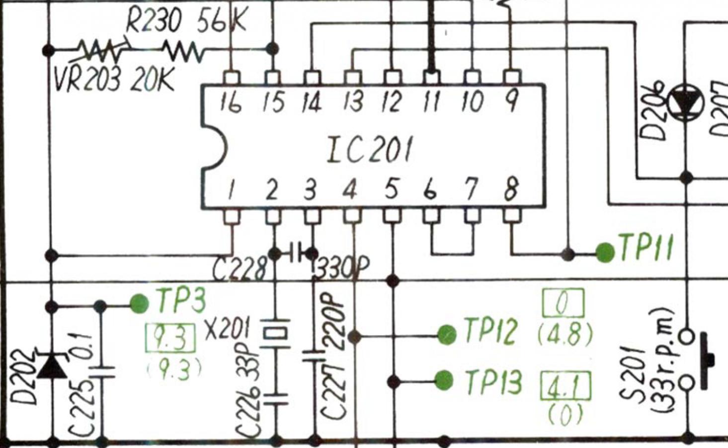

I found an apparent discrepancy in one of the crystal loading capacitors (C227 - 220pF vs 330pF) connected to IC201 pin 3. This could be a typo because I haven't been able to measure the value. I've attached screenshots of that section in SL-1301, SL-1401 and SL-1300MK2 (C205). Could the discrepancy account for a slight change in frequency? I recently replaced the electrolytic capacitors, diodes, and readjusted voltage, current and tracking with an oscilloscope. Now I am entertaining the idea of replacing some of the more essential ceramic capacitors (though I hear they rarely need replacing) when I stumbled on the discrepancy. I should add when I used the same phone strobe app on my sl-1700 (now sold) both strobes were spot on.
Probably a typo. Errors in their service manuals are rather common. Typically best to replace it with the value that came out - it’s stamped on the cap. That said, I wouldn’t bother.
Ok thanks for the response. Decided to experiment on my turntable with new MLCC capacitors from mouser. Will see if there’s any difference in waveform and frequency in 220 pF vs 330pF.
