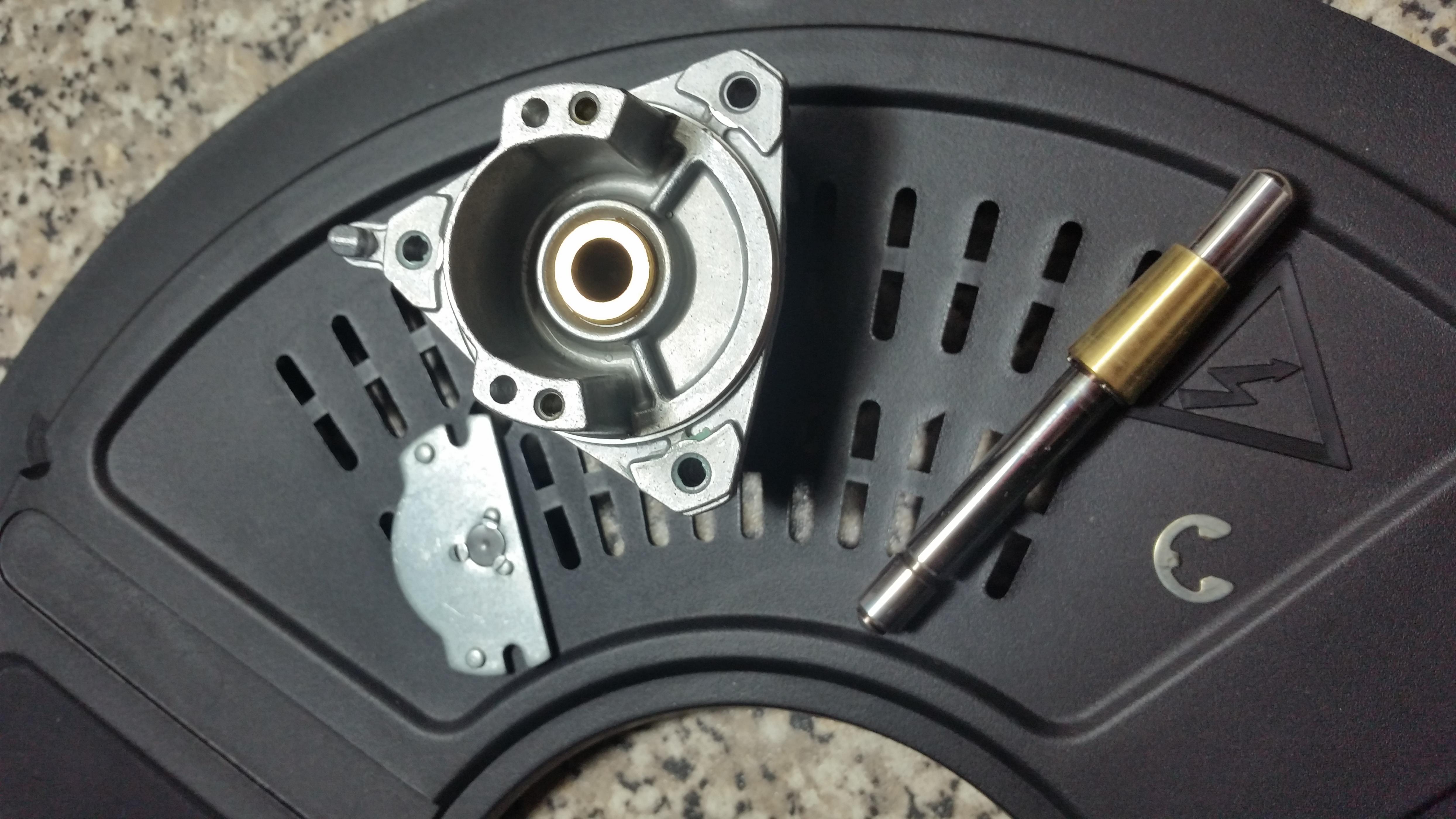

Rather than lubricate the bearing, remove and disassemble the bearing so it can be properly cleaned. It is easy to remove - only three screws hold the bearing to the chassis. Two more screws allow the bottom plate to come off so you to extract the spindle. Clean each piece, add a drop or two of oil and put everything back together.
When you put the bearing back in, add a neoprene washer (or two) under it so that the bottom of the bearing becomes coupled to the chassis. This will help reduce noise just a bit.

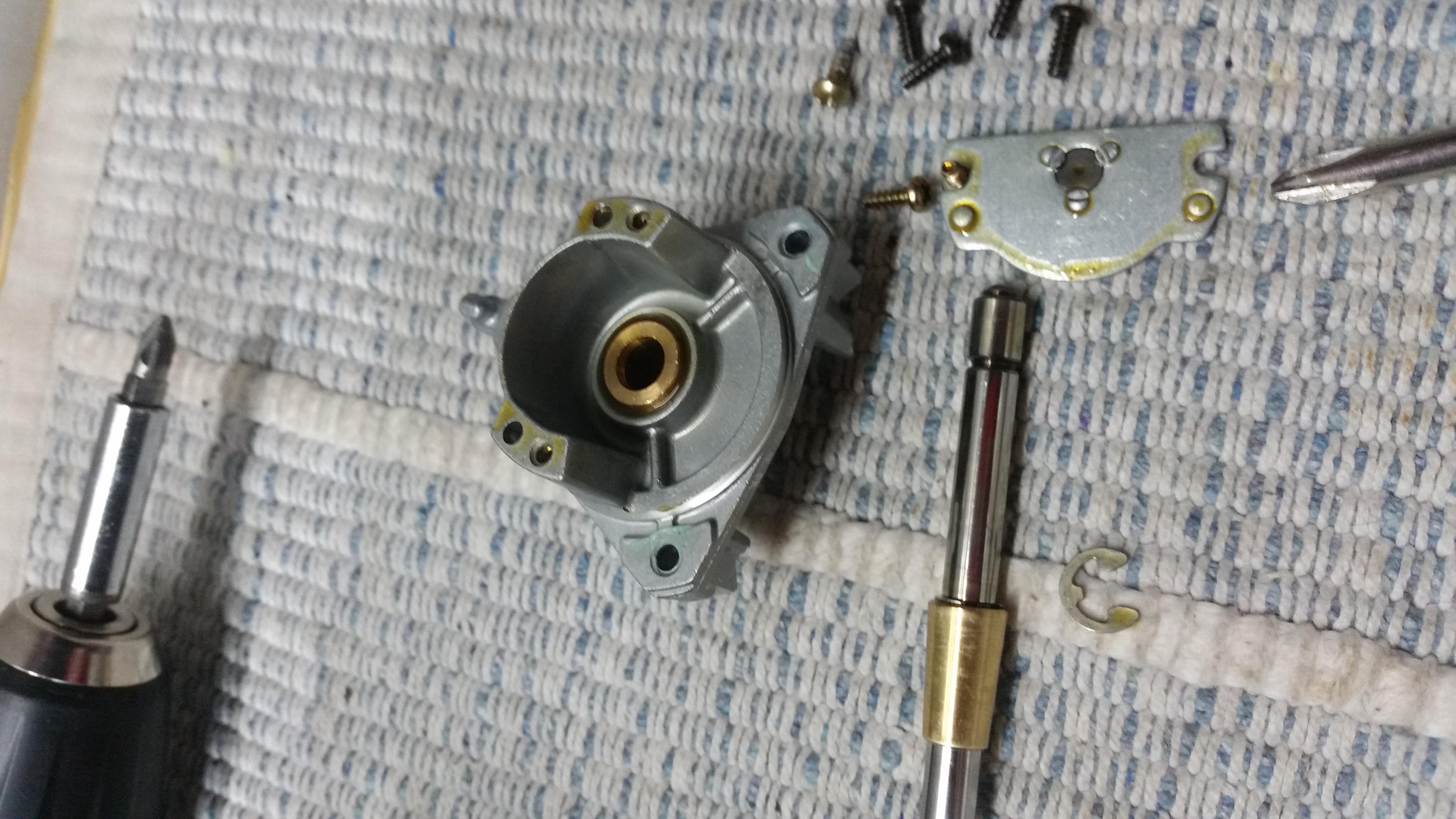

The entire bearing assembly is quite easily removed (after careful disconnecting some wires, 3 long screws at the motor, pcb board screws) then lift off the whole bearing from under the pcb. Thereon it can be fully dismantled and cleaned up. Only a slight difficulty is a C clip locking the spindle to body. Lightly lubricate the spindle with 3 in 1 oil (Blue bottle - SAE20) and reassemble. If there's no wear, you're good to go. Good luck!
Pass DIY Addict
Joined 2000
Thanks for adding the images- I was going to do the same today. It is really a rather simple process. The wires on the PCB that need to be moved are all connected by a harness, so as long as you are gentle, this is very easy.
