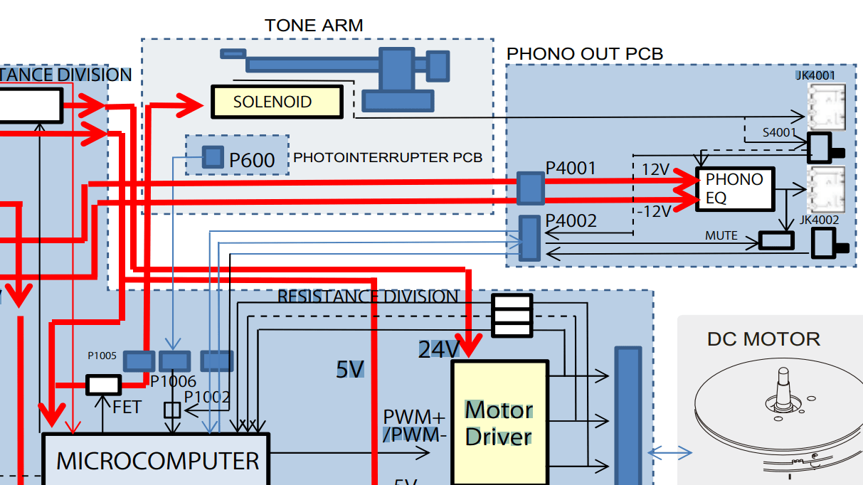

Hi All. The SL-1500c has a built in phono-preamp and a switch to change its use so there is a direct connection to the cartridge via a 2nd set of RCA sockets on the back. The built in phono amp is then not in use. When I use an external phono stage there is a crackling popping sound about the level of a scratched record. This occurs with all 3x of my amps and different interconnect leads thus proving the interference is produced in the turntable. Strangely...Very strangely this noise is produced even when the turntable isn't powered! I contacted the seller and this is what he says. I personally think it's nonsense...THIS IS THE SHOP REPLY: "I’ve had a chat with our Tunbridge Wells store as they have much better knowledge than me about turntables. I relayed about the ticking noises you had been experiencing when connected to an external phono stage. I’ve been informed that there can often be incompatibilities with direct drive turntables and some phono stages (especially older ones) and it’s to do with a timing problem inside the phono stage. It’s not indicative that the turntable is faulty, but unfortunately a by-product of how it interacts with phono stages designed a certain way (despite the fact the noise comes from the turntable). Apparently, phono boxes from Project, Lehman and the likes are most likely to cause this problem. One suggestion was to try the very versatile NAD PPE phono stage as it is widely compatible with all types of turntables." .Please let me know your views or ideas what the noise is. Thanks.
Here is the basic internal wiring for the turntable...My thoughts are that there is some leakage of the signal into the input of the built in PHONO stage...this might be why the interference is there even when the turntable is not powered: The 2x pairs of RCA sockets are shown on the top right with the switch. The other switch turns the auto-arm lift on and off.

Thanks cln.white and Bfpca for your help... As I thought, I did not expect others to have the same problem as I am convinced my one does have a fault. This will give me a strong case against my seller. I just hate it when non-technically minded people start coming out with stupid remarks like the "timing" on old phono amps might "clash" with a direct drive turntable. As regards the other problem with hum. I have tried many variations regarding the earth and the linking wire but just connecting the earth as described creates the lowest hum but it is definitely louder than when using the built in phono stage which I have to say is very quiet relatively. I have checked and measured the direct output for resistance back to the head shell using a head shell without a cartridge and directly onto the loose tails in it...nothing is amiss. As said before by me, the CRAZY thing is that even without the turntable switched on at the mains the noise is still there. I even suspected induced noise from a faulty dimmer switch or such like but I have made sure everything else is switched off too. It is not inherent in the external phono-amps as the noise is identical with 3x different ones and each is quiet when no turntable is connected to. I have even connected the pre-amps to an old Technics turntable and fitted with different cartridges but there is no noise being generated like the new SL-1500 so it must be coming from the SL1500. I will now contact the seller and ask for him to take it back...preferably to change with a new one but it is now over 14 days...wish I had tested this external phono amp usage earlier. I'm now sure it has a fault but cannot say for sure what might be the cause apart from signal path leakage back into the microprocessor or internal phono amp via the rear selector switch or wiring....
