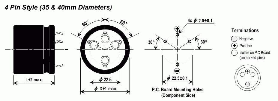

has anyone come across these capacitors before?
I bought 2x22000uF 63v ones a while back, they have 4 pins like:
and I have no idea how they're supposed to be wired up. whether it uses - and B (for +) or if all 4 pins are used and there are 3 parallel caps inside.
Was just wondering if anyone has these in their equipment and could enlighten me? I believe technics used to use them in some of their high-end stuff. Unfortunately, I don't own a capacitor tester :/
