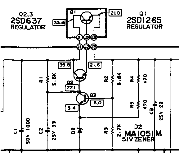

I have a problem with my technics, the strobe light flashes on and off when the platter turns and there seems to be less torque. Do you think I should replace q1 (i have 27,27 and 36 volts off Q1)?

Hmm...what did the turntable drink? 🙂
35.8V on collector.
21.6V on base
21V on emitter
are the correct values.
27V is IMO too high.

I think I may have shorted something, was replacing the target light!
Just been doing some testing, i think q3 may have blown as i have 15v and 27 volts either side of r2. (also have 15 volts and 36volts either side of r1).

What transistor# is Q1? 2SD389 or 2SD1265?
Depending I can post the detail of the PSU with corresponding voltages.
Apart from that, you have a good chance Q2 and Q3 are broken.

Thanks for that, I'm gonna try and get hold of q2 and q3 tomorrow and replace them.

Ok its looking better now, i've replaced q3 and q2, but have found that d3 has blown (ma4051mta) any ideas of where i can get these from?? or a suitable replacement?
