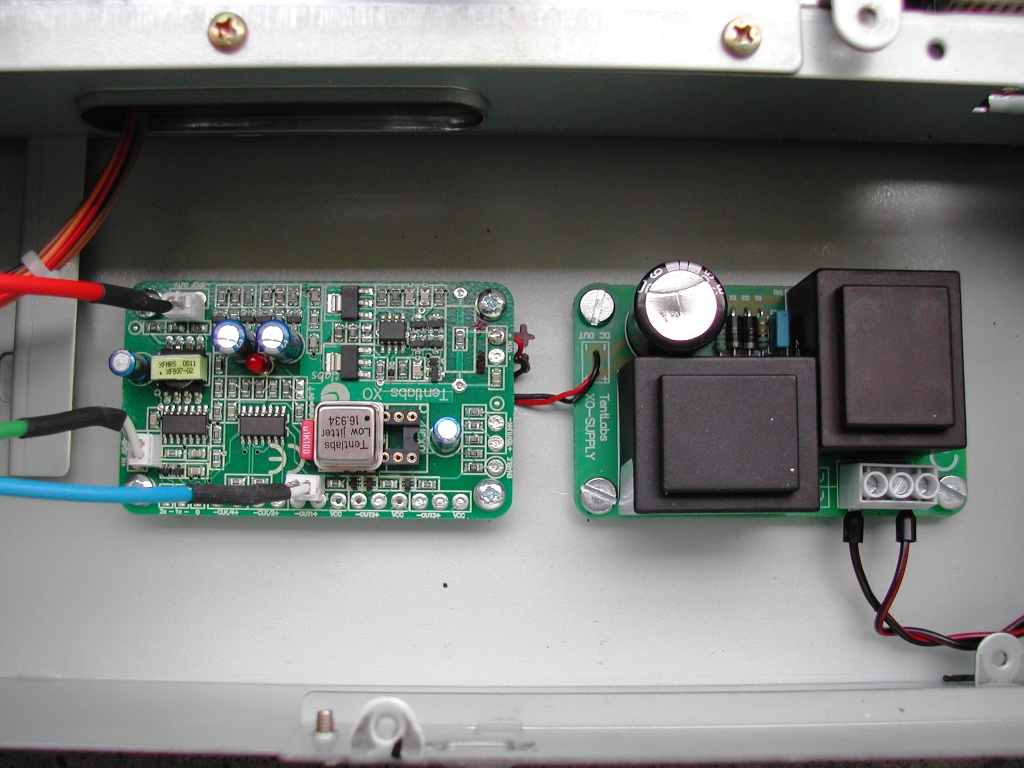

my concern is jitter in audioble part.
Secondly i have seen the pcb board of the tentclock it was yesterday in my hands.
Build it in but need more info from Guido, and this week i drive to eindhoven to let him take a look into my teac.
Low jitter clocks stands with a dyhard pcb, if you take power from a part of the teac ....it will probely making a bad jitter ..... i bet it ads even more jitter.
All prints are drilled into the bottom of the teac 😀
Ahh oke also a nice psu with it
EZ Ultimate Clock System is nearly the same price if you let it come over from china
I`ll stay with a formiliar desine from Guido ... hes made some impression in the dutch audio world
But thanks for the link .....

Hi dutchaudio,
Well, you could always lock a PLL to the clock and monitor the tuning loop. There's your jitter - exposed. From there, look for common signals on the PCB and power supply. That will lead you to the source.
A controlled oven along with a DC frequency control loop tends to be extremely stable. Even just oven controlled and not locked to anything. The best any other manufacturer can do is to equal this performance.
BTW, really large caps in a power supply tend to create spikes. I'm not looking at what appears to be a well designed power supply there. Sorry, no offense.
-Chris
the psu is only the cap you see on the board 😀
And guido knows what hes doing, well comming saturday im off to Eindhoven to meet him, to sort out what is done wrong ... by me 🙁
And in the evening to Roger Waters in Arnhem live preforming "another flesh part from the wall" 😛 realy looking forward to it
Highend audio is notting like Live music is being played
