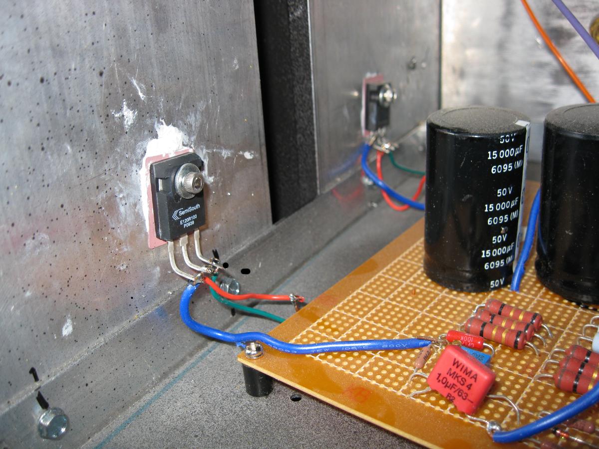

F2 with SS.
I was inspired by another member to try these on the F2.
Poped it in, needed to pump up the bias. It dropped down about 4v. The sound is different, have not gotten around to analyzing it yet. Listened to my Fostex FF85ks. It seems to be a 'cleaner' sounding F2.
