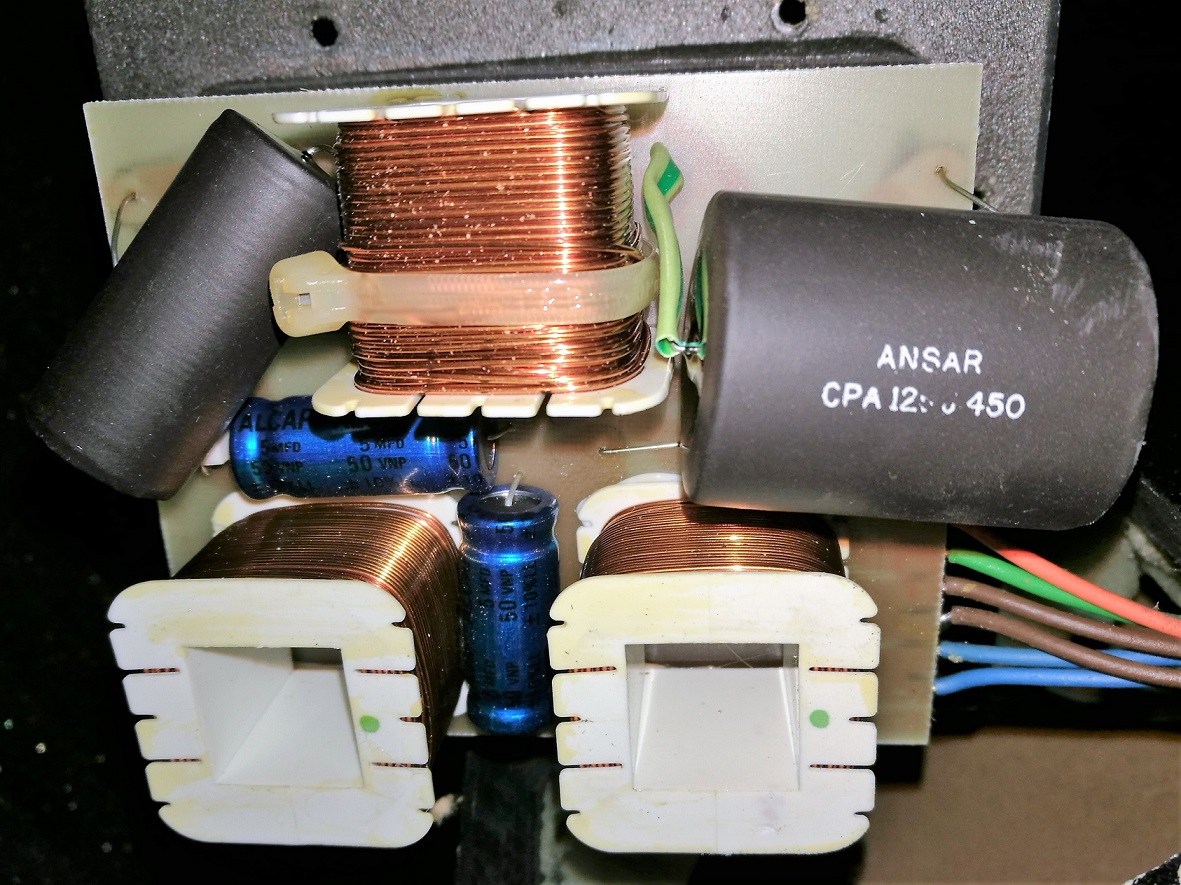

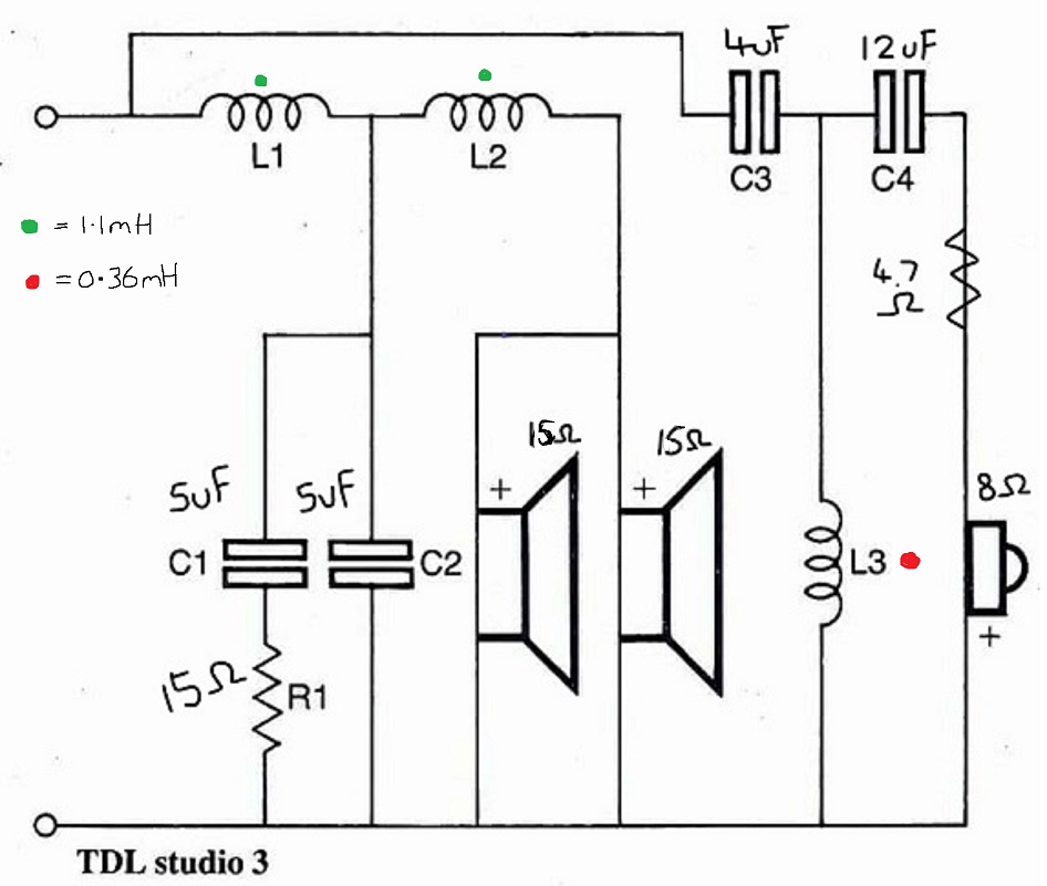

Next on my list are upgrading the internal wiring and giving the filter a proper upgrade with high quality components. Since i don't have the exact values of the original components i have to measure them individually. The caps have been replaced in the past and are confirmed to have slightly different values due to availability. Current reverse-engineering put into a drawing below. L1 still unmeasured. More on this later!

All drivers are TDL branded, the woofers have "electric acoustic industries ltd" imbued in their frames. As for the original filter components, they were basic cement resistors and a small air coil inductor with ~0.7mm wiring. It measures 0.9ohms which is a bit high i guess. The caps have been replaced by MKP ones, i'm sure they weren't that high grade originally.
My goal is proper quality series components, MKP+ for the high along with a MOX and a good low resistance air coil for the low frequencies, depending on its mH value i still have to get measured. Parallel part in low can remain MKP cap and a cement resistor.

Updated the filter image in the first post for those looking for the original values. The project is finished and i can finally enjoy my music again 😉

For information - Studio 3 mk2 owners will find the crossover unit directly behind the binding posts on the rear of the speaker and not behind the lower bass/mid driver as shown in images on the net - which I guess are from version 1?
You will find 4 caps on the crossover - 2x 5uF caps, a 4uF cap, and a 12uF cap. Please correct me if I am wrong or if you find Mk1's or MkIII's have a different setup.
