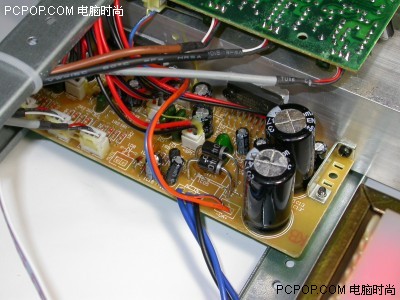

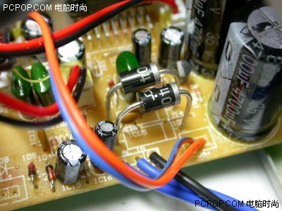

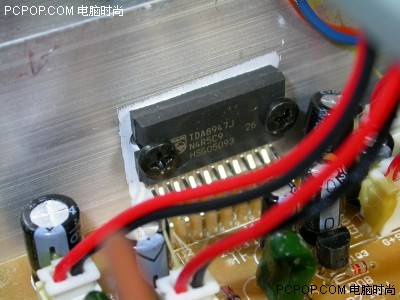

i have a power amplifier kit based on tda8947j.Now i want to use it as car amplifier.This kit is working in btl mode.Kindly tell me that what will be its output power at the load of 4ohm load on the power supply of 12-14volt(single supply).Kindly see the attached datasheet.
thanks
some photos of my amp,(taken from net,but i have the same kit).

Considering Vcc 14 volt dc the o/p is nearly 21.5 watts and for Vcc 12volt it is nearly 16watts.This chip can drive 8ohm load in btl mode at Vcc 18Volt so i think it can drive 4ohms@Vcc12volt if adequate heatsinking is provided.Kindly give me some more info about this.
thanks.
Those graphs are for 10% distortion which is ridiculous in my opinion. I like to test amplifiers for maximum clean power just before clipping to get a better feel of its capabilities. I checked a few BTL ICs designed for car audio use. These are designed for maximum output swing due to the relatively low supply voltage. At 14 volts supply, you get 13 to 14 watts of clean power into 4 ohms.

The TDA1554 is a newer IC with much less support components needed. Ignore the stupid 10% figure. That is well into clipping. These chips will do in the 12 to 15 watt range of clean power before clipping with a 14.5 volt supply. Check the THD vs frequency and THD vs power graphs if provided.

Your English seems fine to me. With the same Vs and load, the output power will be the same. In a practical test, there may be slight differences as chips can vary from lot to lot, but the difference would likely be within a watt. Since it takes 2x the power to make a perceptible change in sound (3db), you could never tell the difference.
to johnr66,
Thank you very much for reply.It was a practical problem for me but now solved.Actually i have a ready built tda8947 kit and i wanted to use it as a car-amp but not sure about its o/p at car battery voltage so i decided to make a tda1554q.since you told that both will give approx same o/p with above conditions so i am going to use the same tda8947 kit in the car.
