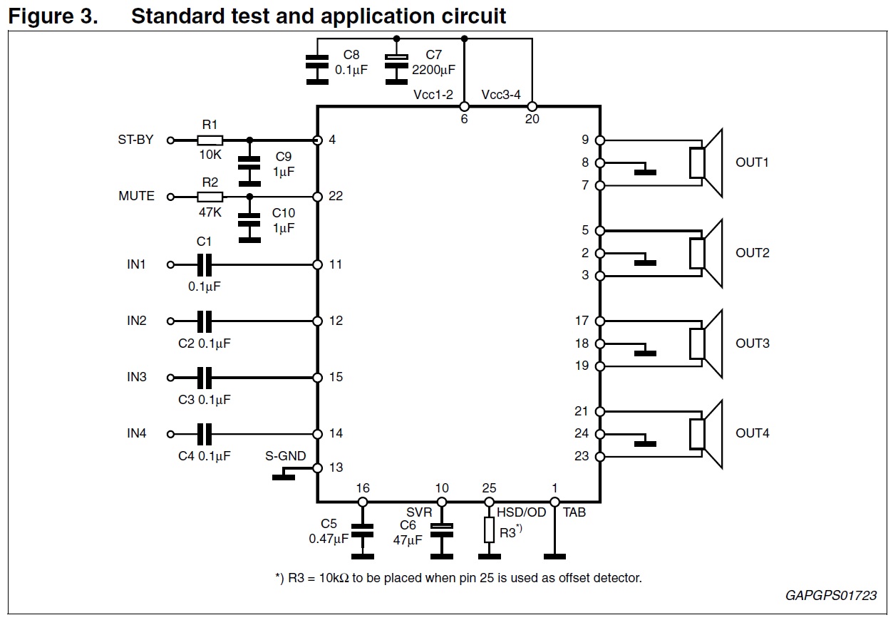

It is already bridged so you can't do it again. In theory you could put the four channels in parallel, two and two. But as each of the four channels already can pull a 2 Ohm load it makes little sense.
For those outputs you do not use, you connect two 100nF capacitors at the corresponding inputs and connect the capacitor terminals opposite those connected to the TDA7560 chip to ground. This way the unused amplifier channels will not pick up a hum signal. The outputs you do not use you leave without connection. TDA7560 is class A/B and do not need a load.

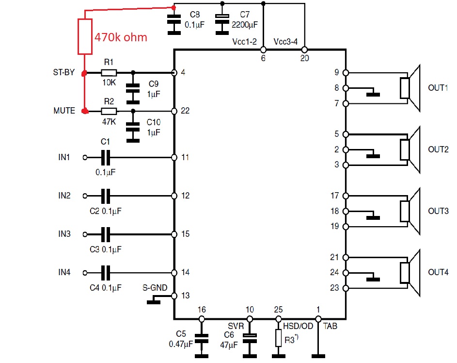

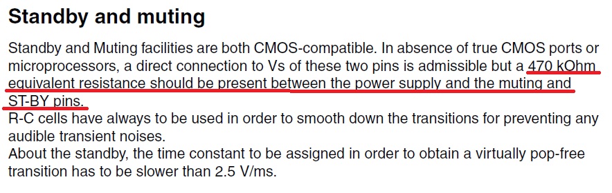

Yes, the 470K resistor should be connected the way you show. At least I understand the text the same way as you and it seems to make sense.

Oh; one more thing…
I sometimes find myself hard to understand users manuals. I’m not sure about 470k ohm resistor on mute and stand-by pin.
Is this what they had in mind like on attached images?

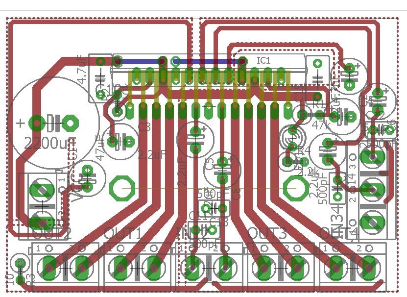

I have made 2 circuit pcbs of TDA7560 amps last year and still working well to date (no hum, no issues and very low noise). I'm using it to as a crude 7.1 audio system for PC. I connected the mute and standby pins to VCC.
Here are my schem and the pcb layout (though not as optimized as many of the masters here, hehehe).
Note: I think the chips I had was fake. I bought them around less than 300 pesos (>US$6) a pair from china. But they sound very good even from PC audio output.
