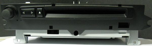

Hi!
Original BMW E60 2004 head unit Harman Becker BMW E60-M-ASK on the bench.
Came in with "no audio output" according to customer.
This unit has a 4 x 35W output IC (TDA7454).
Test revealed 10VDC output on all channels but rear right.
The latter produced 100% OK audio output.
Audio at the three others too, but speakers also fed with 10VDC (don't like!).
In addition, the unit draw excessive current and output IC got very hot fast (especially when speaker load (6 Ohms) were attached!)
Unit has a fan. One defect transistor found and replaced. Fan now OK.
Thinking the lack of fan functionality caused TDA7454 to overheat and fail, I'd replace the output IC.
Power up and test: now all 4 outputs has 10VDC and unit draws the same amount of excessive current!
Thinking I might did something wrong during IC replacement, I'd replace the TDA7454 once more - this time checking thoroughly that all solderings and pcb traces were perfect.
New test: same thing. output IC overheats and 10VDC on all output channels..
Did check all pins TDA7454. Nothing "funny" except perhaps all input lines (pins 11, 12, 14 and 15) raises to 4.8VDC upon power on - which I believe is normal due to the fact that they are fed from 2pcs single ended 4558 op amps.
Lost here.
Any ideas anyone?

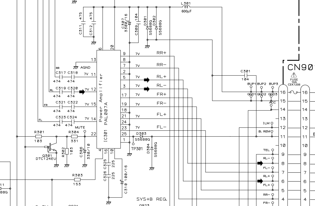

12v ICs that operate off of a single-ended supply (12v to ground, not +12v to -12v) that are rated for 20w/ch (RMS) have to operate in bridged mode and must be biased to 1/2 of the supply voltage to produce rated power. A typical car audio head unit has ~6.5v DC on every speaker output wire. The diagram below is from a pioneer head unit and shows typical voltages.

Thanks! The diagram however shows 7V on all output lines (both + and -) with respect to chassis ground. That will make 0V between the pairs - which of course leaves no DC output directly to the speakers.
In my case though, I got 10,2VDC on all +sides from the output IC and 0V on all -sides.
Measuring between the minus sides and chassis ground during power on, I actually read only 30 Ohms! Powering off the unit makes Ohm go infinite then drops to approx 8kOhm.
Seems the output IC almost "grounds" its speakers minus side outputs during power on.
Strange.. :-(
