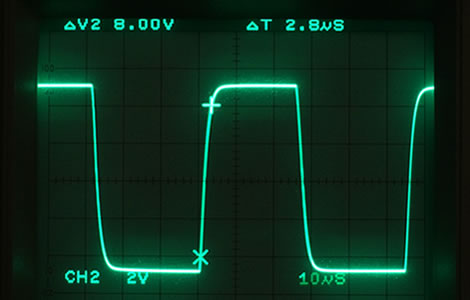

This is from two TDA7293 in Modular configuration, ie one as Master, the other as Slave.
Display is 20kHz Sq wave into 8 ohms at 10p-p.

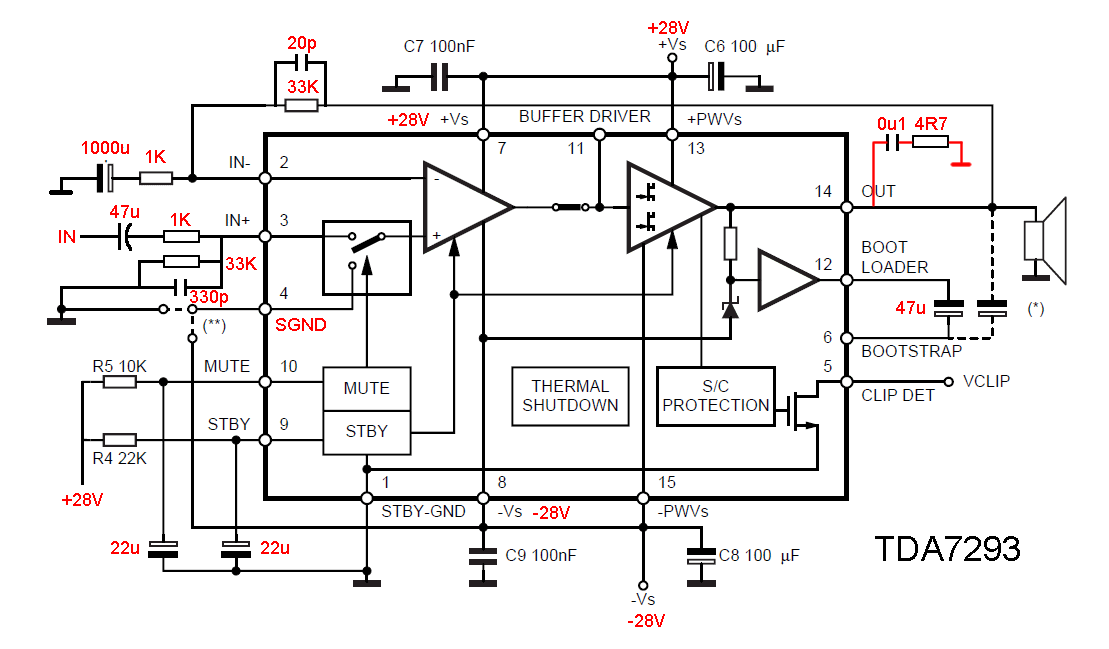

Could you please publish schematics of that amplifier with values of components. That would help us to identify the cause for ringing.
@Michael Chua
Thank you very much for your useful reply.
I have gone directly to my bench and your solution worked. I didn't have 20p capacitor on stock but I had 30p - overshoot and ringing are gone.
Now I will completely revamp my boards to have all values according to your schematics.
I do indeed apreciate your preparedness to help. I have almost thrown three pairs of board intended to my new three-way design with active crossover.

Square wave testing is a convenient way to check stability. If the amplifier rings a lot, its poles are poorly damped, so it must be at the edge of instability. Whether the ringing is audible is irrelevant in this case.Square waves contain many harmonics.
What is the frequency of the overshoot? If above 25kHZ, use an inductive filter to remove it as it is not audible, just a waste of energy. but ... having said that, I would expect overshoot with a square wave.
What is it like with a sine wave at say 15kHZ? If perfect, ignore the square wave data you have as it is meaningless.
Indeed,Square wave testing is a convenient way to check stability. If the amplifier rings a lot, its poles are poorly damped, so it must be at the edge of instability. Whether the ringing is audible is irrelevant in this case.
but there is even more: from square wave response we may obtain valuable information on frequency response of the device under test which is even more important information.
