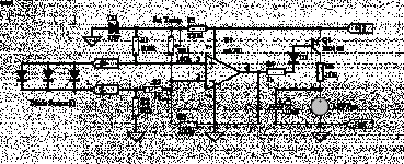

Somebody else have opinion about the schamatic? I looking for schamatic of PWM fan speed controller depending on the heat of heatshink.
Thank you! This is really simple. Is this switch on/off the fan, or controll the speed up/down if required?

Dxvideo, as I see the circuit switch on/off the fan. I found a simple motor speed controller here:
I think will better
I have to try this with thermoresistor 😀
I think will better

for the pwm circuit...
U1: LM324N quad op-amp
U2: 78L12 12 volt regulator
Q1: IRF521 N channel MosFet
D1: 1N4004 silicon diode
LED1 Red LED
C1: 0.01uF ceramic disc capacitor, 25V
C2-C5: 0.1uF ceramic disk capacitor, 50V
R1-R4: 100K 1/4W resistor
R5: 47K 1/4W resistor
R6-R7: 3.9K 1/4W resistor
R8: 2.7K 1/4W resistor
VR1: 10K linear potentiometer
F1: 3 Amp, 28V DC fast blow fuse
S1: toggle switch, 5 Amps
