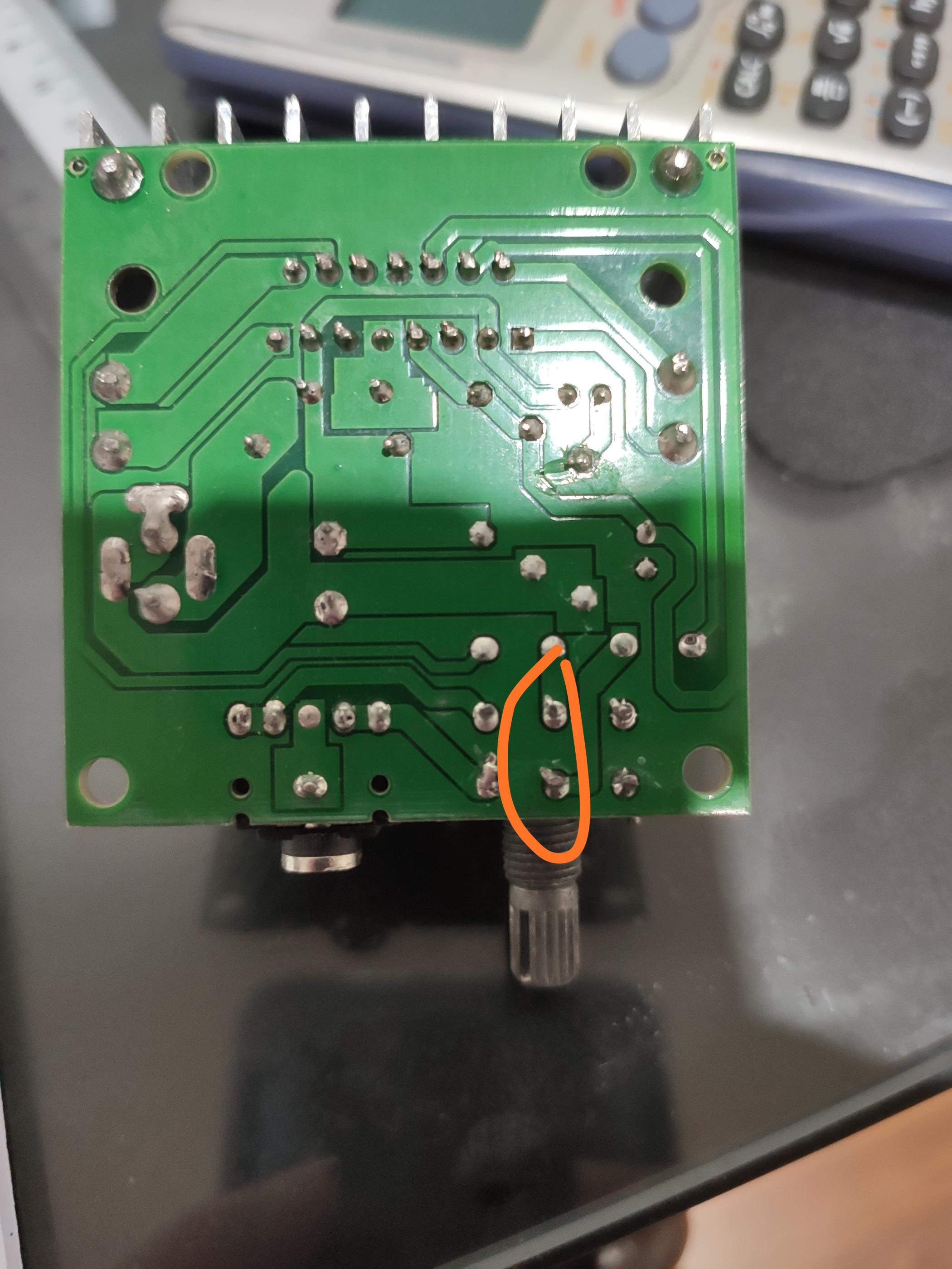

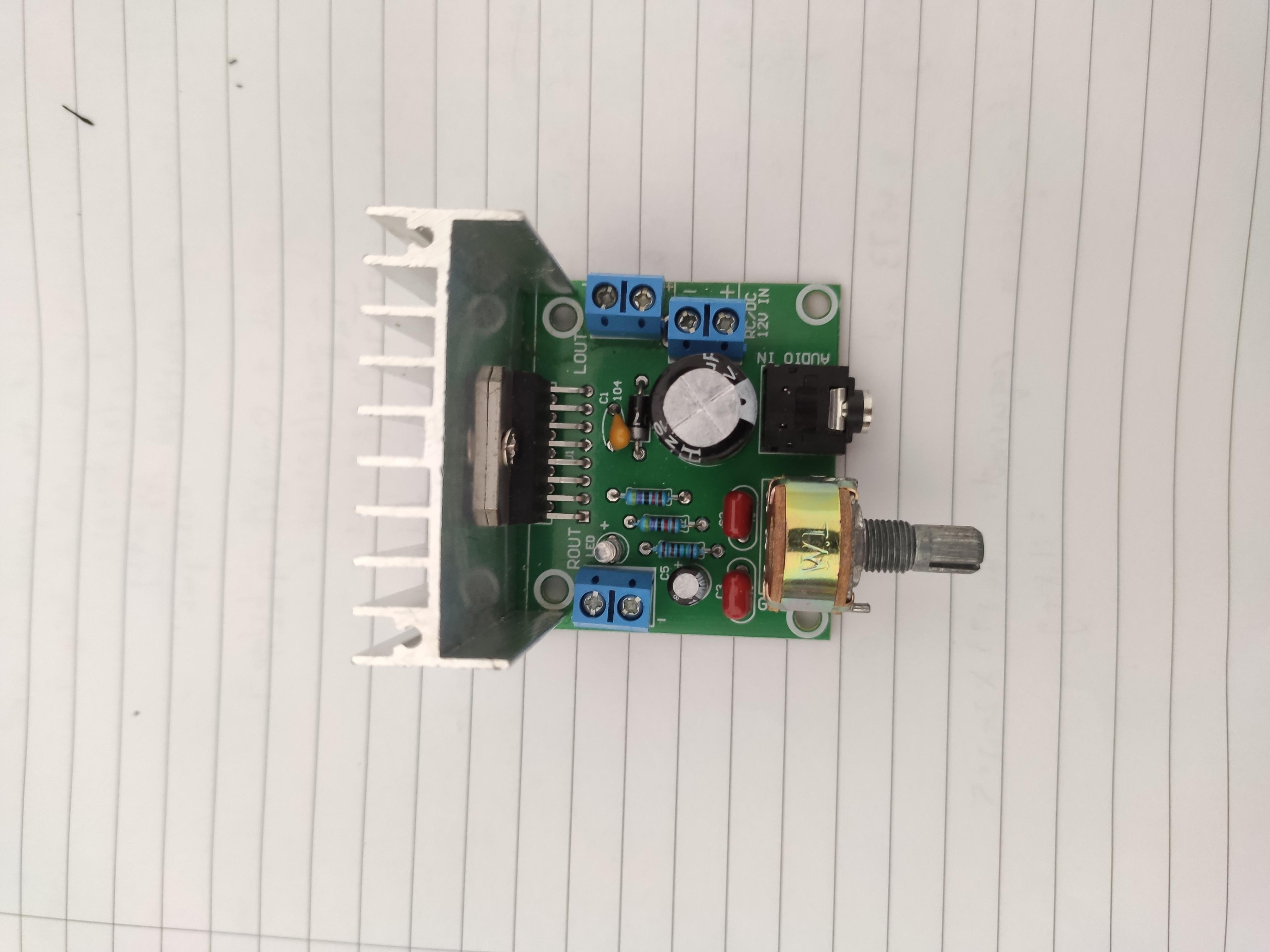

TDA7297 only working on one channel.
Guitar is one channel. You have to "Y" the one signal to the two channels.
Oh I see, how do I "Y" it?

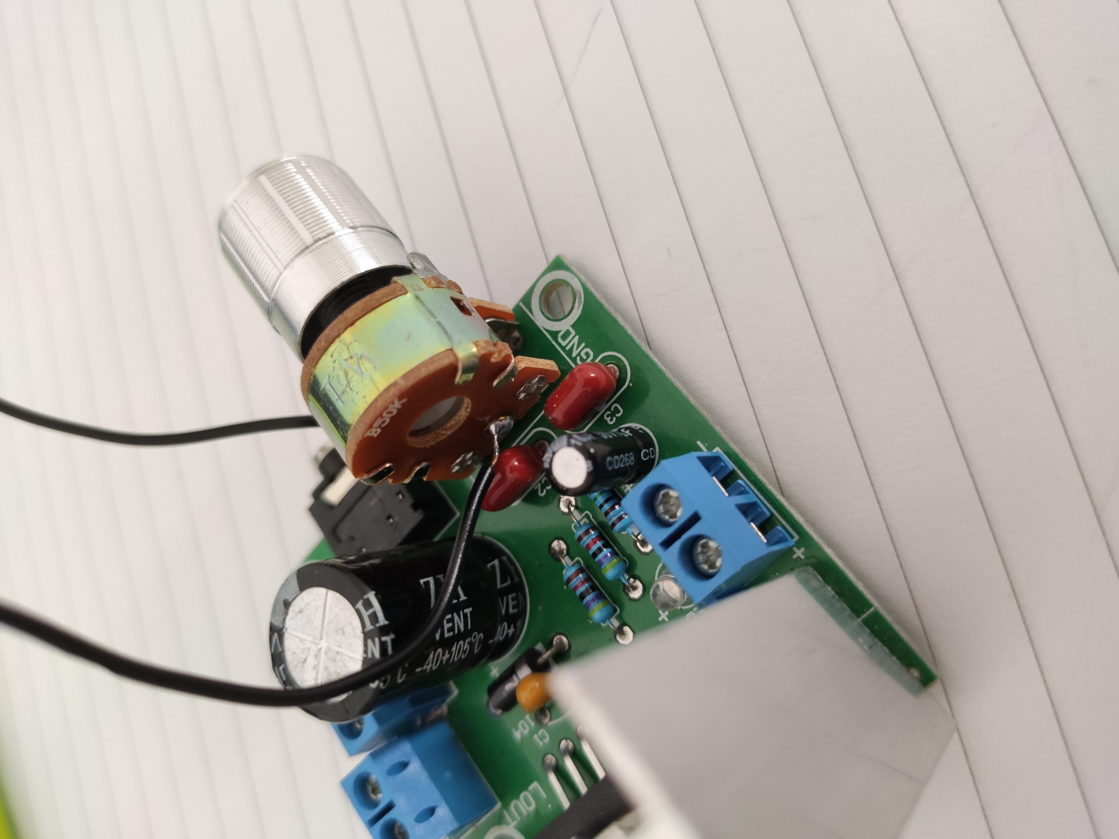

So I can connect wire to each of the middle connections to a switch and flick in when I'm using a guitar for stereo? Are these the connections u are talking about ?
