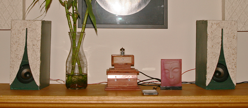

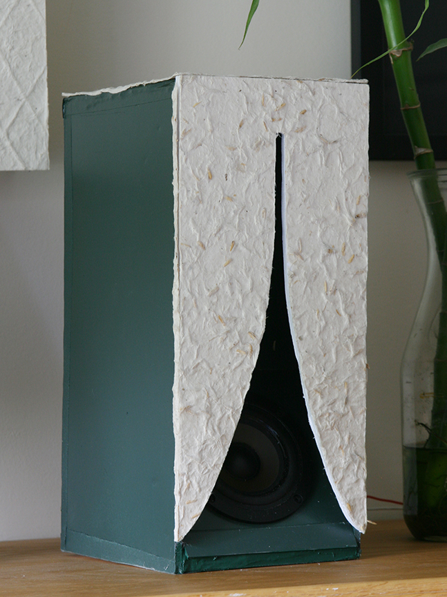

I've built a new stereo comprising a TDA7297 amp and a 12AU7 Valve Cmoy Headphone for preamp. The speakers are a pair of foam core Karlsonators with TB W3-881SJF drivers.
It is really quite remarkable how remarkable this little little set-up sounds.
It was great fun to build- hope you enjoy it 😀

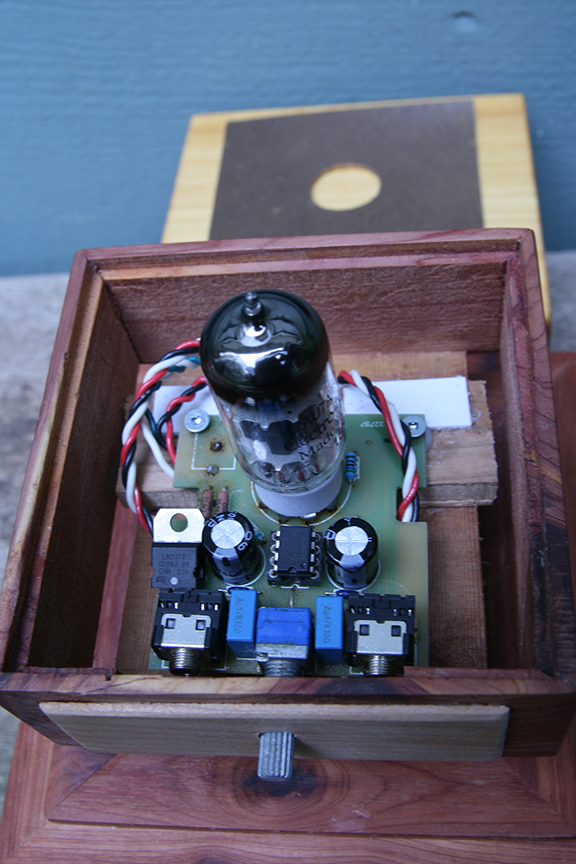

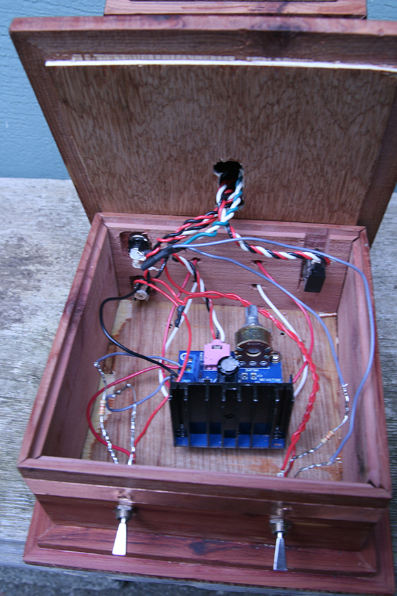

Do you have any photos of the amp and preamp internals? Looks very nice! Glad that it sounds good! The Karlsonator is a remarkable cabinet for sure - one of my favorite full range enclosures with lots of satisfying bass and mid range.

I will take some photos of the inside. The bottom section with the amp in it is a bit of a mess. I couldn't figure out a good way to run the wires inside.

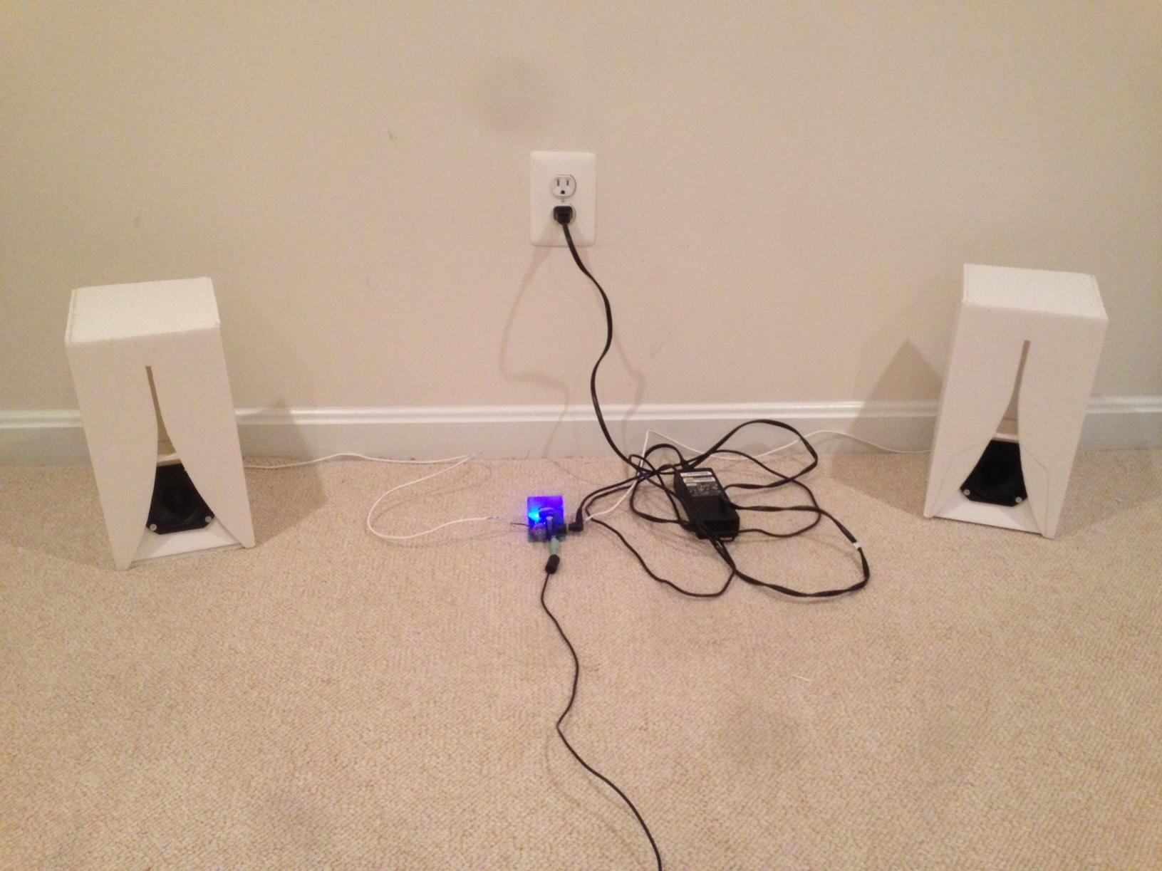

My TDA7297's just arrived from China. $5.36 ea shipping included! It really is a lunch money amp (http://www.diyaudio.com/forums/chip-amps/231988-what-heck-its-less-than-lunch.html) but last a lot longer than 1-meal. I hooked them up to my 0.4x Karlsonators (http://www.diyaudio.com/forums/full-range/239338-mini-karlsonator-0-53x-dual-tc9fds.html) and a 19 volt laptop brick and using my phone as the source. The amp sounds great! Very nice detailed sound, great bass, overall very neutral. I am used to class D amps though and almost burned myself when I picked it up by the heatsink after blasting at high volumes.

I just tried the lunch amp with the 0.53x scale Karlsonators with the dual Vifa TC9FD drivers (91dB efficient), wow! It sounds amazing. There is a certain visceral depth and presence that just grabs and engages you and you want to hear more. This is a bone stock amp and I think improvements are readily available with input caps swapped to poly foil, Panasonic FC power cap, and removal of pot. But even in stock form, I really like the sound.

Here's a few photos of the stupa amp. As you can see the inside of the bottom compartment is a bit of a wiring knight mare 😱

I have not had a chance to do an A/B test with same speakers and same source yet. But initial impression is that it is very nice but you can hear more distortion at higher volumes. The TDA can get about 20 watts at 1% THD with 19 volt PS whereas the TPA3116 can get 40 watts at 0.1% THD. So they are in different class altogether if you push them hard. However, if you play them both at moderate 8 watts/channel they sound quite similar with the TPA appearing to have better bass, clearer highs, and more clarity in general. But at $5, it is an amazing sound that is I would say about 80% of the TPA.

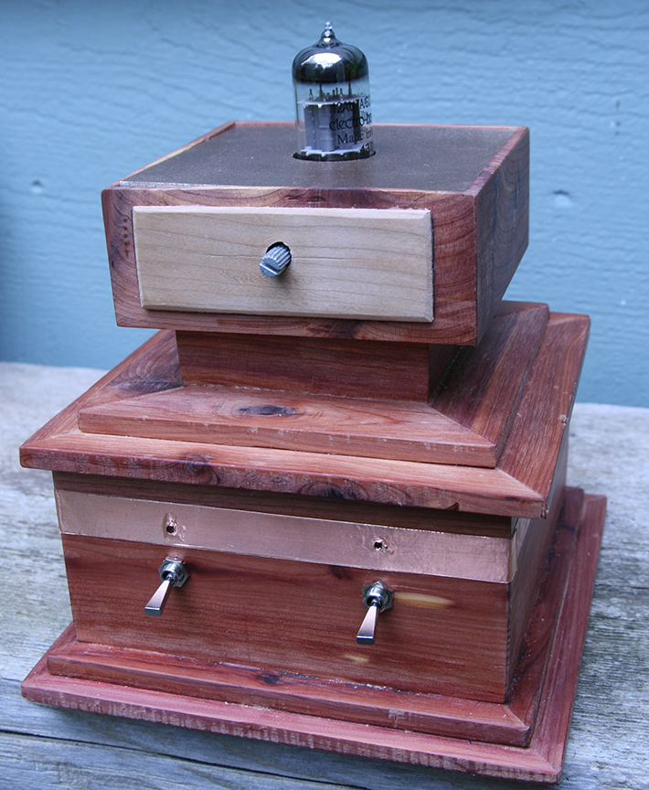

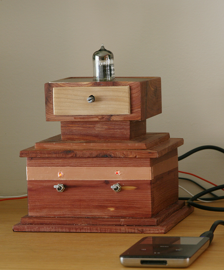

Nice look there Prezden - like a temple in shape. 😀
Does it get too hot under the box with the TDA heat sink?
Thanks X. The design is based on a traditional Buddhist Stupa. Heat has not been a problem with it.
