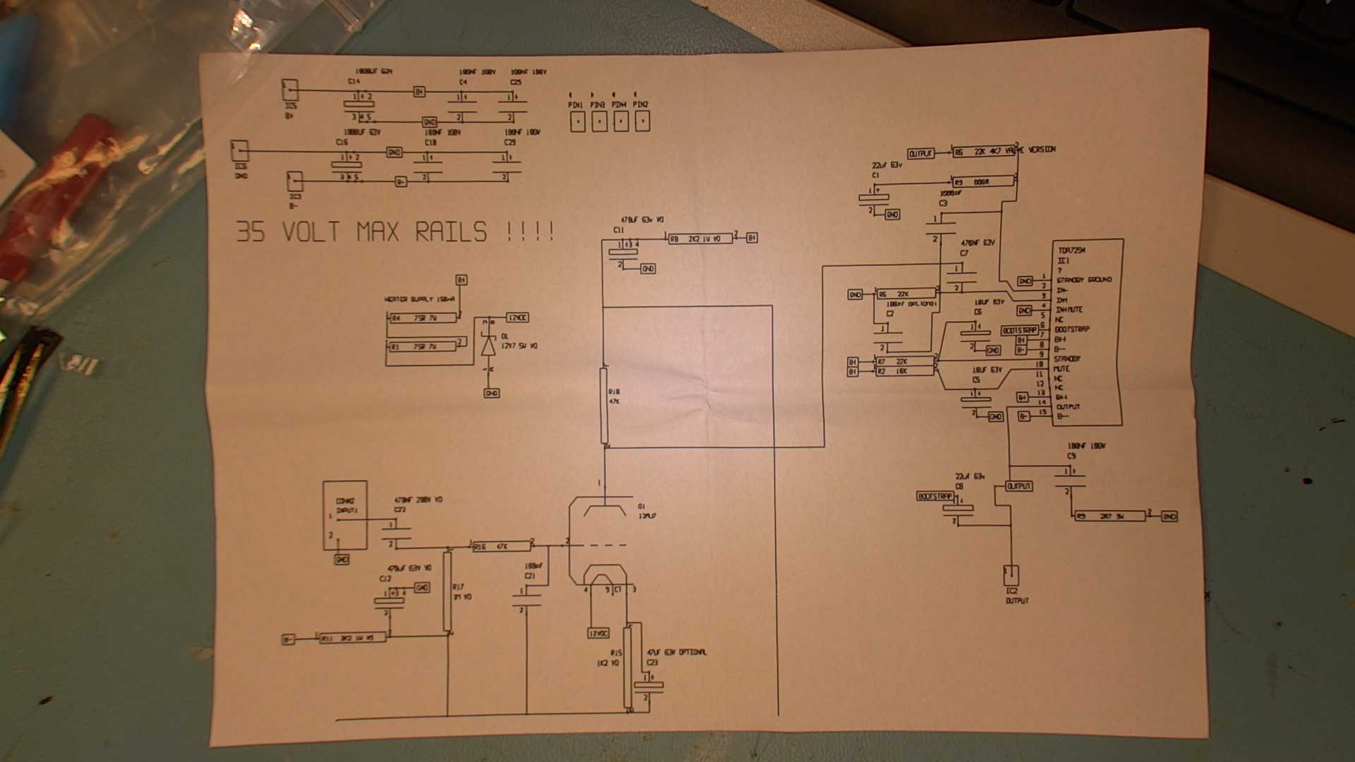

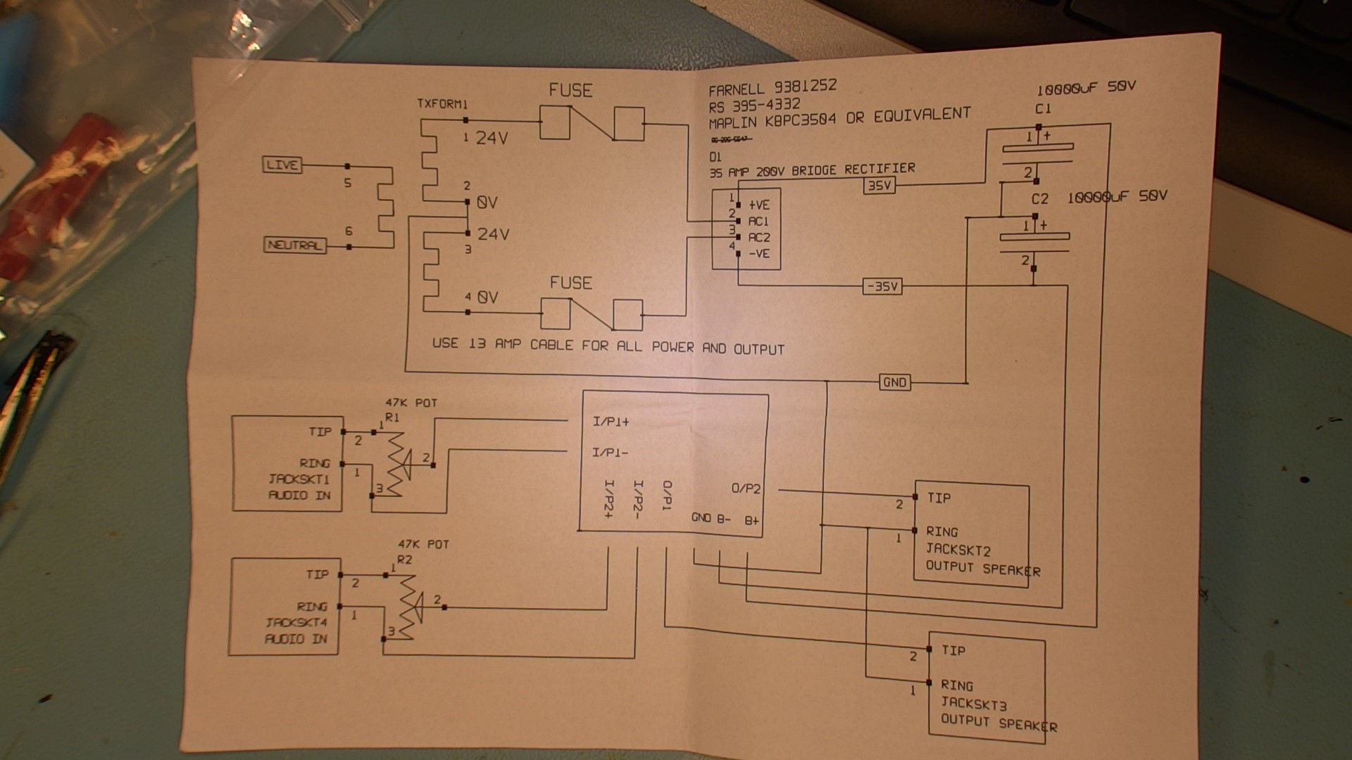

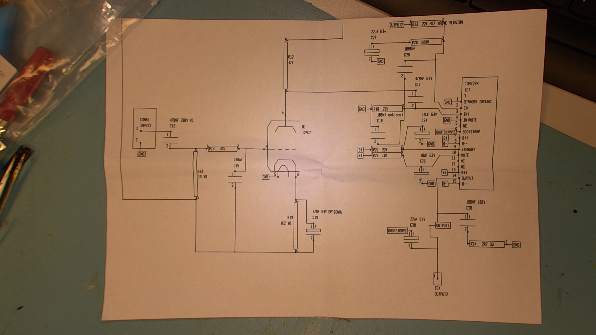

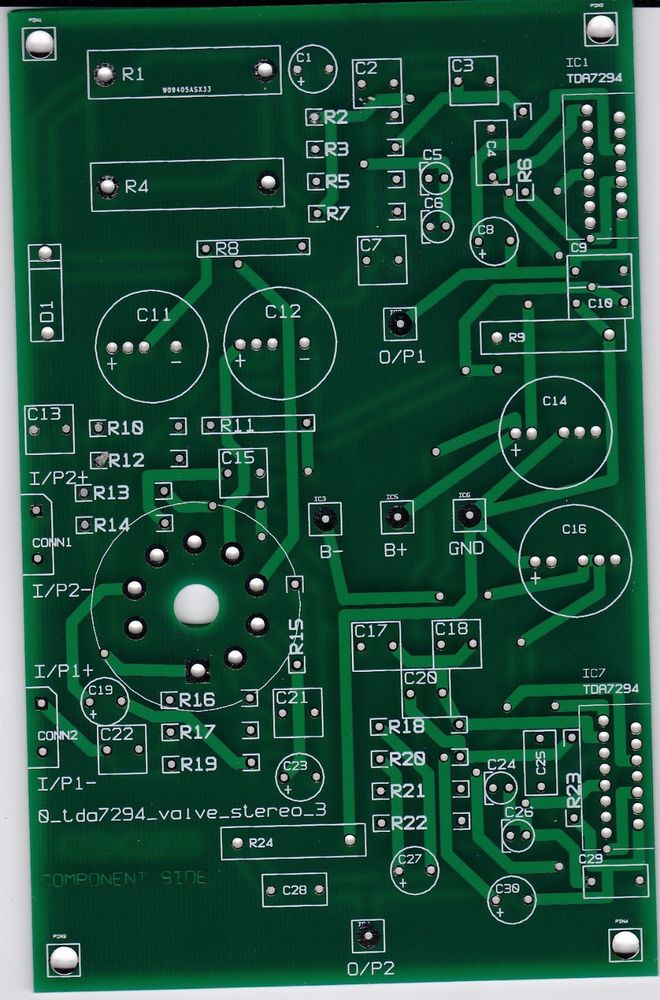

Hey everyone, I'm just getting ready to start a new build with a hybrid amp with 2 x TDA7294 & a 12AU7 valve, before I start I was wandering if therers any improvements that can be made to the components selected in the bom, any advice is greatly appreciated!
The pcb in question:

Circuit diagrams:
