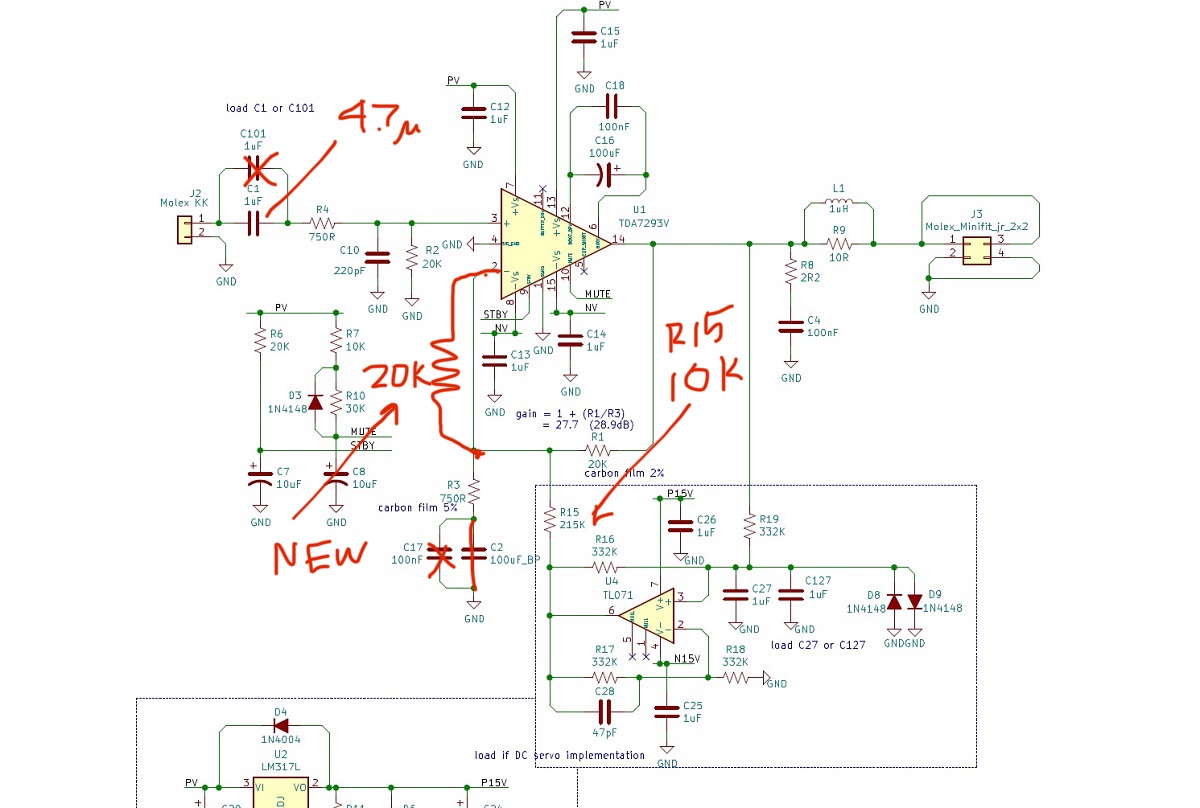

I tested this circuit ±30v(maximum of my lab supply), at 29db gain, chip seems to be stable , I want to see if at ±35v if it oscillate.
This modification uses T Shaped feedback:
Theoretical advantages of T Shaped Feedback is well documented but i noticed a better sound quality.
Special Thanks to @danielwritesbac for extensive work on NFB and gain optimization,
Here, https://www.diyaudio.com/forums/chip-amps/226437-optimizing-tda7294-output-3.html#post3300269
Please Consult Datasheet first, My Drawing can be confusing,
https://www.st.com/resource/en/datasheet/tda7293.pdf
In Feedback , Either choose R1=R2 = 33k and R3 = 1.5K or R1=R2 = 22k and R3 = 1.2K.

Hi Dibya...do you think this T-shaped FB scheme can be implemented on one of your Xmas amp boards after stripping out all the servo components?

I’m thinking...on the Xmas board remove R1, Xmas board R19= new R2, Xmas board D9 = new R3 and Xmas board R16 = new R1. Jumper R15 on the Xmas board.

Hi Turion,
I think you can keep the servo circuit (and all it’s advantages) plus make the following changes to implement the “T” feedback like this:
Cut trace from node of R3/R1 to pin 2. Replace with new carbon film 20k resistor as shown. Do usual change of R15 to 10k to 47k. Change input cap C1 to 4.7uF film.

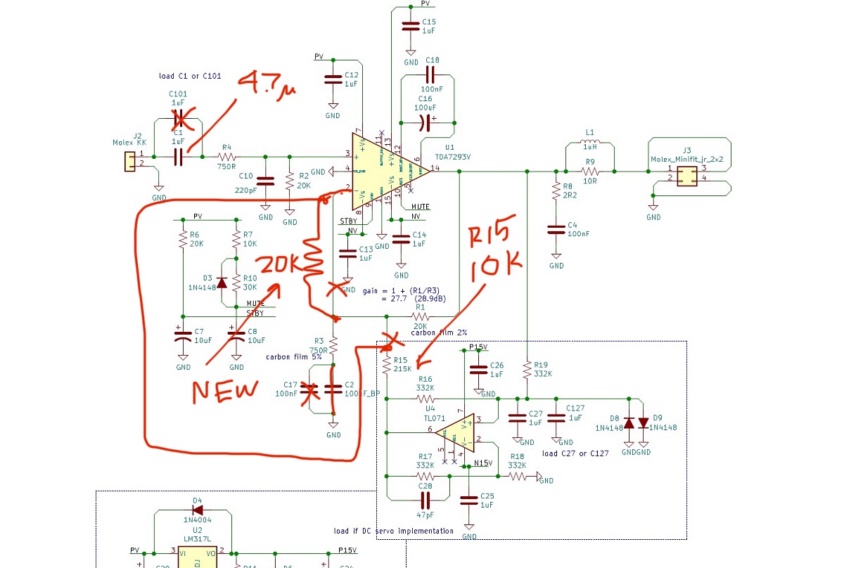

Alternatively, cut feedback R15 at old R3/R1 node and add jumper to bring directly to pin 2.

Looks like I only have to add the new 20K to my one set since R15=10K was already in place as was C1-4.7uF.
Now just to figure out how to get the new resistor in place..hmm

Hi X..did you just change the picture?
Yes, first one was an error and did not see error until I posted. Then deleted it. These later ones are good I think.

You might consider cutting the trace and scraping off solder mask and adding a tiny 0805 SMT resistor in the scraped off pads. Very compact mod that way.

Practicing the trace exposure/cut between R1 & Pin 2 I think my best shot would be mounting the new 20K resistor underneath the board and attaching its leads directly to the lead of R1 (toward the top of the board) to Pin 2 after I cut the PCB lead on the top of the board. I don’t think I can get a good isolated exposure of the track to solder on a 0805 (realistically a 0603 or a 0402 might fit better within the track).
I’m a little confused over the second thought of cutting the R15 node at R3/R1 and using a jumper to Pin 2 since the addition of the new 20K resistor (under the board) will join R15+3+1 to Pin 2 already. Just a better electronic way of bringing in the servo?

I gave the alternate way of connecting the servo straight to pin 2 as way to make sure the servo acts directly on pin 2, versus having to push it through the 20k. Although if we think of the 20k and 10k adding up to 30k, which is still less than 47k it might still work. I am not sure - you will just need to try it I guess.
One word of caution. I have no idea if this will work so do this at your own risk. It might oscillate?
