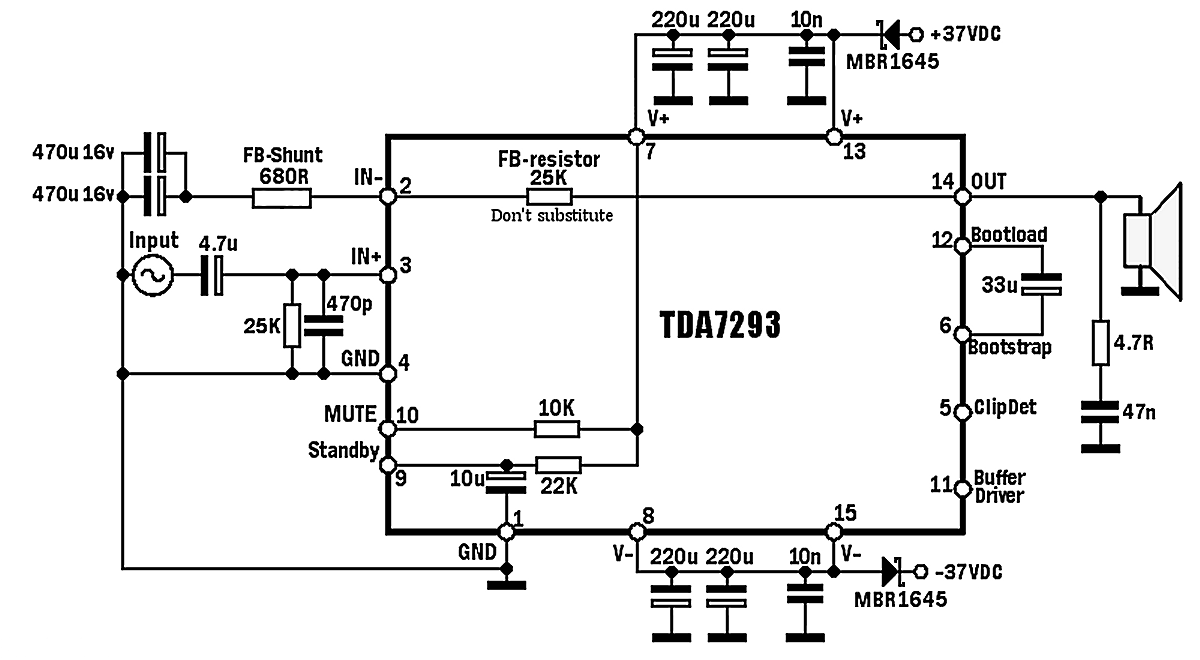

I have bought some PCBs from AliExpress designed for making amps with 2
X TDA7293 each DIY kit TDA7293 Amp Amplifier Bare PCB Board Double Sided Circuit Boards For DIY-in Integrated Circuits from Electronic Components & Supplies on Aliexpress.com | Alibaba Group
The PCBs have very good quality and they have also printed the components they must be used, but only with the names (such as R1, R2,...C1,C2 etc) without any info about values of the components.
I know that I can find in data sheet the right values of components, but before I start to check line by line the pcb I like to ask IF someone have all ready use this PCB and can give me this information.
Thanks in advance and excuse me for any potential spelling or grammar mistake but English is not my language

Daniel has kindly found you some references for choosing component values. My identical board is on its way but evidently I have no experience in populating it yet.
I would say, use the information given in the datasheet such that you adapt the values according to your needs.
- Use the 22uF bootstrap capacitor suggested, you have no basis for estimating a better value.
- Use the 4R7/47nF Zobel network suggested in Daniels first link, you have no basis for estimating a better value.
- Use 100nF polypropylene decoupling capacitors for the small capacitors.
- As electrolytic power decoupling capacitors, use the biggest you can fit in the board with the voltage rating you need (normally 50V).
- Use gain setting resistors such that you have a gain between 10 and 40, preferably 20-30 for good stability.
- Choose the signal capacitors such that your cut-off frequency is around 5Hz.
- For mute and standby inputs, use the values suggested in the datasheet. They should work properly.

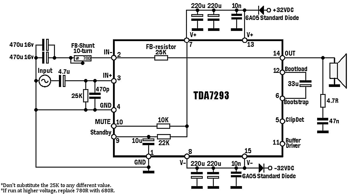

To make that selection process go faster/easier, relocate the gain divider directly on the chip--the feedback resistor right across the chip and the feedback-shunt resistor from the in- to the feedback-shunt-cap by most direct path. On the mini boards, this fits easily.
The decorous location with long traces that the board provides, hinders stability slightly, requiring compensation of higher gain; but/instead, since it is easy to mount those two resistors closer to the chip, the quality boost is not laborious.
Mind that diode! If it is frail, broken, or flipped, the amp explodes. I'd be wanting a part slightly more stout than what comes with the kit.
Ideally 33u, but the datasheet went for more broadly available values.Use the 22uF bootstrap capacitor suggested, you have no basis for estimating a better value.
That can work; however, ceramic is tamer and easier at that locale. Polypro//electro makes for cap selection hardship. That case, the polypro is so efficient that the 100n value is too big. On a very sketchy guess (even for me), I think that 33n polypro might work without causing so much ringing in the electrolytic caps. But, if you're going by the book use ceramic at that specific locale. So, maybe not overspend at that spot.Use 100nF polypropylene decoupling capacitors for the small capacitors.
The bigger the cap, the more difficult it is to find one of relevant quality at small signal locale. So, I respectfully suggest to relocate 'the biggest cap you can fit' to the power supply board (not the amplifier board). I think that a very fortunate choice of low-esr 470u would be the biggest cap you'd like to have on the power rails on your amp board. And, maximum doesn't mean best. This is not a 'gainclone'--your chip is significantly different. View documentation for discrete amplifiers (range is 220u to 470u).As electrolytic power decoupling capacitors, use the biggest you can fit in the board with the voltage rating you need (normally 50V).
With this amp 20 to 42 is the operable range, precisely corresponding to minimum versus maximum power voltage. 20 if bare minimum voltage or 42+ if maximum voltage. If in-between, choose proportionately. That also means: If you want hi-fi then don't maximize voltage.Use gain setting resistors such that you have a gain between.... and 40, preferably 20-30 for good stability

An impressively elaborate reply. That will give most of us guidance in designing amplifiers with TDA7293.

Not interfering with Daniel´s excellent advice, 🙂 , just adding some practical use comments: many problems come from datasheet calling it a "100V - 100W" amplifier which it is not and people trying to reach that.
Its case is exact same as LM3886 so no way it can reliably dissipate more heat than its cousin, thermal resistance to heat sink is the same.
IF you use it "as an LM3886" class device, in this case with no more than +/-35V rails and pulling no more than 70W RMS ... by the way as suggested in datasheet body ..... , then it´s quite reliable.

To answer the question if TDA7293 is as problematic as some forum members claim, that answer is yes; if one used the online advices for LM3886 with a TDA7293, the result is disastrous, because those two chips are very different and because TDA7293's documentation is less effective (junk schematics, good text).
However, you can use the documentation and applications for an equivalent basic fet output discrete amplifier with TDA7293, and that works very well.
I would also suggest no more than +/-33vdc rails, because at the lower voltage you don't have to run the gain up so high to stabilize it. Sure it can run at higher, but there's workarounds and labor that aren't needed at lower voltage. It would just be more straightforward at the lower voltage.
