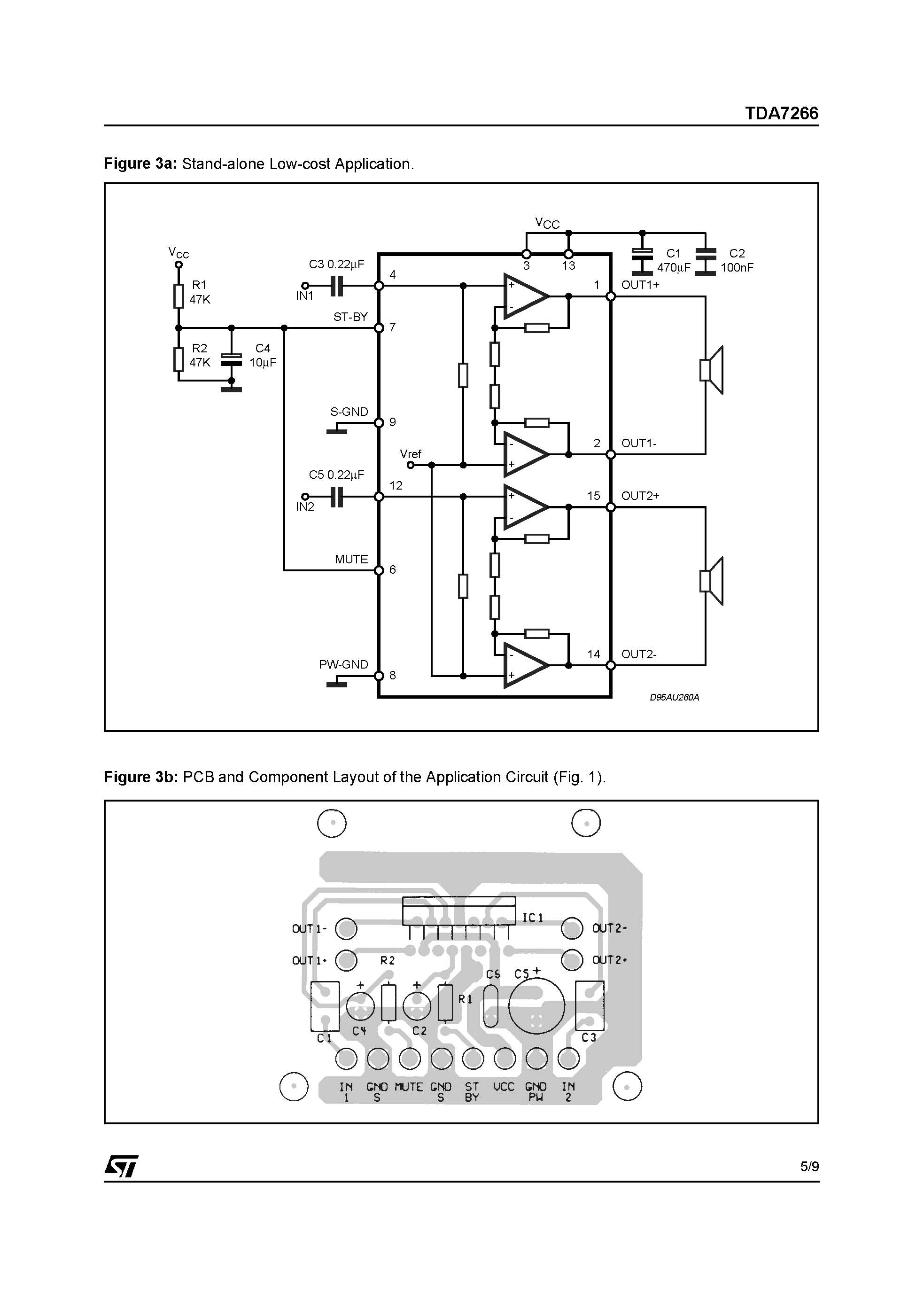

So I got three TDA 7266s from the sample order program, and I've tried to wire them according to the schematic, I'm using a 12v-0 power supply(wall wart) and I can't seem to get this thing to turn on, it's getting power to 3 and 13, and it gets power to the stby/mute pins as well.
I can't seem to figure out what could be wrong, it's like if it doesn't work at all, could it be that the chips were damaged or something? or am I missing something in the schematic? This is the schematic I used.
Quick question - do you have half the supply voltage at the outputs (1 + 2, and 14 + 15)? Does the heat sink get hot? Only other suggestion is to check carefully for solder bridges. Circuit is simple enough, it should work. Good luck.

I've had a look at the datasheet here;
http://www.st.com/internet/com/TECHNICAL_RESOURCES/TECHNICAL_LITERATURE/DATASHEET/CD00000203.pdf
where you will find your circuit on page 5.
I would simply switch your circuit on and assuming any heat sink you have doesn't immediately start glowing, check your voltages as follows;
Pin
3, 13...................+12v
8, 9........................0v
1, 2, 14, 15............+6v (use some kind of load if not speakers, i.e. a 1k resistor).
4, 12.....................not sure but should be whatever Vref is. (couldn't find it in datasheet)
6, 7.......................starts at 0v and ramps to +6v in about 0.5 sec. (might be clamped internally, so perhaps won't reach +6v)
If these voltages are correct, then the amp should be running.
I would suggest that to measure 4, 12, you should short In1 and In2 to ground via a couple of 1k resistors, without any other input.
There's nothing fancy about this device, so if the voltages above are confirmed but you still get no output with an input signal applied then logically, the chip is faulty.

Ok, thank you so much, I didn't really know how to test chips of this nature, I'm still learning as I go, as far as heat, no it's cold as ice, all 3 of them are.

I did have one other question about this chip, can I make it a 14w mono amp? I didn't see a recommended schematic in the list, so I was curious.
Also, how would I go about getting some of those reference boards in the datasheet made? do I just make them myself(try to anyway 😀)
This chip is ALREADY a bridged amp, so basically no chance of doing what you're suggesting.
Have a look here;
Bridged and paralleled amplifiers - Wikipedia, the free encyclopedia
As to the PCB shown in the datasheet, I reckon you'll have to make it yourself. It's a pretty simple board, so should be easy.
