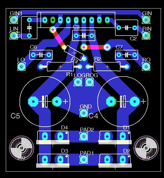

I'm laying out a small pcb for a tda2616 (I know Velleman makes a kit for it, but I don't like it) and I stumbled upon a quite basic question... what am I to do with the mute input (pin2) ? I've had a look on multiple schematics and some tie it to ground, some let it floating. A bit confusing.
The datasheet isn't very clear to me but maybe is it just me

Thanks for any help on this.

Simply do not connect the Mute pin. Floating works, connecting it to V+ via a 10 kOhm resistor also is OK. When drawn "low" the chip will mute. Can be a nice solution if you leave the amp powered on, using the mute pin will disconnect inputs so less noise and/or unwanted sounds (when not used). You can see it as a kind of standby function then. Power consumption won't change however.
BTW block diagram on page 3 of the data sheet is wrong. The switch in the middle of course switches both channels to mute ! Should be a double switch in the drawing.

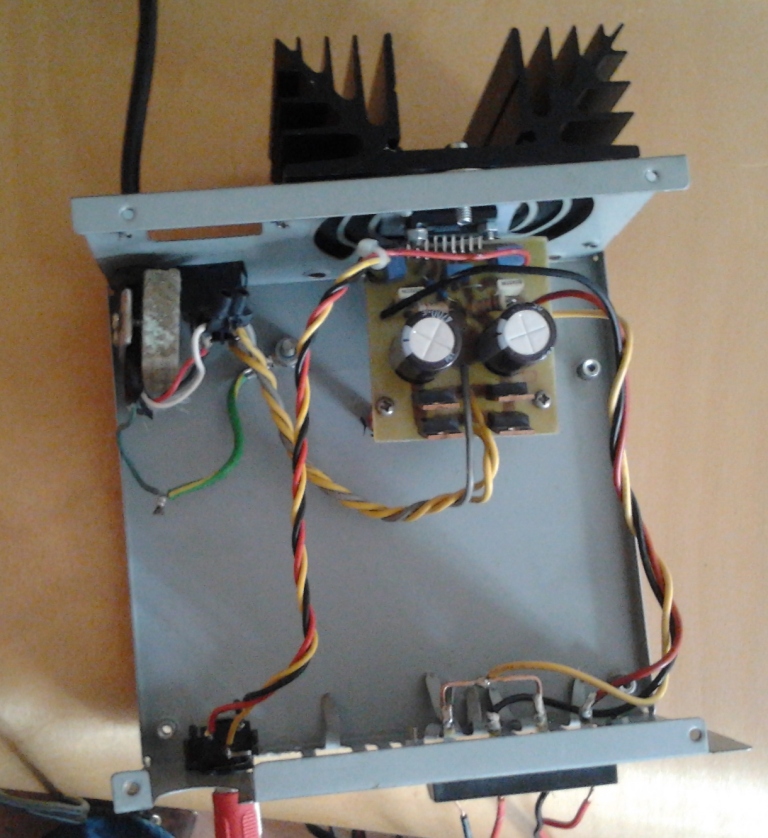

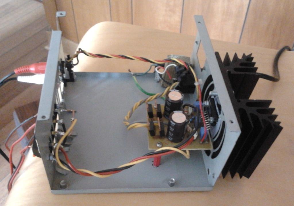

Here's the finished unit. Fairly basic, powered by an old printer's wallwart (2*10VAC/40VA).
Paired with some speakers coming from a broken Denon mini-system, it sounds pretty decent as an office system.
