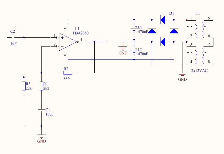

This is my build project for a small gainclone.
Will be around 10W RMS into 8 Ohm and around 15 Watt for 4 Ohm.
Regulated LM317/LM337supply with bypass MJE15030/31 will be only like 2x15VDC.
I am leaning towards using TDA2050, but LM1875 is a good option, too.
Any thoughts about what is to be prefered?
Or does it not matter TDA2050/LM1875?
The TDA is obsolete and could produce up to 50Watts, Music Power for 1 second! Primarily designed for 'old school' car radios.
The LM is currently produced and can sit at 30Watts with a +-25volt supply.
If a balanced supply is used, ripple rejection is excellent so no need for regulation. Good thermal and over current protection is within the chip.
So then I make it one LM1875.
I have think about the regulation or not.
Without regulation I can take 2x12VAC toroid transformer.
As there will not a 2.5-3 volt drop across voltage regulation.
Also is a considerably simple circuit. Easier to build.

I think I go ffor the TDA2050, as my thoughts were from beginning.
I prefer this chip to the LM1875
This is what I will build.
As told my target is 16W into 4 Ohm and 10W inot 8 Ohm.
My speakers are 4 Ohm.
I will also put a Zobel network on output. 100nF+4R7.
Also a wirewound inductor across a 10 Ohm resistor in series with output.
