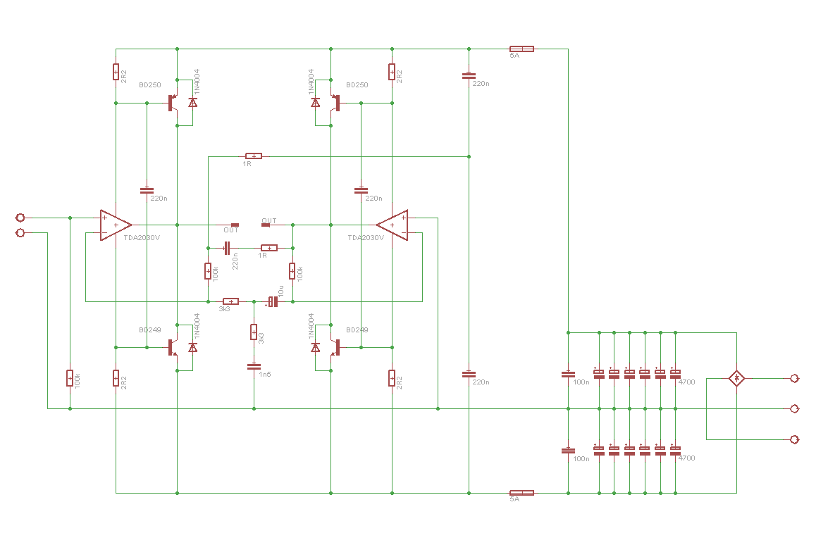

The 100 W BTL with 2*tda2030A plus 2*BD249/2*BD250 allows more
headroom to be used , thou . 😱😛🙄

The 100 W BTL with 2*tda2030A plus 2*BD249/2*BD250 allows more headroom to be used , thou . 😱😛🙄
Remind me of some car audio guys where SPL is to them more important than sound quality (THD). I have never interested in BTL. If I want more watts I use different amp (discrete if necessary) 😛
Something like this? 😀
