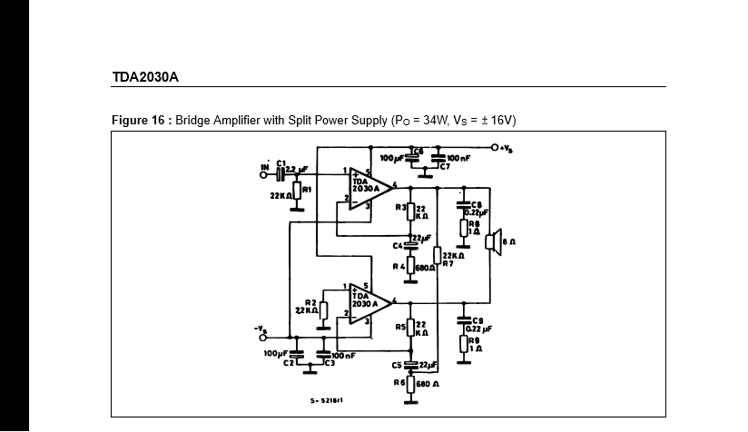

I am making a stereo amplifier using tda2030a in bridge mode(using 4 tda2030a ) and I want to gain 34w+34w =68w output approx.Please suggest me power supply layout for this. I am having 12-0-12 ---5amp transformer. Will it be sufficient or not. Also tell me whether regulation be needed in power supply or not.

12V rectified will give you approximately 16Vdc lightly loaded.
This is well away from the +/- 22V maximum for the TDA2030.
Regulation will get a cleaner supply but limit your maximum power to less than what you would get without it.
You probably won't get your 34W + 34W because of the limits of your power supply.
Probably more like 20W + 20W.
Power supply ripple rejection is only 54dB. But you are using a bridge configuration.
I would say build it without regulation and test it to see if there are issues.
Let us know what the results are.

"A" series has some pretty good performances, such as 150Khz power band, but suffer from a defect in the project. we call them "tweeter destructor" becouse,when switching in current protection, the final stage emits sine wave of maximum amplitude, at a frequency of 220-270Khz. just a time for destruct the TW,before destroy the chip. 🙂 can be measured well this strange behavior.

The 2030 is not feasible to use as a bridge amp in this way. Assuming you had the +/- 20V supplies. that would allow about a 35V peak voltage swing. The part does not have enough available current drive to do that into a typical 4 Ohm speaker or even an 8 Ohm speaker.I am making a stereo amplifier using tda2030a in bridge mode(using 4 tda2030a ) and I want to gain 34w+34w =68w output approx.Please suggest me power supply layout for this. I am having 12-0-12 ---5amp transformer. Will it be sufficient or not. Also tell me whether regulation be needed in power supply or not.

Is that the current-limiters oscillating due to the way the negative stage is driven? Or will it happen with any bridged 2030?
😕 I have also made this circuit but after few days both ICs burned out. Do you know what the reason is for that? 😕
Short answer: No
Longer answer: There must be a cause that could be found if all of the circumstances of your build and use was know...we need more details.
I have built this circuit . Using it with a pair of book shelf speakers 8ohms. 18-0-18 3 amp transformer. I had got the PCB ready made locally , paid about $0.30 for both channels(pcb only parts I had) . I recently replaced the tda2030a with tda2050. It sounds much warmer(and nicer) with the tda2050.
