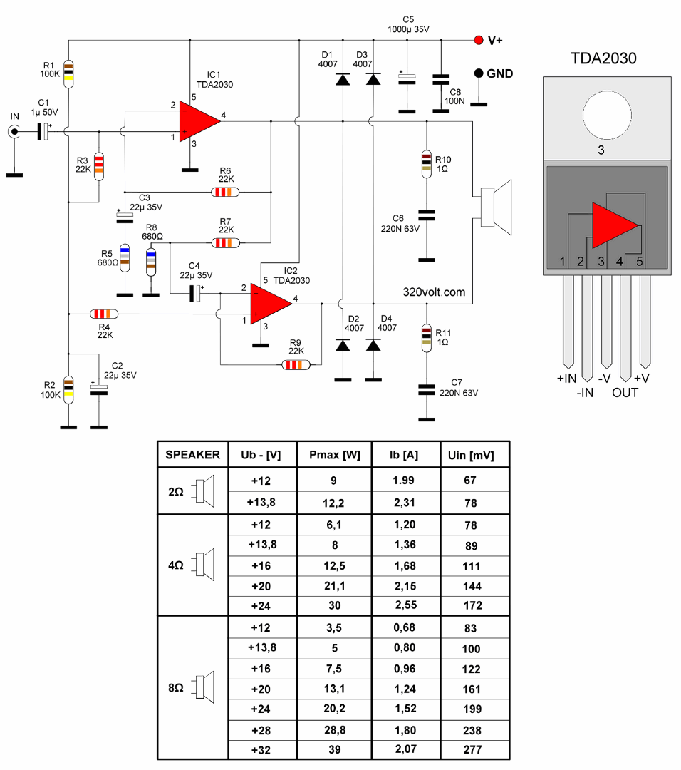

Hello, TDA2030 Bridge connection. More power with 2 integrated single source 12V-32V.
Thanks.
Interesting project, easy to build, very usable, .
It only lacks PCB data, both laser printable artwork and a Gerber for those who outsource to China.
Plus power supply data.
Can it be turned to basic current feedback?
