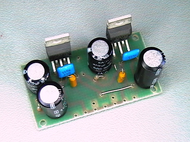

A simple question: I've a pcb for TDA2003...could I use it to mount a TDA2008 instead of the TDA2003?
I would use it with a transformer + rectifier circuit.
Thank you so much in advance for the patience!😉🙂

Please guys, I need your opinion before I purchase item in the picture below:worship::
The question is the following:
if I replace the two original TDA2003 (on the amp board of the picture below)with two TDA2008, does it work? or could I have problem doing this ICs change?😕
Please help me!:worship:
Thank you in advance😉
Regards!:wave:

If you see the picture, you'll notice two 1000uF capcitors (the biggest ones): they're the output coupling capacitors.
My question is: Can I get a low frequency increase if I replace them with two 2200uF capacitors?
And just a last question: I'll feed this amp board with a 18V power supply (so it will be 25 V after the rectifier circuit)...Have I to change other elements on the pcb ( a part of the Volt values of the electrolitc capacitors)?
Thank you so much for your kindness!🙂
Just make sure to upgrade those electrolytics caps to 35V or 50V. Thats it and make sure not to exceed the chip maximum voltage
good luck
......yes,2200uF makes sense with a 4 ohm load.
..........a psu with 18Vdc (after rectifier) would be recommended.
why not look into the datasheet?
ST Microelectronics - datasheet pdf
as you can read in the datasheet the frequency response of the circuits is 40 Hz to 15 kHz
which isn`t up to date, they were designed for Lo-Fi use in cars or cheap cassette recorders. The output capacitor together with the 4 or 8 Ohm speaker are building a high pass filter to reproduce a frequency of 40Hz you need a capacitor of 950uF with a 4 Ohm speaker or a cap of 500 uF with a 8 Ohm speaker. That means a 1.000uF as in the datasheet will do the job.To have a little headroom and prevent aging issues you can use 2.200uF but 8.200uF doesn't make sense the circuits aren't capable of reproducing this low frequency on the output. I fyou only want to play around with the board using the TDAs is OK, but there are much better integrated amps to buy for little money , i.e. LM3886 or TDA7497 both classic AB amps and not class D.
