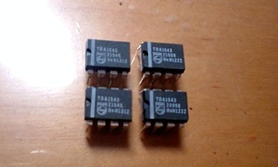

I have several TDA1543 dac with logo Philips, NPX, only Philips.
I use the Mini 1543 dac that use the Philips dac
When I change the dac for other 1543 only noise.
Are the other dac fake or are there several different type's
Thx

I have a similiar problem with the nxp marked TDA 1543 chip.
see my post here
http://www.diyaudio.com/forums/digital-line-level/259097-real-tda-1543-a.html
I sourced the chip from adeleparts , ebay.
Where do you source the TDA 1543 ?
manage to solve the problem yet ?
I am planning to change the value of the I ref and output resistors to try .
I have no luck with 1K I ref and 1.5 K IV resistor .
i get white noise that you hear in between FM stations

both with the same noise, the one with Philips logo if you start the music you hear an few seconds music then noise
still no original tda 1543 found
@Jempie , Bella Audio sell TDA1543 at Rp 35.000
Didiet
I have ask him, but no success

Two types. TDA1543 and TDA1543A
tda1543——i2s type with dip8 package
tda1543a——rj type with dip8
tda1543t——i2s with sop16 package
philips logo——older type
nxp logo——new type (nxp is philips ic company)
