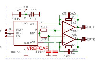

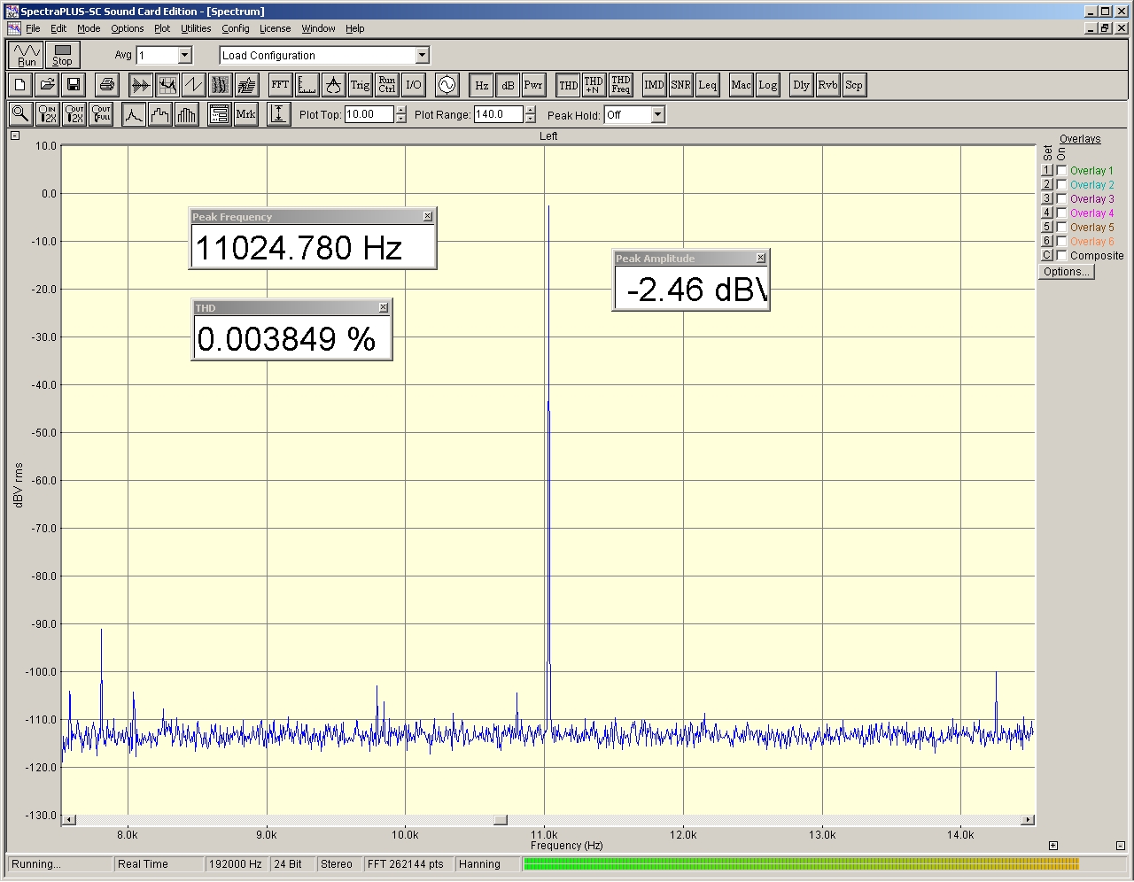

Hello, I've implemented on breadboard the following TDA1543 (3 in parallel) circuit with very good sonic results, but I have hi-speed opamp oscillating (even if unity gain stable).
No Vref resistor to ground was needed.
I suspect to have too long wires (> 15 cm) between TDA1543 outputs and IV opamp.
The oscillation stops if I put a vref capacitor of 10nF (min) between V+ (Vref) and ground.
I tried also 100nF, 1uF, 100uF, which work ok but the sound is more "airy" between 10nF and 100nF
If I put less vref cap (<10nF), hi slew rate opamps start to oscillate (the slow ones still work ok, even without cap).
I don't see similar "vref-to ground" cap in any IV active schematic, so I'm asking to you any comment on this issue and benefit to have it.

The 'airy' sound is probably from it ringing or oscillating intermittently, not a reliable state of affairs for a final circuit. Adding caps to Vref basically acts as a low pass filter, not necessarily a bad thing for Vref. If you need to use caps there probably they should be big enough to fully stop all oscillation and any related symptoms.
Thanks for the reply. "Adding caps to Vref basically acts as a low pass filter" I immagine not for the audio signal, but to clean from RF Power supply. Correct?
Even if, no way, I continue to prefer the 10 nF cap over 100nF and more...

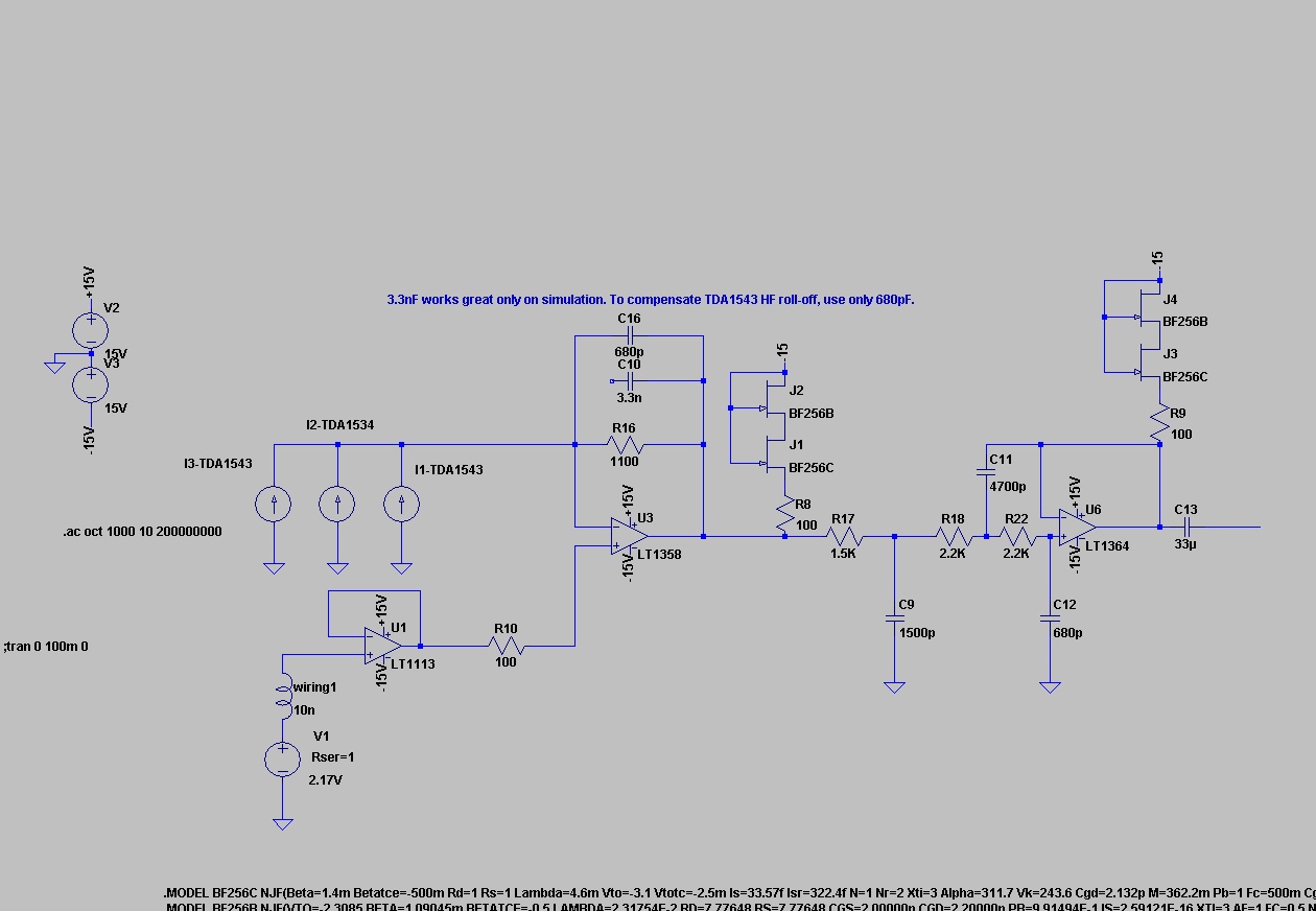

On simulation nothing changes by changing VREF cap.
Unfortunately datasheet doesn't say too much for Vref and the only circuit I see with Vref capacitor to ground over internet is applied to TDA1545 page 4 and never on TDA1543.

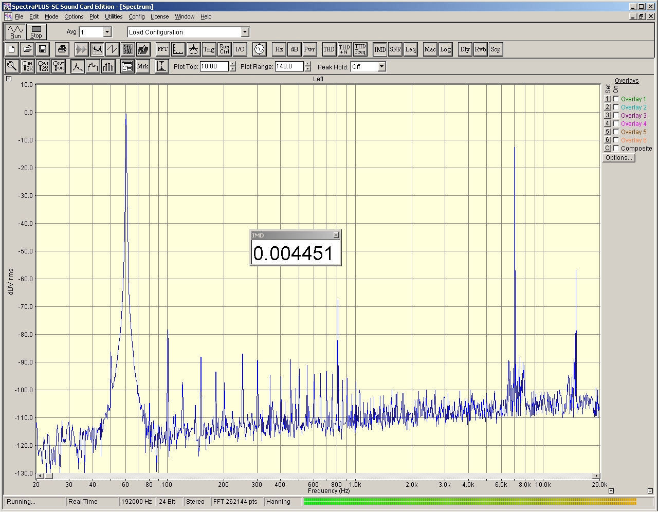

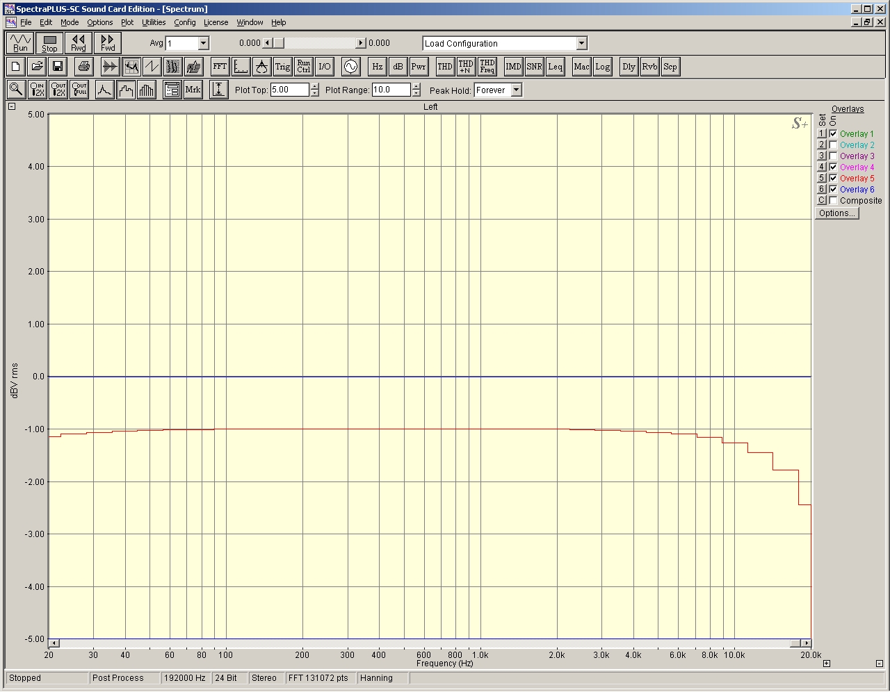

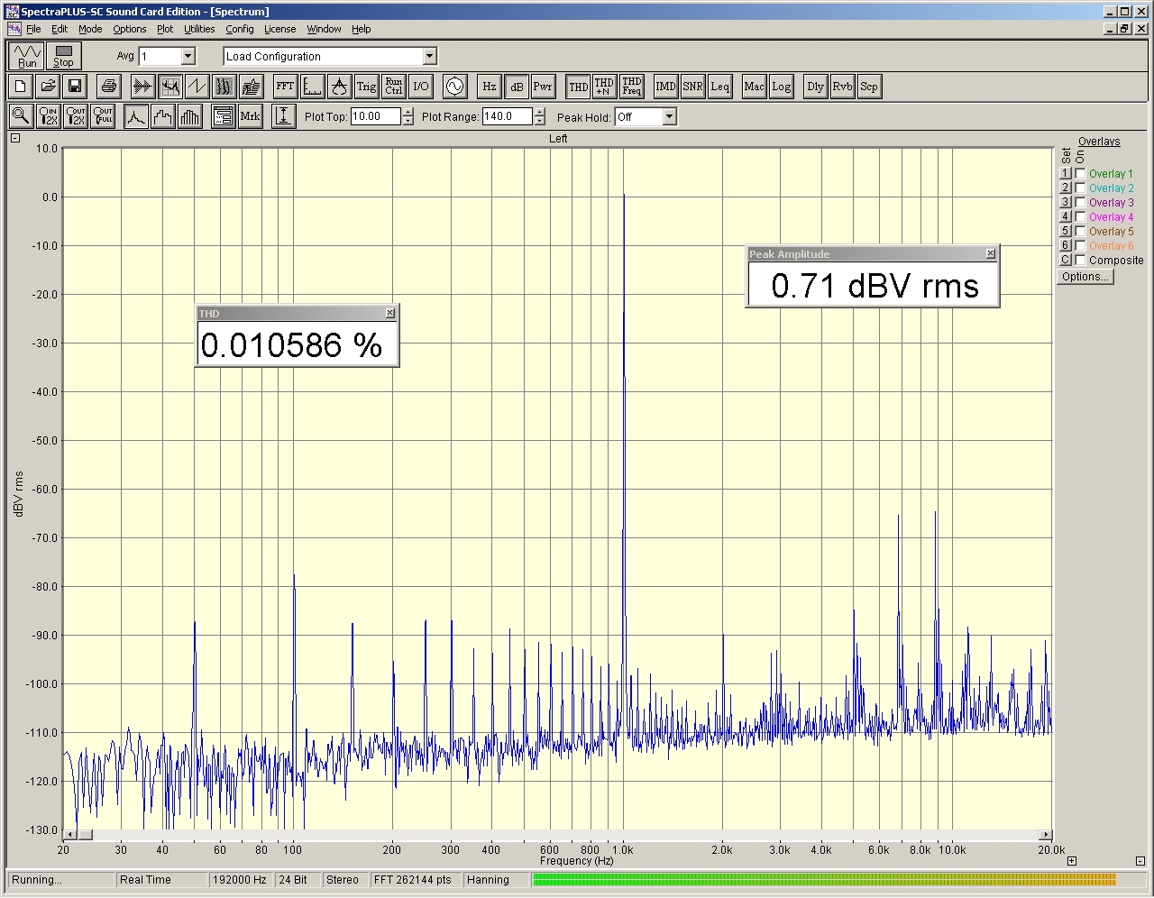

It is a pity for me not to understand this RF issue as measurements (with 100nF) and listening tests are very satisfying to me even with this messy layout and very poor power supply. see graph.

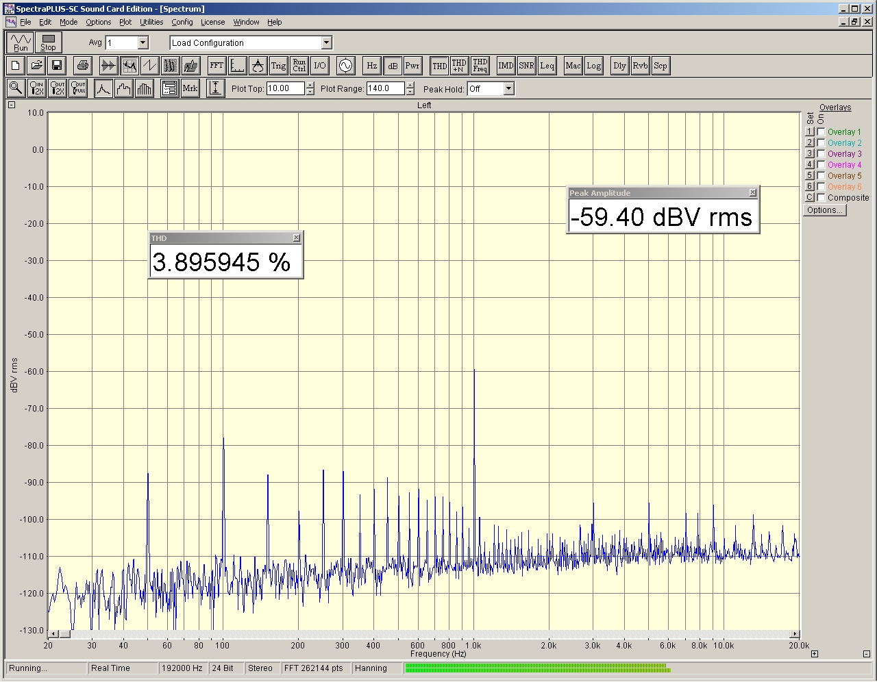

Since Vref connects to the non-inverting input of the opamp, maybe you are getting some positive feedback from the loose wiring. Cleaning up the wiring might fix it.

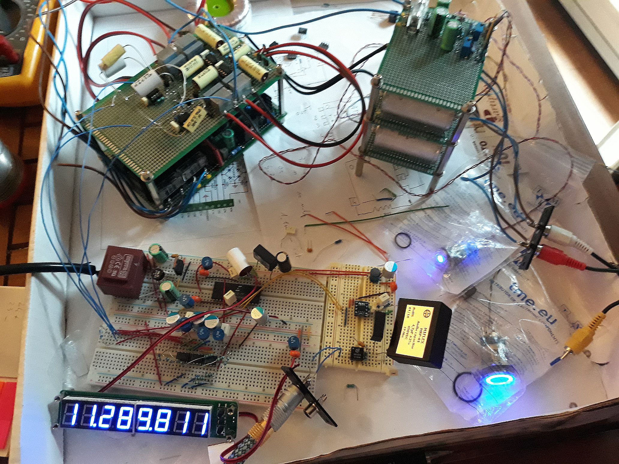

Please learn how to design PCB's and/or single board designs and avoid such wiring. It saves time and gives better results.
You are right but before soldering a PCB or a good perfboard, I need to try and test which is the "best" sounding circuitry.
I know but it is debatable if one can discern differences in a setup like that. After having redesigned a PCB tens of times your approach clearly also has its merits 😉

Putting a cap on Vref will probably turn the two 100 ohm resistors into resistive damping for the UHF resonators (i.e. wires) you have attached to the opamp inputs.

Thanks for this input. I tested with LT1113 very close to LT1358 (like in the attached scheme) and ...it works! No more oscillation even with an even more additional "shitty" wiring.....

The breadboard is not suitable for DAC. Even those universal test board are not recommended either. I use test board for I/V & buffer. I got weird THD+N as the result.
