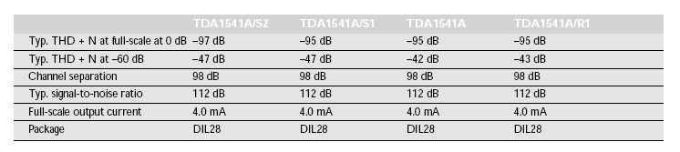

I've heard static damaged TDA1541As described as sounding grey (whatever that means). I would expect static damage to the analog part of the chip to result in an incremental loss of linearity. Since the TDA1541A S2 is a regular TDA1541A selected at final testing for higher than average linearity, I don't think that expecting a static damaged S2 to sound like a regular grade chip is so far fetched.
But SY could be quite right, I have heard both sides of this argument from forumites I respect. I haven't heard an S2 (nor even an S1), so I can't comment. However, Philips set out in black and white that the THD+N of an S2 is lower.
