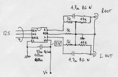

You don't really have to redo anyting. Here's how complete TDA1543 circuit is looking like, including PS: 1 chip, 5 resistors and 2 caps. You can build it in one hour😉
Even without reclocking it sounds amazingly good. A friend of mine listening to it, commented that it's better than Copland and I know for myself, that it's better than Bel Canto.

As much as you show on the pic this is a much simppler circuit than what Elso suggested as an output stage!!
Which circuit are you following?
Is the DAC a special selection?

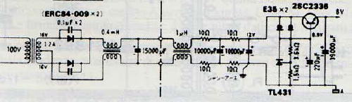

Wow! that's so simple.
I wonder about the detail of this circuit, please... :>

Thanks for the posted circuits.
I understand that the 1543 is considered by Philips as a budget DAC but I wonder if there are some special selections?
Heard also you built a multichip version a la Kusunoki but you seem to preffer the single chip?

Sometimes budget chips are better, because of simpler design. And I found out, that simple circuits usually work better. I tried 4 chips and 2 chips in parallell with different voltages and clearly a single one with 5V supply works best. More resoulution, smoother and relaxed. I also tried Lundahl transformers at the output, but they definitely degraded the sound. A friend of mine tried those transformers at the output of oversampling DAC (SF DAC1) and he was raving about them.
Actually I can't complain much about that circuit. It only needs more extention in HF, more soundstage and slightly improved tonal balance. When this is achieved, it will be a very good DAC. I compared it to modified high end one box player (which supposed to be one of the best currently) and this little DAC was still a match. Looking at simlicity and investment, I'd say, it's not bad😉
