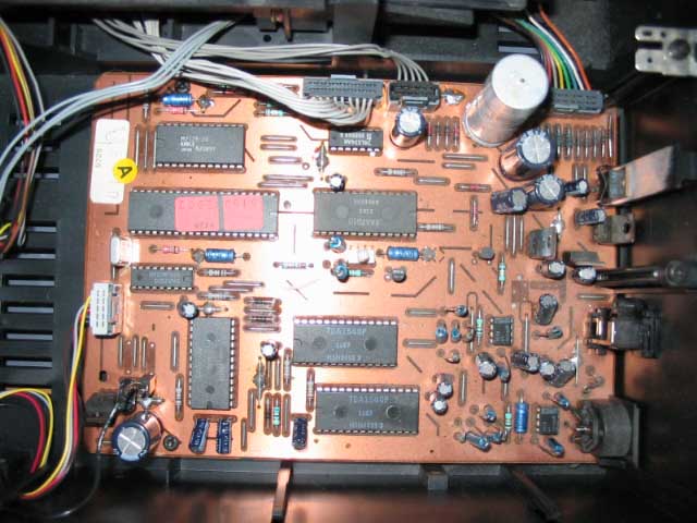

TDA1540P Chip's
Picture of the dual dac's..
Output caps are electrolytics, you could replace with 10µ MKP, also supply decoupling caps on op amps. NE5532 or LM833 ?
This is chippo chippo cheap cheap, I guess with cdm4 and weak PSU.
But 14bit sounds very tube-like.
Try to get a cd304 /mkII...
