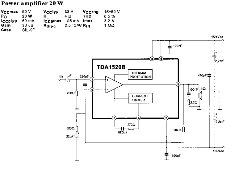

Here's what I could find from the TDA1520. It's the same IC, except: TDA1512: HiFi NF-E, 35V, 3,2A, 25W(32V/4ohm) TDA1520: HiFi NF-E, 44V, 4A, 22W(33V/4ohm) TDA1520B: = TDA1520 50V, RthG=2.5)°C/W /Hugo
future Member Joined 2003 2003-05-24 3:01 am #3 2003-05-24 3:01 am #3 Thank you, I was looking for this for a long time.
