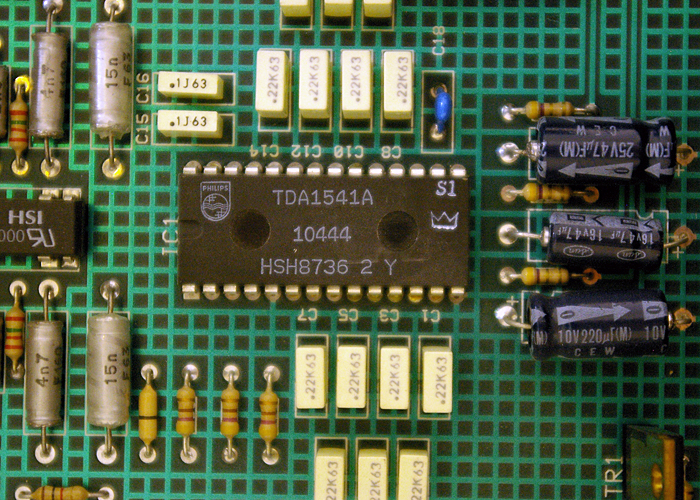

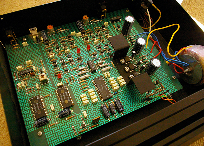

Looking at pictures of it internally it looks very tasty.
It also looks as if you could mod the hell out of it and take it sonically to well beyond your expectations and even beyond the capabilities of the dacs you are looking at or even discussing.
It's got only one transformer powering the whole thing and the caps look wide open for an upgrade or at very least a change.
So much potential it's eye watering particularly in the power supply dept.
and not an NE5532 to be seen...hahaha ( what a load of cr.. )
If you do manage to sell it on PFM for the asking price I think your going to take one large step backwards and regret it.
Get your soldering iron out, spend a little and gain a lot
Oh...and Sonic...don't tell us what we can't say - we are all entitled to opinions....just like you
I've just given mine.

^^ Just read your post - well spotted there Andrew and nice find on the pics! Yes it's quite a beauty internally, all credit due to Martin Grindrod who is an excellent designer in my opinion.
I've never taken a soldering iron to anything before but no doubt it would be quite easy to mod given some practice - everything is well spaced out and easy to work with. I've often thought it's due for some kind of recap considering it's got to be 21 years old now.

Suggest for your change you set about upgrading your TDA with I2S attenuators and DEM reclocking rather than buying a whole new 'modern' DAC 🙂
<edit> Oh and do away with that dreadful toroid 😛
Oh good....it's not just me then 😀
Never seen a better one so well prepared and ready.
...and to abraxalito...what would you suggest to replace the dreadful toroid - a screened and potted type ?
That answer could be a good tip for me too - hope your still reading this😉
Screening on a transformer is a mixed blessing so I reckon it might not be worth the money. Depends if you have a nice clean earth, in which case its a good idea. Trouble is - these days most people's earths (I imagine they're just like mine) are polluted with the plethora of SMPSUs they have around the place. Potting is optional - if it were me, I'd not put my money there.
No what I was thinking was a transformer that gives better isolation from mains-borne crud, by dint of lower interwinding capacitance. So R-core or traditional E-I core would work fine. Add on a wide-band mains filter to improve matters further 🙂

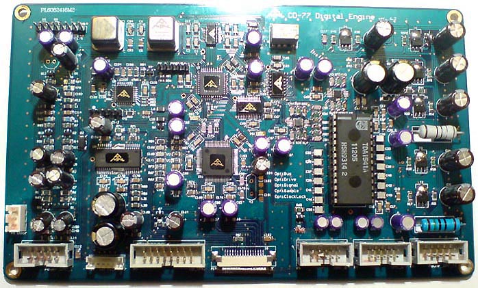

several music lovers tell me, that under certainly conditions the vintage DAC IC TDA1541 outperform each currently available modern DAC ic.
Unfortunately nobody can exact verify this claim.
OTOH, there are companies, that uses the TDA1541 in their currently CD player devices - go to
The AMR CD 77...A Multi-Bit TDA 1541 comparison - The Art of Sound Forum and the attached jpg file
