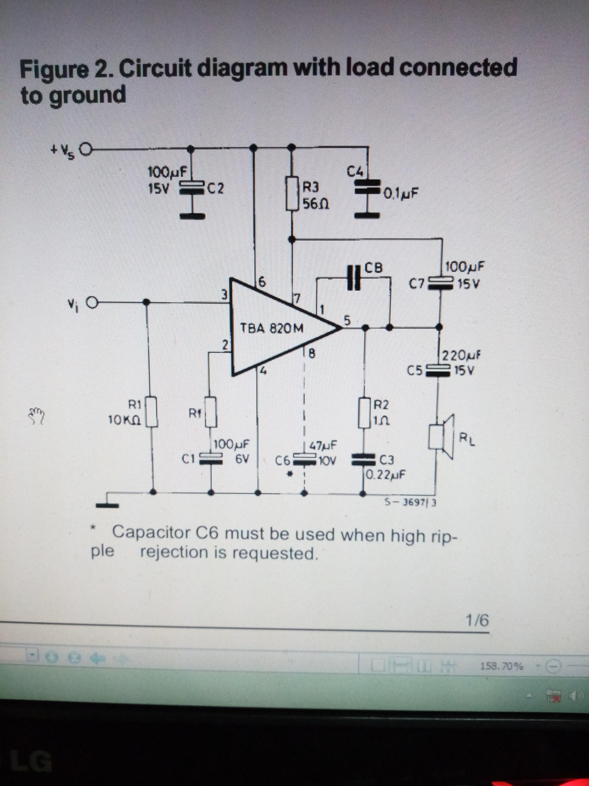

Hi all!!!
I'm posting after a long time and again I have a query with me. I had made many audio amps using chips coz I just love making it!

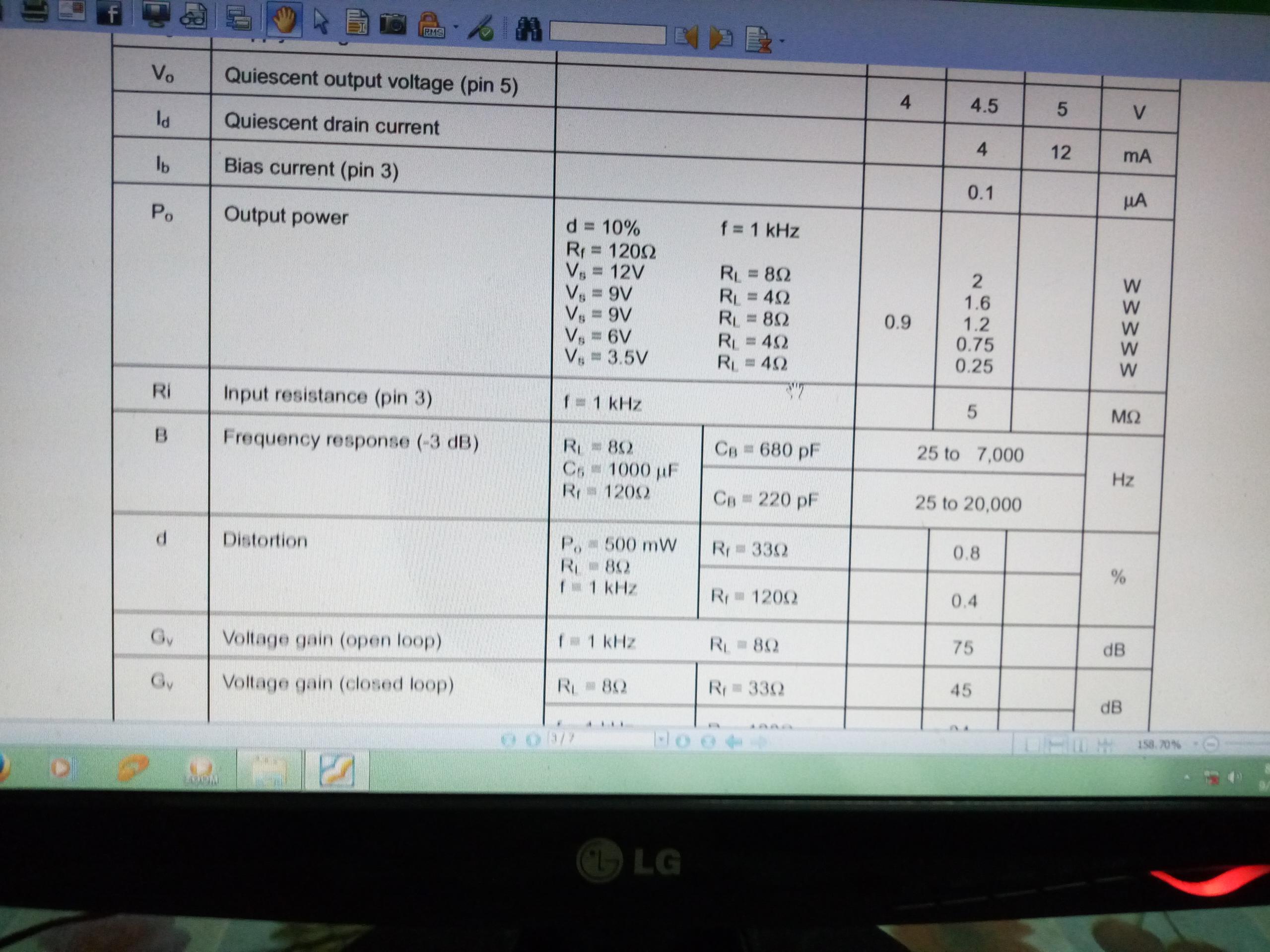

But I have a query bothering me that why the circuits of amps in the datasheets have a resistor connected across the Input pins of the ICs and Ground ? What's their function ?
Another thing I want to know that what's the INPUT IMPEDANCE term mentioned in all chip amps' datasheets ? Is it related to the resistor connected across the Input pin and ground as in the diagram or something else ?

Hi Arnivan,
Input pins of a chip-amp have a (very small) current going from or to the input pin. The input DC offset voltage is this input current times the DC impedance the input sees externally (+ some bias differences in the input stage).
If you had no such DC impedance (often a resistor) but only looked into a DC separating capacitor with a very high DC impedance, the offset voltage at the input would be very high. Some car amplifier chips actually have this input current compensating impedance integrated in the chip such that only a capacitor is needed at the input (for simplicity).
Further, such a resistor simply ties the amplifier input to signal ground when you have no input source.
An amplifier chip input impedance (data-sheet) is the (equivalent) input impedance of the chip on its own. When you put an external resistor to signal ground, the external resistor and the amplifier input impedance are connected in parallel. You can then estimate the resulting impedance.

...why ... a resistor connected across the Input....
....what's the INPUT IMPEDANCE term mentioned in all chip amps' datasheets....
The naked input of the chip can float to ANY DC voltage. In most cases, we have to force it to halfway between the supply rails; in this one it must be forced "near ground". (There are internal 12k and 6k resistors which then force the halfway voltage.)
This external "bias" resistor has "bias current" in it, which causes a voltage drop. The TYPical 0.1uA bias current times 10,000 makes a 1mV (0.001V) drop, which is "small" for our purposes.
Input Impedance is not on "all" datasheets. This is the naked impedance at the audio input. This chip states "5Meg". So if the external bias resistor is 10k, the effective total is 9.980k. Which is all the same for our purposes.

But, if a 10K resistor is connected in series with the Input pin then what's the result ?
That depends on to what the other end of the 10K is connected. Typically, it is connected to signal ground and the input is "tied" to signal ground.
Sometime a resistor is connected between an IC input and the signal source in order to bias-current compensate for the resistance seen at the other IC input.
