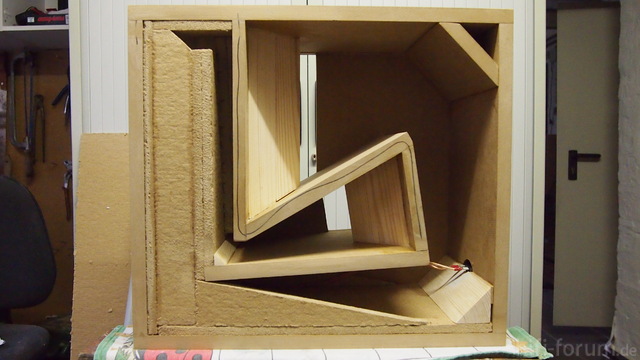

Not saying anything against the Tang Band, but have you looked into Mark Audio drivers? I've built a few different speakers with Mark Audio drivers and have yet to be disappointed.
My current favorite is a Mark Audio Alpair 7 in a Fruge-horn. Simply amazing and far more bass than you would ever expect from a four inch driver. I use mine in a room similar to what you describe and it easily fills the room with outstanding sound. There are plenty of other builds that will give you sound quality that will simply amaze.

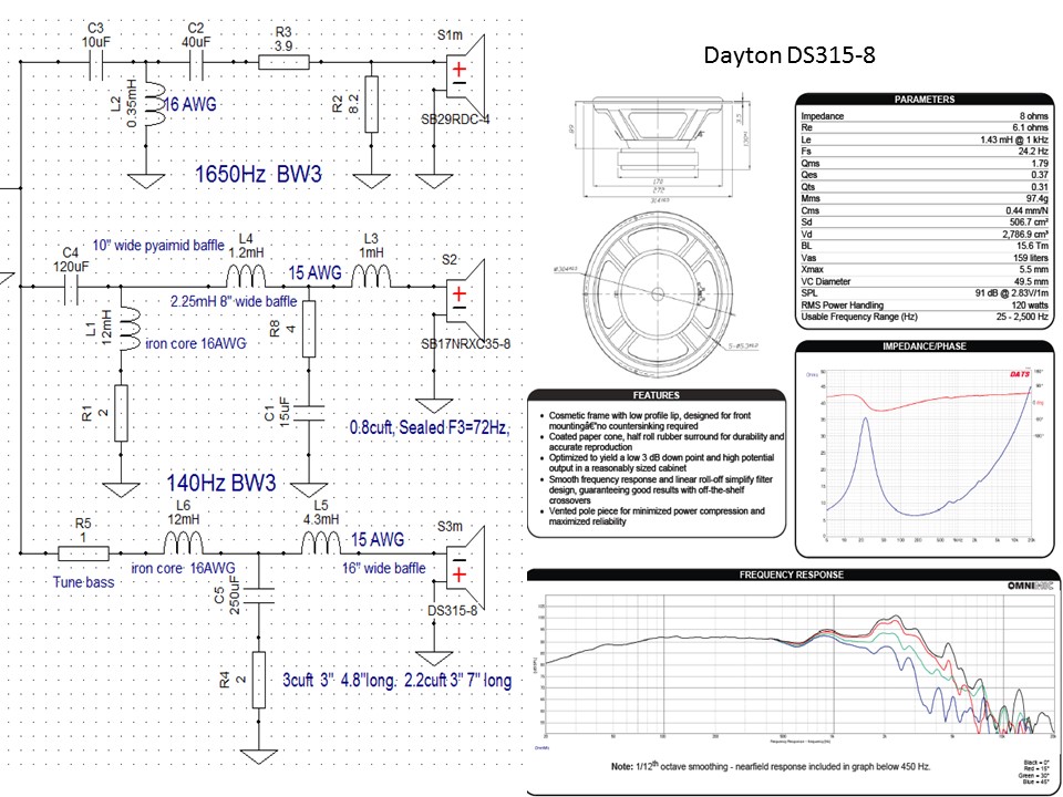

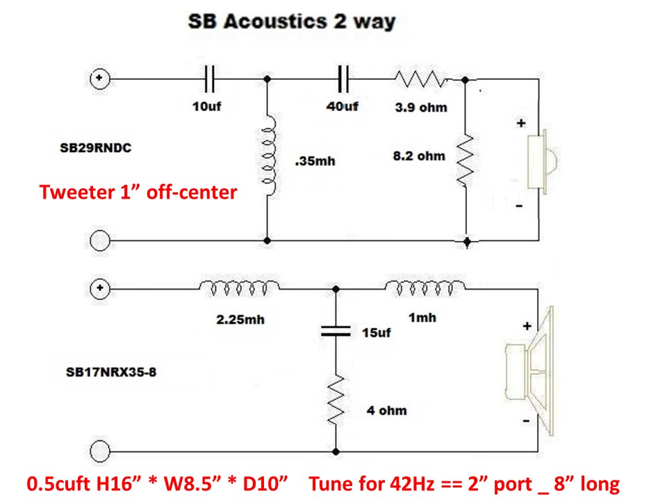

For HT, you could also consider 3-way Left+Right, plus 2-way ported (42Hz) Center. Similar 2-way or 3-way rear channels can be added later. You will find several proven 2 and 3 way designs using the SB Acoustics 29RDC-4 tweeter and SB17NRXC35-8 midrange, with either 8" SB23NRX45-8 woofer or low cost 12" Dayton DS315S-8 woofer. One proven design from Parts Express Tech forum uses common 8.5" wide cabinets. There are 3-way designs with both front and side woofer mounting.
Good quality recordings maintain stereo bass phase effects down to 20Hz. Expert listeners favor stereo woofers.

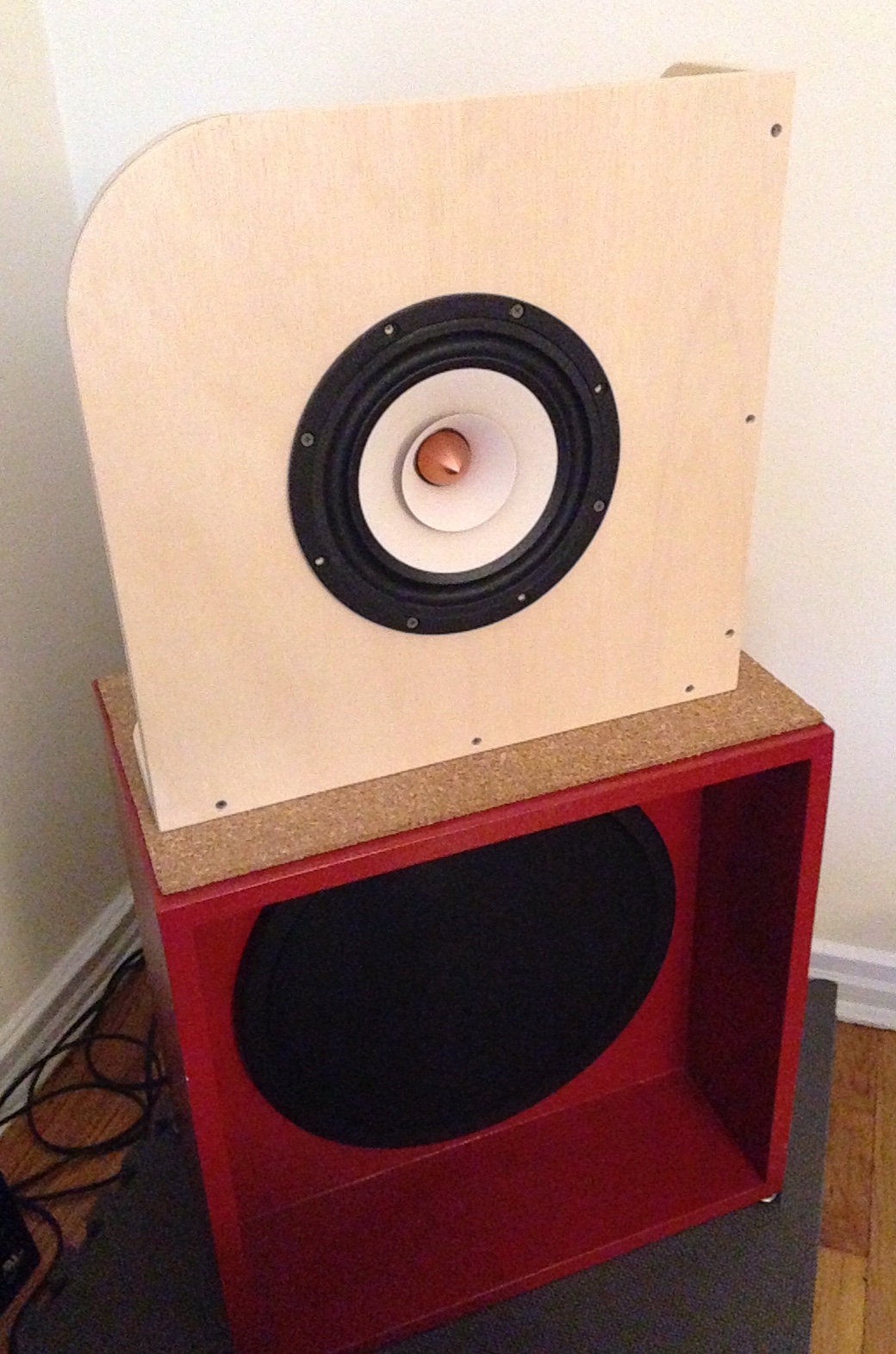

This is what I did with my TB 1808.
Thx Godzilla, how does determine the size of that baffle? Does it even matter?

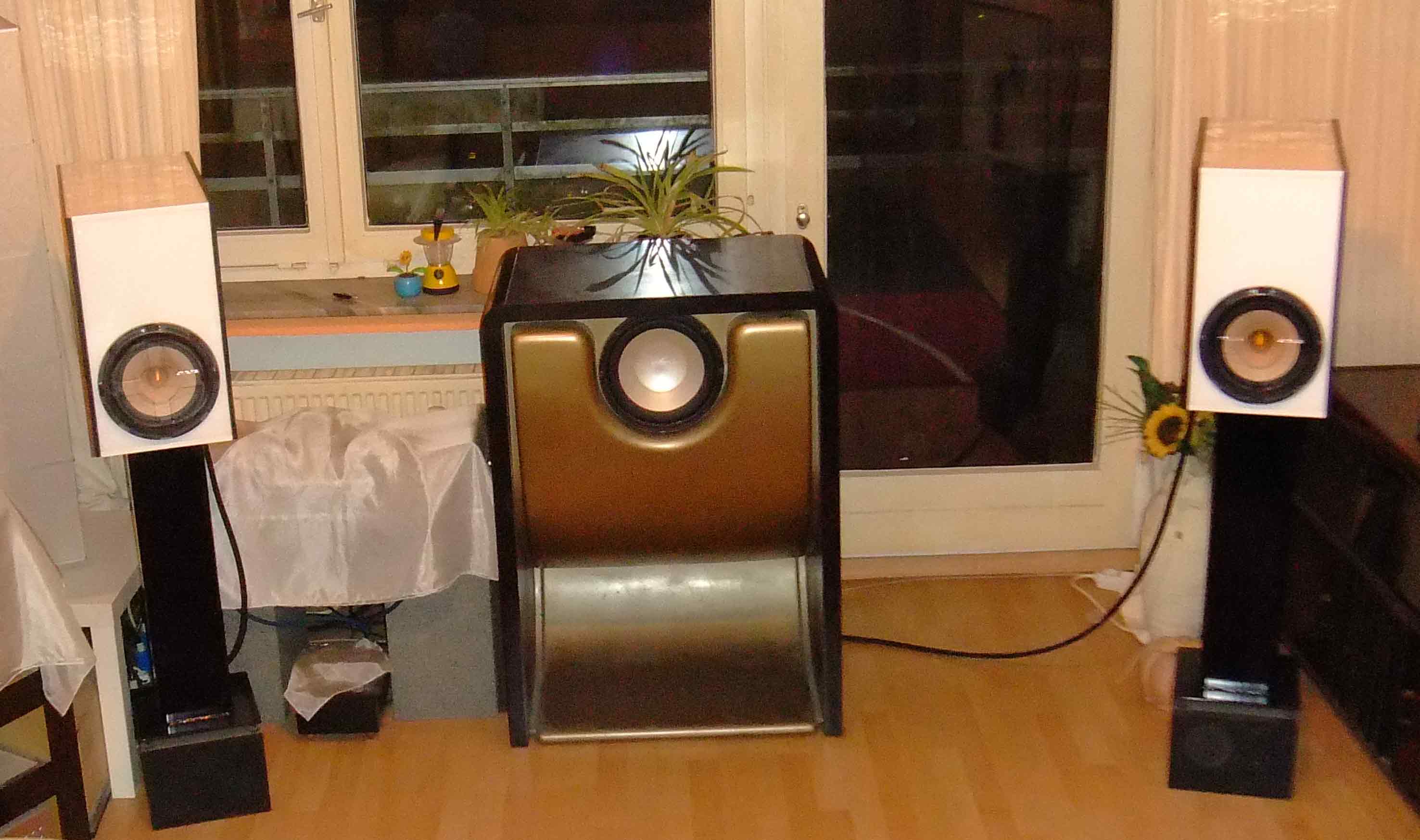

schalmei with TB 1772 8"
take better the TB 1772 and use the Schalmei, no crossover, down 90 Hz.
Schalmei-Sat
Schalmei-Sat
