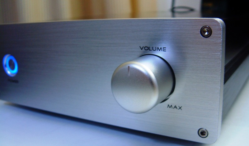

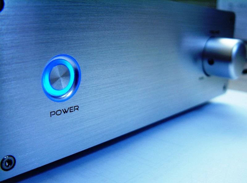

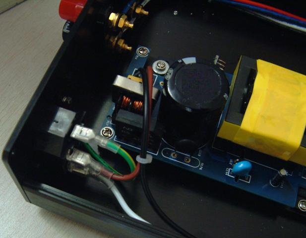

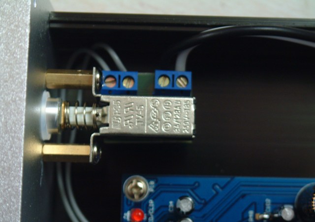

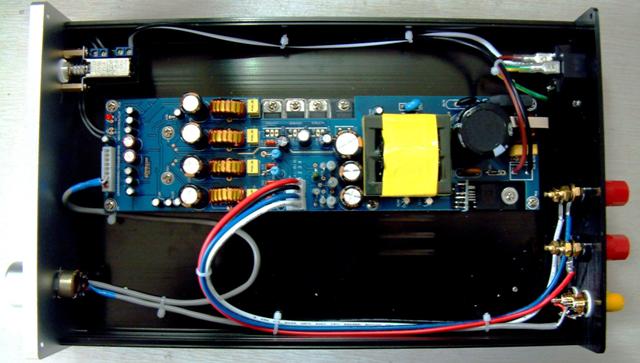

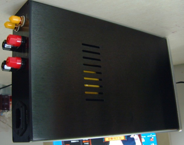

We finally finished cased TAS5630 AMP,I use it drive my wooden boxes and enjoying CCTV Spring Festival Gala Evening from 1:00pm to now.
At this time!
Swirl of the auspicious snow, Fireworks all over the sky,Firecrackers lighting the room.New Year Coming!Happy New Year!
Sound excellent,this board is the fifth version of TAS5630,special for some paramter,20Z copper,Immersion au,blue silk.high current deliver out ,I just set output up to 30V/4ohm/0.5%THD one channel.dynamic range bigger.due to big power density,we call it Genius300.
We use TAS5630PHD in this board,Because Ti engineer tell me DKD expensive than PHD not for performance due to DKD heatsink material more expensive.I think I can save more money for our friends.

could you please give the schematic for the smps? i've built one with a lineair power supply but it weighs a ton..
Yes,It can be set as mono amp,It can deliver out 300W power/4ohm/0.5%THD,you can chang jump by PBTL mode.

If any friend like SMPS as this,please tell us and we can send some schematic for you,
the reference schematic only.

authlxl, can give me the link u bought this case? i manage to found one from taobao, but the seller said it's out of stock 🙁
I have list this module on ebay ,GENIUS 300 TAS5630 CLASS D AMP - eBay (item 330408770277 end time Mar-07-10 21:23:49 PST)
