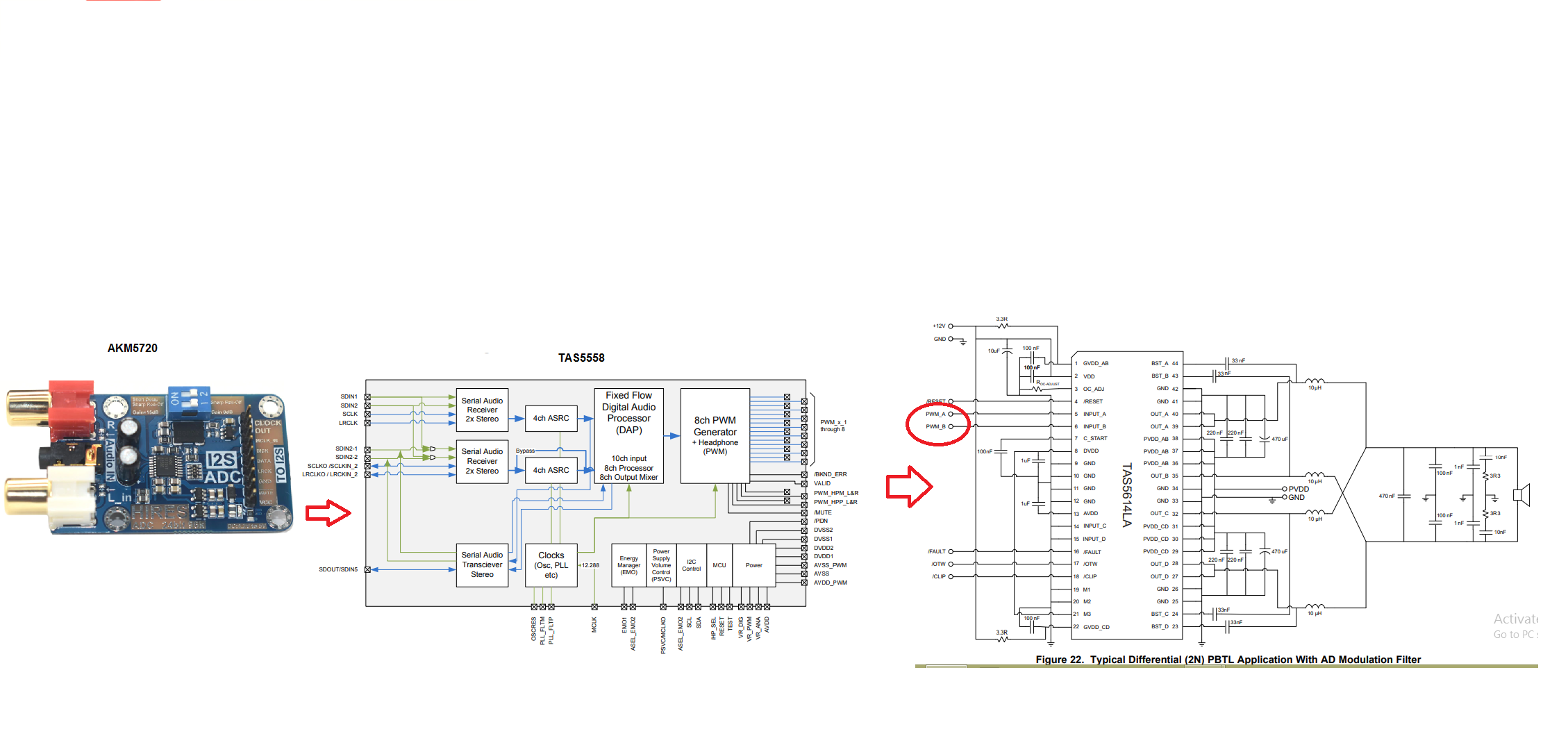

J Joseph1 Member Joined 2012 2020-08-10 12:29 pm #1 2020-08-10 12:29 pm #1 I want to send audio signals (RCA Line out) to TA S5614LA AMP chip.But this amps signal IN supports only PWM signal (which I never used). Is this below method ok?Never used TAS5558 chip as well. Attachments TAS5558.png 357.9 KB · Views: 140 drMordor Member Joined 2019 2020-08-10 1:51 pm #2 2020-08-10 1:51 pm #2 Need additional microcontroller control for TAS5558 You must log in or register to reply here.
