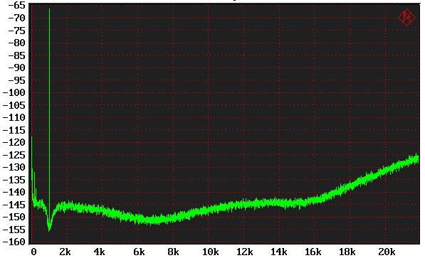

By all accounts the TI5015 is a very good sounding modulator – with the best 19 & 20KHz IMD I’ve measured to date – better then -115dB (18 & 21 KHz), this is also better then any linear amplifier I’ve measured.
Dynamic range -115.9dB non Awtd, however the in band noise floor shows the effects of the “Poles & Zeros” of the noise shaper – see 1W FFT plot below.
You could also look at the Renesas M65818AFP; the great advantage of this device is its inbuilt ASRC. With the earlier device the M65817AFP I achieved a dynamic range just shy of -120dB. However its 19 & 20 KHz performance was not as good as the TI at about -95dB. It also operates the output stage at around 768 KHz – better from an EMC perspective, but places greater demands on the output stage
