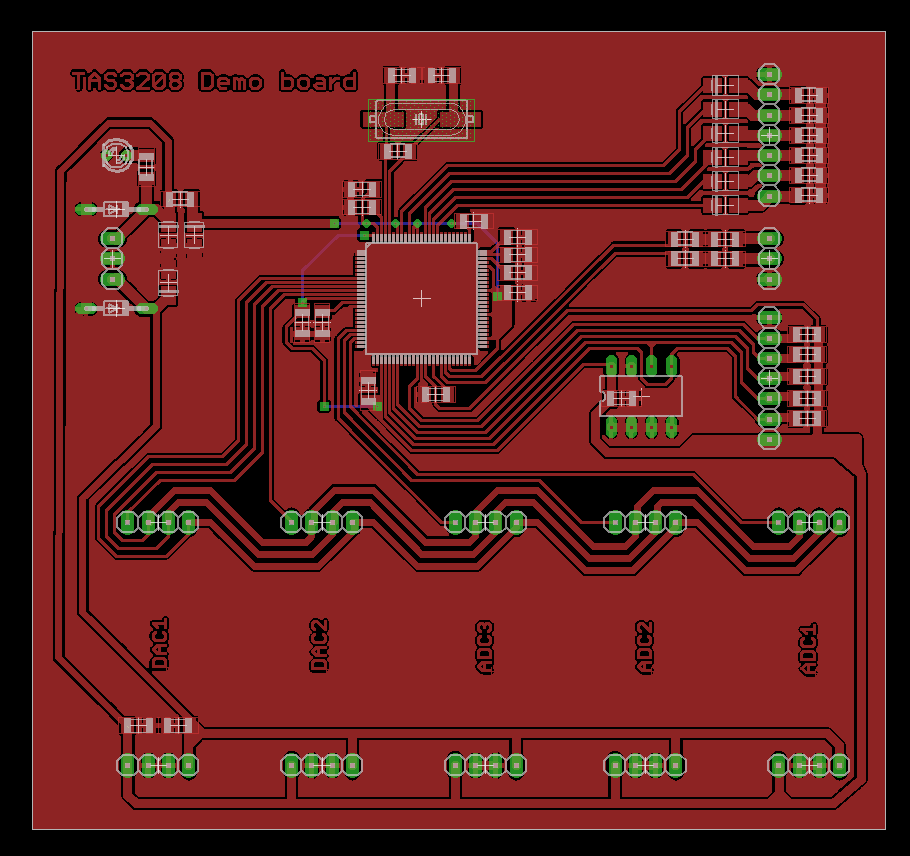

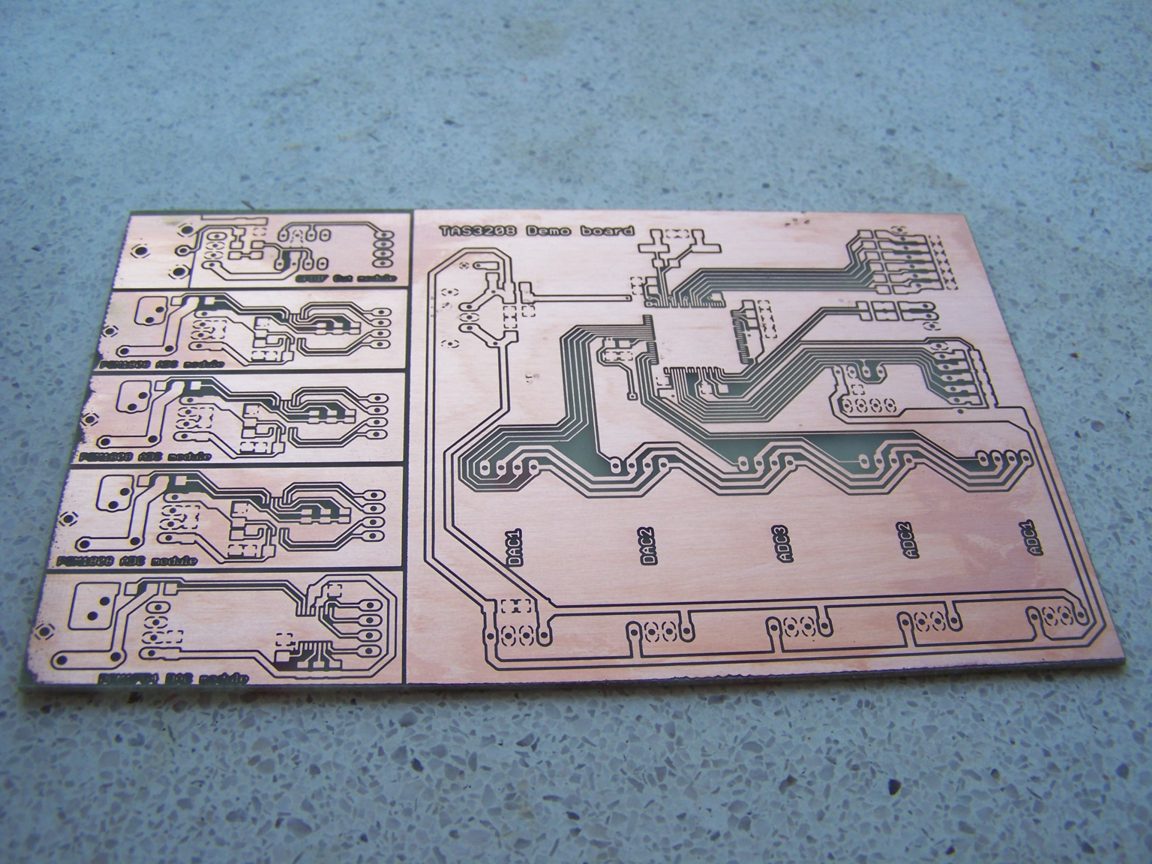

I have finished the schematic drawing for the board.
The analog ports of the chip are routed to pin headers for various connection.
As for the digital audio pins they are routed on to "sockets" of headers to accommodate tiny boards congaing a DAC or ADC. There is also a socket for a EEPROM that stores the DSP program.
The board can actually be used as a crossover or something as it can work standalone from a single 3.3V supply
So do you guys see anything done wrong or in need of improvement ?
Well the control connector basically gives access to the I2C port on the DSP and to the I2C EEPROM for loading a new program. I plan to connect that to a simple PIC16F and connect that to PC with RS232 so i can pass I2C commands and program the EEPROM from there. The DSP can run without anything on that connector as the DSP reads from the EEPROM by it self after power on. But you cant change any settings during runtime.
In all I2C commands are very simple.Each setting for a function block can be assigned a I2C address so simply send a I2C write command to that address.(For example the volume slider of an attenuation block or slider of a EQ etc)
In the final application it will be connected to a dsPIC30F and have the ADCs and DACs on the same board rather than on sockets.It will also get digital pots for volume control.
Analog inputs / outputs are not used?
Then how about TAS3108, 38 pin TSSOP package?
(SDIN1-4, SDout1-4 only)
All available analog I/O is used. 2ch ADC and 6ch DAC .The TAS3208 dose NOT have 10 analog inputs as it apears from the pins.It has only 1 stereo ADC with a 10:1 MUX ! (I would love it if those ware independent ADCs)
