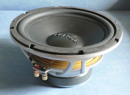

they're great actually.. i've used 4 of them (x150dvc)..i was asking about targa because here in cebu, thats the only sub with the highest reliability (physically) & power thats locally available..& it just can't take the punishment from my bridged power amp (56V per rail)..
in my free air test,you can hear its voice coil bumping against the magnet with power applied less than 500W..even smoked @55Vrms..🙁
i'd be glad if there would be a sub far better than this one that can be availed locally...
longthrow said:in my free air test,you can hear its voice coil bumping against the magnet with power applied less than 500W..even smoked @55Vrms..🙁
there's your problem. those subs are designed to be used in boxes. actually, any sub used in free air will not handle anywhere near its rated power handling.

You could always increase the power handling dramatically by using 4 drivers in a series - parallel arrangement.... huge box though. Try and blow that up. 😉
I have an X-120i in a car sub, seems quite good for the money. Would love to get the T/S specs for it though...

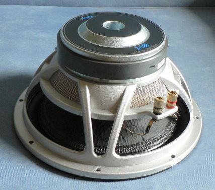

Thanks heaps for that Rabbitz. I have those numbers, but the i model is significantly different to the non i version, at least in looks(going on the wes catalog).
The X-100 I got from them looked nothing like the catalogue either and was silver instead of black. I used their parameters and seemed to work fine.

I'd say the parameters are for the older woofers as they are the same in the 2005 and 2007 catalogues and the SPL and impedance is different on the box for the woofer I have.
Here's what I have on the woofers.
X-100
Z=4R6
Fs=36.4Hz
SPL=88dB
Qms=2.66
Qes=0.56
Qts=0.47
Vas=45 litres
X-150
Z=3R9
Fs=29.5Hz
SPL=87dB
Qms=4.33
Qes=1.16
Qts=0.92
Vas=159 litres
I did find them on the DAI-1CHI site once but never able to locate them again.
X-100
Z=4R6
Fs=36.4Hz
SPL=88dB
Qms=2.66
Qes=0.56
Qts=0.47
Vas=45 litres
X-150
Z=3R9
Fs=29.5Hz
SPL=87dB
Qms=4.33
Qes=1.16
Qts=0.92
Vas=159 litres
