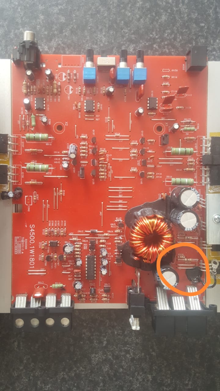

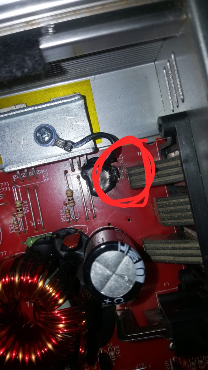

S shanecapetown Member Joined 2019 2020-02-02 1:53 pm #1 2020-02-02 1:53 pm #1 Hi guys does anyone have a schematic or can tell me what part goes here Attachments IMG-20200202-WA0006.jpg 118.5 KB · Views: 88 IMG-20200202-WA0004.jpg 112.7 KB · Views: 88 P Perry Babin Member Joined 2003 bcae1.com 2020-02-02 2:19 pm #2 2020-02-02 2:19 pm #2 If it only connects the heatsink to ground, it's not critical. A 0.1uF will work. S shanecapetown Member Joined 2019 2020-02-02 2:22 pm #3 2020-02-02 2:22 pm #3 Ok thank u perry You must log in or register to reply here. Share: Facebook X (Twitter) LinkedIn Reddit Pinterest Tumblr WhatsApp Email Link
